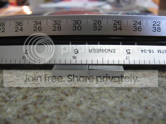

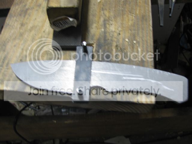

First up was a file guide, I have no pictures from the making so I will attempt to use my rather poor writing to explain what I did. First, I sawed out two roughly 1/2" x 3" rectangles.
After that, I glued the two pieces front to back with liquid nails, why liquid nails you ask? Because it was what I had on hand, and it is easily dissolved in WD-40. I then filed, filed, and filed some more until they were even. After that I drilled a #21 hole 1/4" from each end in one of the pieces and #6 holes in the other.
I then tapped the #21 holes with a 10-42 tap, and countersunk the #6 holes. After cleaning the glue off I heated them to critical and dunked them in Mcmaster-Carr 11 second oil.

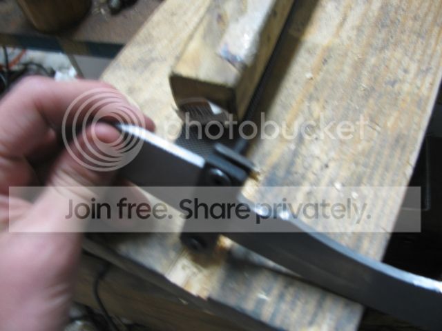

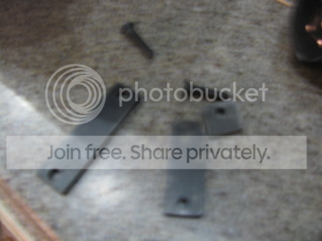

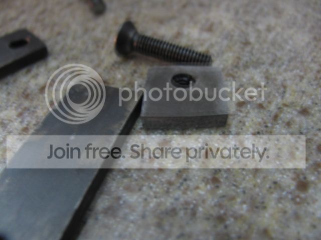

Here is where I made my first mistake... I decided that since I was going to be filing up against it that it should be left at full hard. :hopelessness:
Here it is before....
...and after I decided to do an impromptu grain refinement test. (that's my story and I'm sticking to it)
All that is to say... when you make a file guide, TEMPER IT!
