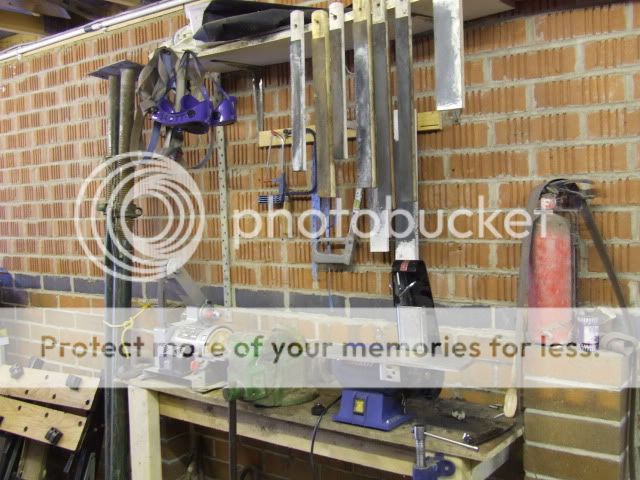

What do you use for a grinder? I do NOT miss the days of having a 1x30, let me tell you!
Christof no i didnt triple temper,do notice the difference.
heres the grinder im using now the little blue one:(
and heres one iv made 2x72 just need motor and pulleys or variable speed
set up. what do you recommend.hope were not boring everyone:grumpy:
nice job on the grinder!
Honestly, if it's a matter of getting it up and running fast, a 1HP single speed will do the job! but a VFD and a 1.5 horse will make things so much sweeter.
