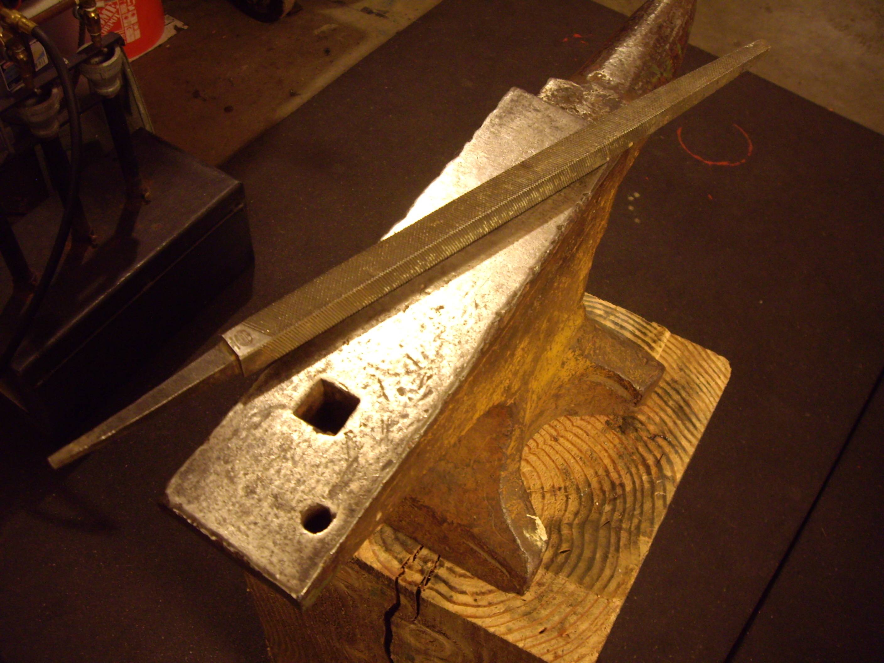

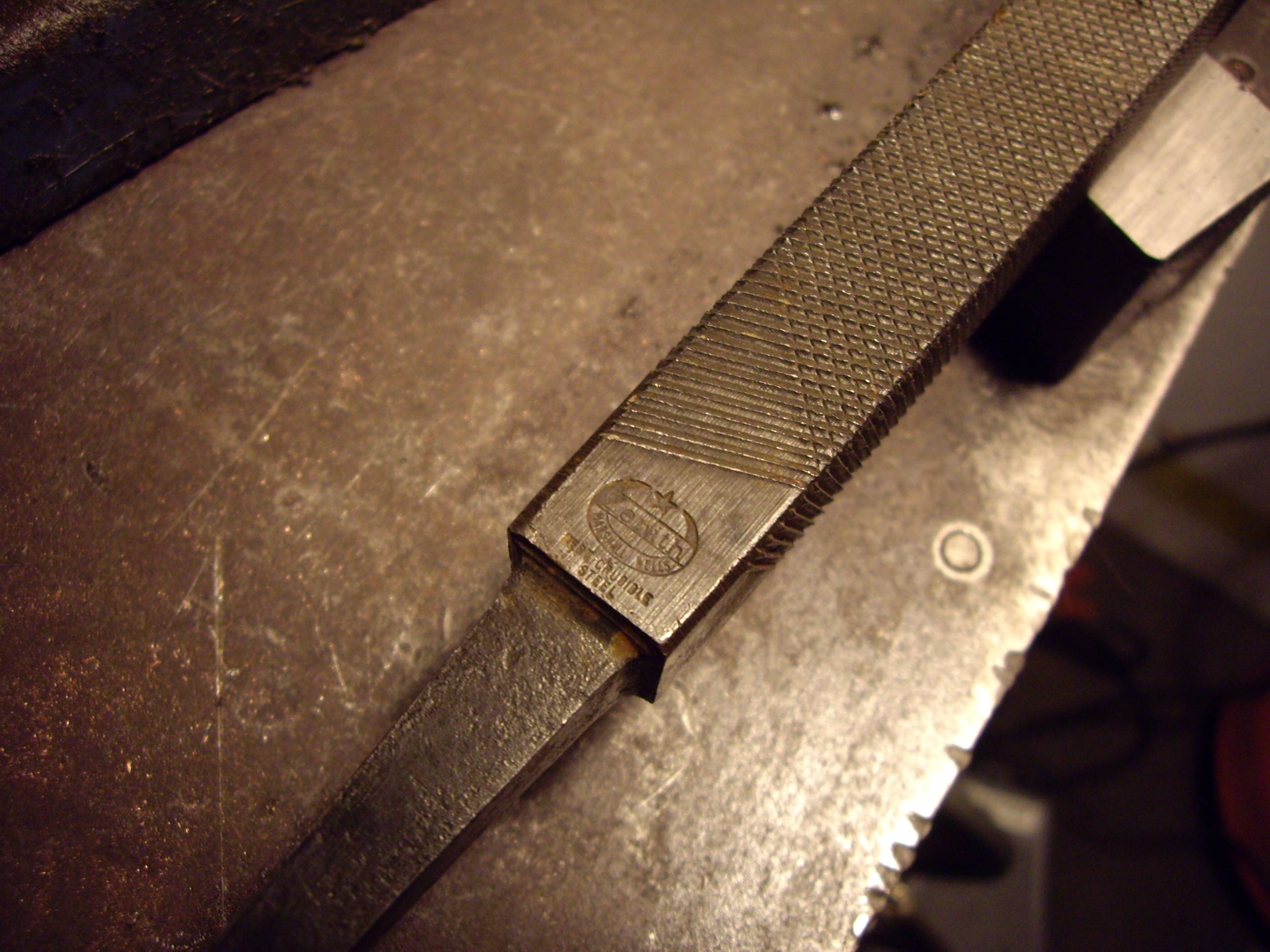

I have a giant file that would like to be forged into rapier of sorts. The thing is almost two feet long, and 3/4" diameter square stock with a distal taper, just begging to become a small sword. The marking says "Zenith" or "Star Zenith," "Marshall Wells," and "Best Crucible Steel."
Although I couldn't find much information online, it seems that the same steel may have been used for knives in the past. The file was likely made in the early 1900s. One interesting piece of information is from the Zknives.com steel comparison chart, but not sure if it's the same origin:
http://zknives.com/knives/steels/star-zenith.shtml
It refers to extremely high tungsten tool steel, about 18%, with references dating back to the roaring 20s era and earlier.
Any info about this type of steel, it's history, or the forging of high-tungsten steel would be much appreciated! :)
Here are pics of the file:
So, it's basically T1 high speed steel... although why a file would be made from that is beyond me. Maybe it was meant for use at the lathe?
If that stuff does indeed have 18% tungsten, then it will be quite red-hard and very difficult to forge. It will be extremely wear resistant to grind, and require fairly complex heat treatment with austenitization occurring at what are normally forge welding temps.
I'd leave it as a big, super cool old file, and use it for stuff if it was me...
Sounds like good advice. :]
Should it get forged out, the plan was to preserve the original manufacturer's marks and leave that area as a square ricasso, and use a small forging press for the bulk of the forging work, followed by a pro heat treatment out-of-house. There's plenty of other blades to be made though, no reason to wantonly ruin a large and strange file!
You might be assuming too much . First do a spark test ,that will tell a lot with tungsten. You will get few "stars" in the spark shower and they will be a deep orange . A very high tungsten steel to me doesn't seem to be an appropriate choice for a file. Total length ? Let me know about the spark test then I'll investigate further.
Spark test is consistent with high-carbon steel, yellow with many forks; there is no indication of tungsten. So much for that idea!

Mecha, having it sent out for HT would be the right thing to do, although now that it seems that the actual alloy type is likely unknown, it would be hard to know what to tell the HT provider.

I am a file fanatic, and love that file you posted a pic of, Mecha. I would like to see that file kept and used as a file. I get the hankering for making a knife/sword from something you scrounged up, or grandad's old files, etc. But I highly recommend that a different KNOWN steel be used to make your sword. Not saying this wouldn't turn out well, just that I would keep that dude and go with a different route if I wanted a short sword or what have you. Not trying to discourage you in this regard at all, tho.
No worries tool fanatics, the giant file will be left intact!
I assumed it was just high-carbon steel, but then found references to the high-tungsten steel, and figured that if it was possibly true, it might be worth getting it analyzed along with a few pieces of titanium that I must send out. File knives, ok....but a file sword? Just a muse. :D
