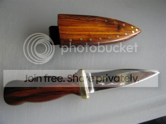

I made this from a old bastard file, first knife I ever tried. I used a bench grinder, a 1 inch belt sander and regular sandpaper and elbow grease. It just takes a while without better tools. You just have to go slow and be careful.
By the way, your knife looks incredible! Especially for your first knife. I can tell that you must have spent a lot of time learning and reading before you took this on. I have read 2 books and spent countless hours studying about steels, alloys and bladesmithing before I felt confident enough to take on my project.
