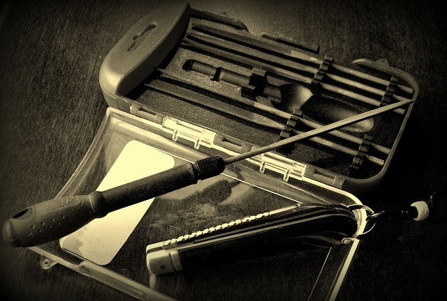

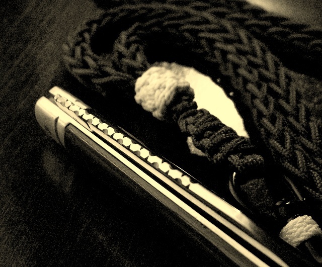

I bought a needle file set at wallyworld to give filework a try, and used an inexpensive beater knife to practice with, since I wouldn't worry about making any mistakes on it. I held the closed knife in one hand and the file in the other, and worked on the back edge of the blade where I'd used a ruler and marker at 1/8" intervals, to alternate the file pattern with triangular and round files.
A bench vise would be nice to work with and I would try harder to keep the files from jumping/wandering around as I started filing at each point. For a first try, I don't think it looks too bad, but I would definitely practice more before I would try it on one of my Spydercos... ;)
