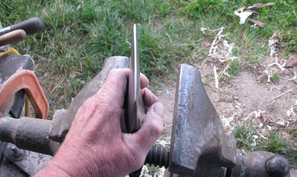

I've meant to post some video of my filing technique for some time. I finally got around to uploading some video. I think this is good technique. Much of the motion is in the legs and body.
The axe is a vintage Plumb double bit reversible. It's a true reversible with the eye measuring the same size top and bottom. A straight edge place against either end of the eye reveals a flat surface with no taper at all.

So what is the proper way to hold a hafted axe securely for filing? Leather wrap on handle and grip that in the vise? I make it work but would love to confirm the correct method.

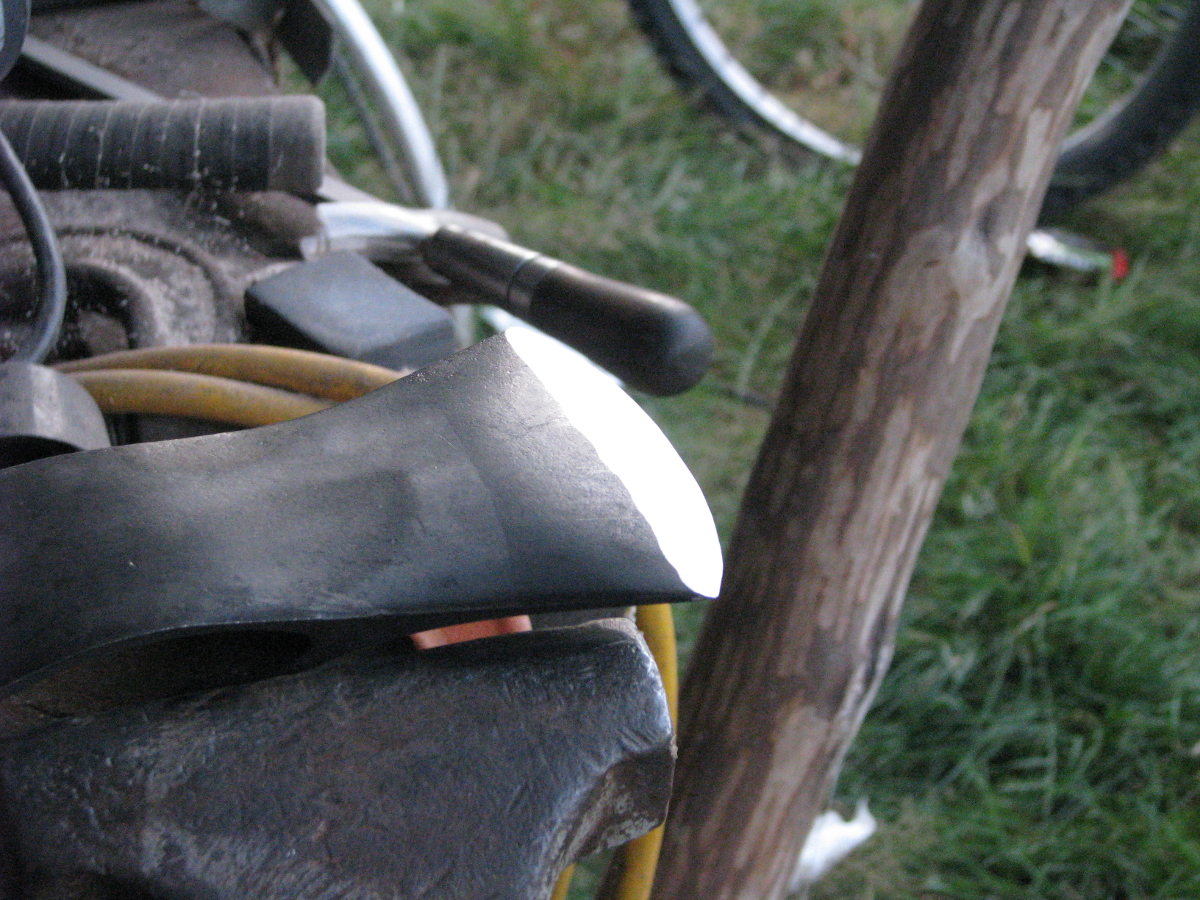

Any examples of the outcomes? - fishing for pictures :)
Half banana grind. The bit was thin enough that I didn't need to go back any further.
Before I started filing I re-shaped the bit at the grinder. I removed a chip and compensated for a slightly worn heel and toe. This left me with a bit almost 1/8" wide when I started filing. You can see in the photo that I have already started filing the left side of the bit. With good filing technique and sharp files it took me about 30 minutes for each bit. I'll spend another 20-30 minutes honing each bit.
This is a project for a friend. I'll hang it on an octagonalized TH haft.
I would clamp the haft to a high work bench with a pair of large quick-grip squeeze clamps. Put a low stop behind the poll. A scrap of leather under the haft at the contact point keeps it from sliding around. Alternately you can use C-clamps but you'll want to pad the haft with leather both to protect it and stop the clamp from sliding off.
Some single bits with substantial polls and thick eye walls can be held with the vise even after hanging.
It's really best to sharpen the axe before hanging. Infinitely easier this way.
First fit the eye to the head but don't wedge it permanent. Then shape the haft to the head, indexing any octagoning to the head. Next separate the haft and head and finish them separately. When the head is honed and the haft is finished bring the two completed components together.

Do you still mount the head in your vise like this when there is a handle in the head for filing?
A few axes can still be set in the vise even after hanging.

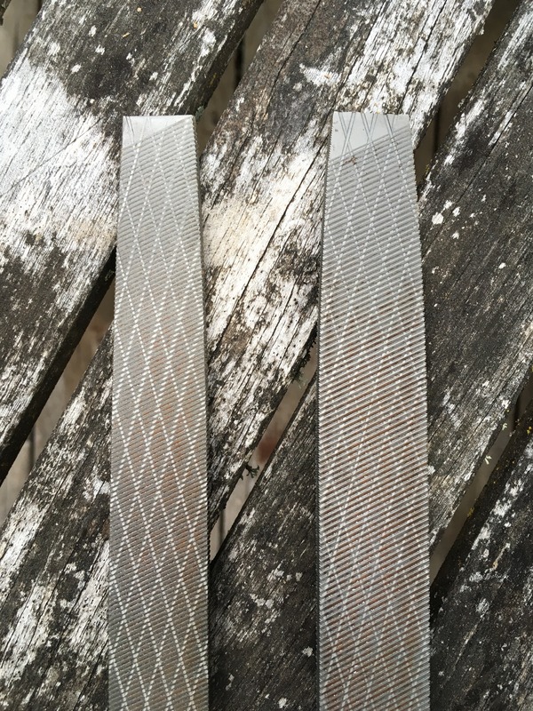

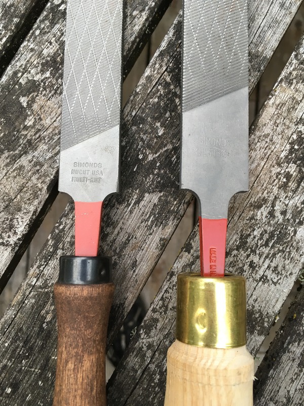

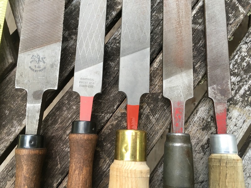

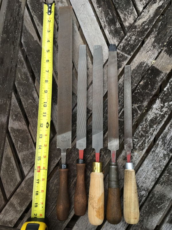

Here is a picture of the ones I am using right now:
Pferd 1-B, Simonds Nu-Kut/Multi-cuts (American and Honduran), Simonds 10” and 8” – in that order I guess. *The tape on that Simonds was to keep the end from scratching the poll of a head during a reprofile – it works actually.
The Simonds Multi-cuts are my most used. Visually, the American and Honduran made ones show differences in outright build quality but to be honest, if I pick up either I can’t tell the difference in performance when using them. They do a great job of removing material easily and it’s pretty simple to follow with a finer file to remove a lot of the marks.
Sometimes 2cents is just 2cents but decent files do make a huge difference in how enjoyable working on stuff is.
That multi-cut pattern is excellent. Fast removal without leaving too many real coarse file marks.
