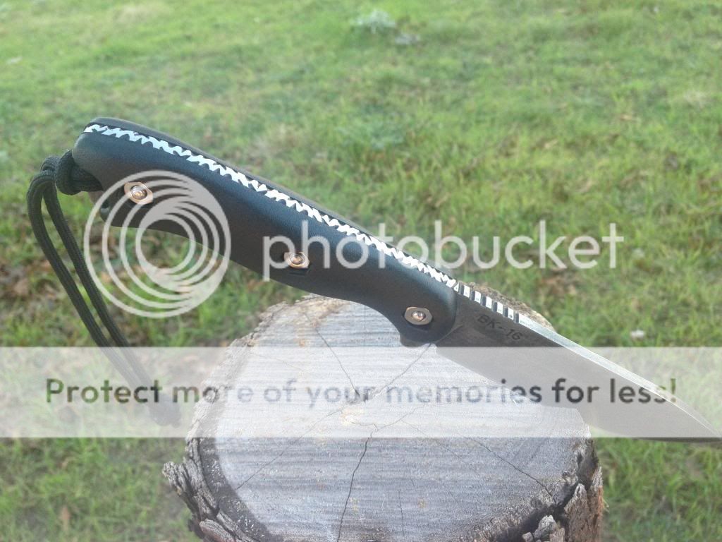

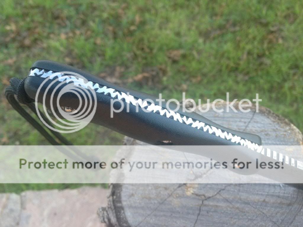

So I've been wanting to try some file work for while now and decided my FPR BK16 would be a great candidate.
I've done a few mods to her already but she still has plenty of potential for more modding!!
Dug my old set of diamond files from about 12 years ago out and got to work. They were just some cheap harbor freight ones I think.
And after filing this tempered steel, I need a new set. No joke. They all wore out now. haha. Gonna invest in some good ones to do the bottom side of the tang.
Here she is on her way to awesomeness!!
Hours later........
I then soaked her in some pcb enchant to try and darken her up a little.
Then I sanded and polished the tang. There are still a couple of grind marks I did not get out yet. When I do the underside I will clean her up all the way.
I ended up putting a little paint in the groves to make the file work stand out more.
Still have a few more things to do to her before she is complete but I wanted to share what I have done so far.
I will update and post more pics as I get more finished.
I have ka-bar micarta on the way and it should be here any day now. Might do something special with that as well, don't know yet?
She's not perfect, but for a first try I think it looks ok. I learned a lot thru this process and cant wait to do another one.
Hope y'all enjoy.

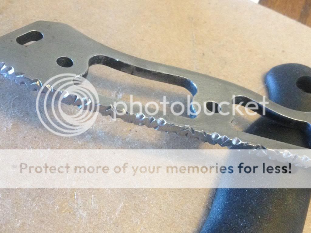

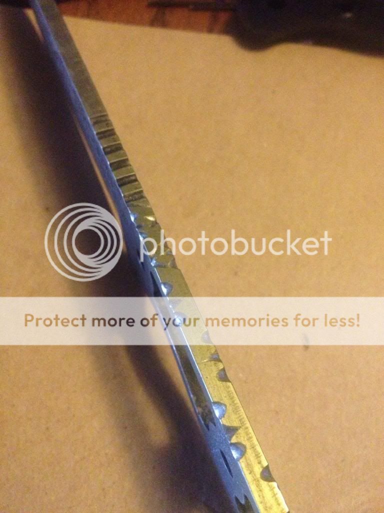

So I started filing the underside. I must say that since I got a handle for the files that it was a lot easier. I would recommend spending the 5 bucks it cost for a nice handle if your gonna do any file work with needle files. I usually just use the file by itself or put tape on the handle. Way easier and more controlled with the handle.
Here are a few pics of under the tang ..
Here she is with the main pattern complete
Now I just have to fill in the rest .
Ok, now thats all done, time to sand this baby down
And more sanding ..
I started with like 380 or something and worked up to like 2000. Then used some Micro mesh I had.

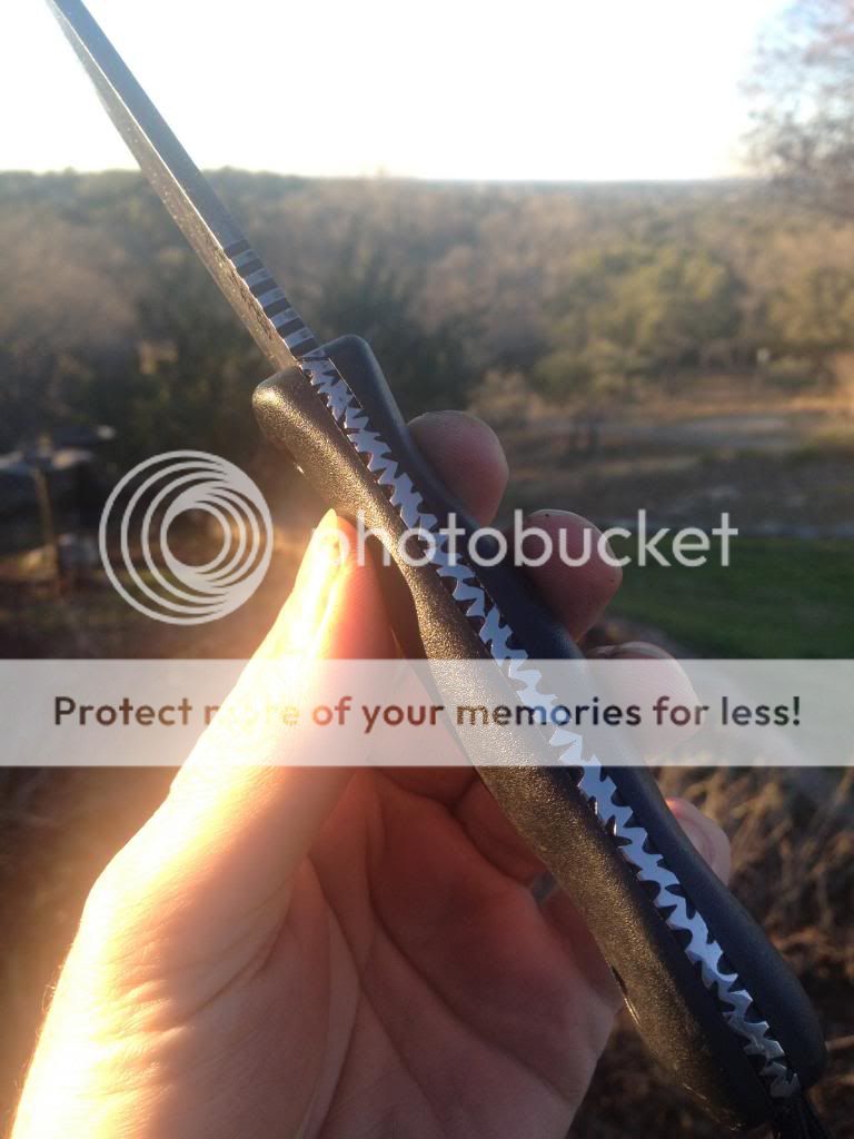

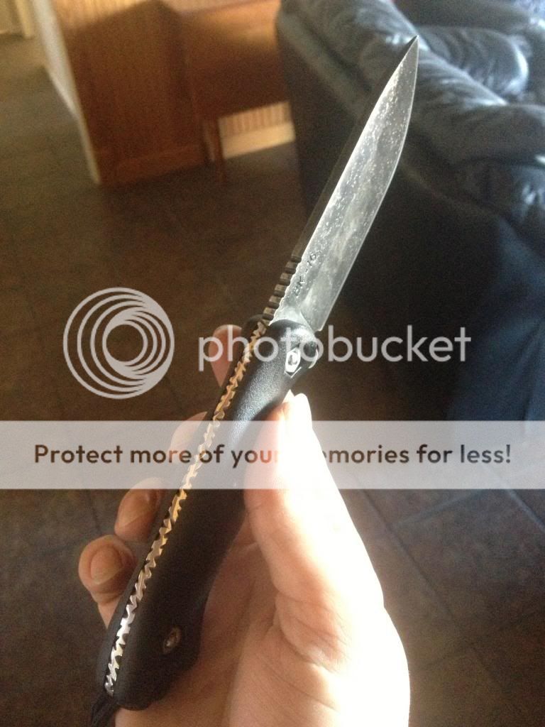

Alright, now she's all complete.
Mods so far on this blade are:
1- Stripping of the factory paint.
2- Etching with gun blue and bleach.
3- File work done on entire tang.
4- I did sharpen a spot on the back of the spine to use my fire steel and it works great.
5- New micarta handle scales that have been sanded to fit flush, smoothed out all the sharp edges, and have been dyed black.
6- And I modded the blade where it meets the handle. I did not want a full choil so I came up with something else.
I filed down the sharp part where the blade meets the tang. I also filed down the hand guard thing. ( I will explain and show why I did this later on)
I then polished it at that area on the knife so it feels like a full choil even tho I didn't really lose any cutting area.
