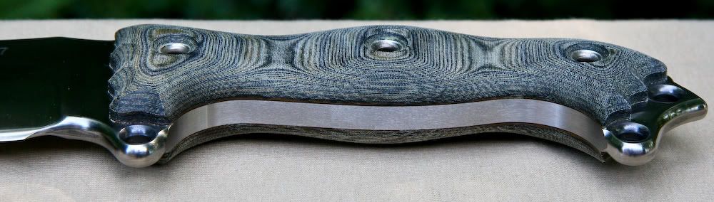

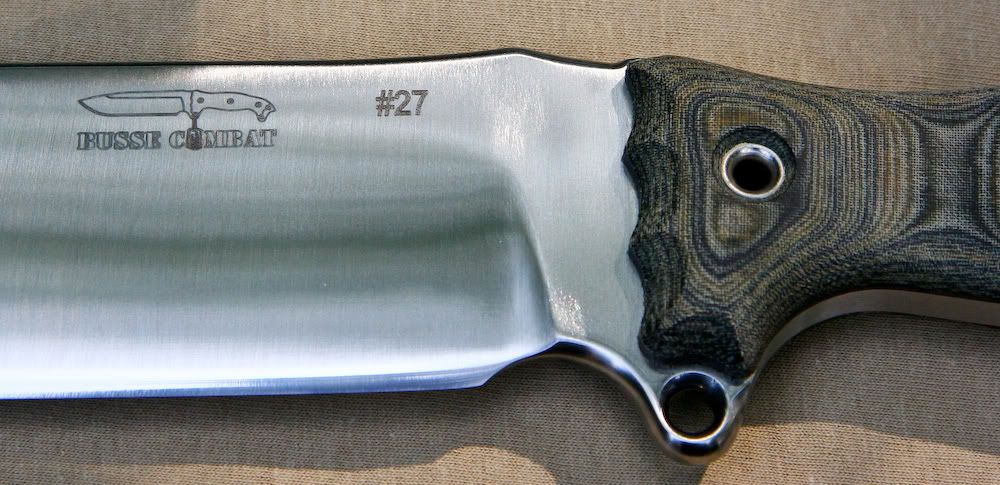

This is a 1 of 13 Nuclear Meltdown FBM (below). All the corners are rounded, as well as the spine, Talon Hole, lanyard hole(s), choil, butt, etc... The blade is fully convexed. On a normal FBM or FFBM, the spine is squared off, the choil area is perpendicular to the blade, and same with the holes unless they have been chamfered (sp?) a little.
These closeups on the handle area of a normal Nuclear Meltdown FBMLE shoes the "ball bearing" finish a little better.
