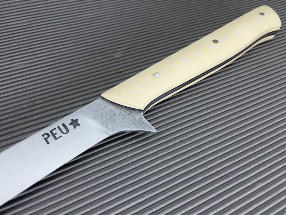

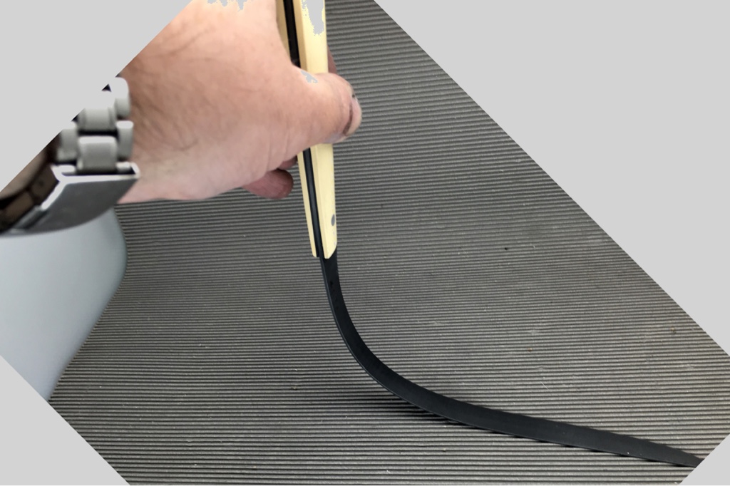

Awsome blade ! Can I see a straight pic of it? Looks like you went with 1/8 and tapered it?
I don't think the fisherman up here are "as" concerned with flex cause the fillets are so big you really don't need to much flex unless you try to remove the skin even then the fillets are so big it's probably easier then doin smaller fish :)

This is the bigest one I have made. Don't have a lot of call for big fillet knives here. It's forged from a 52100 ball bearing with cocobolo handle.
Man really nice .
What was the size of the parent bearing ?
I also want to forge but for my pleasure and keep stock removal more business :)
Also awsome job on that coco bolo .
Can I get a spine shot ?
Trying to get an idea of taper as well
