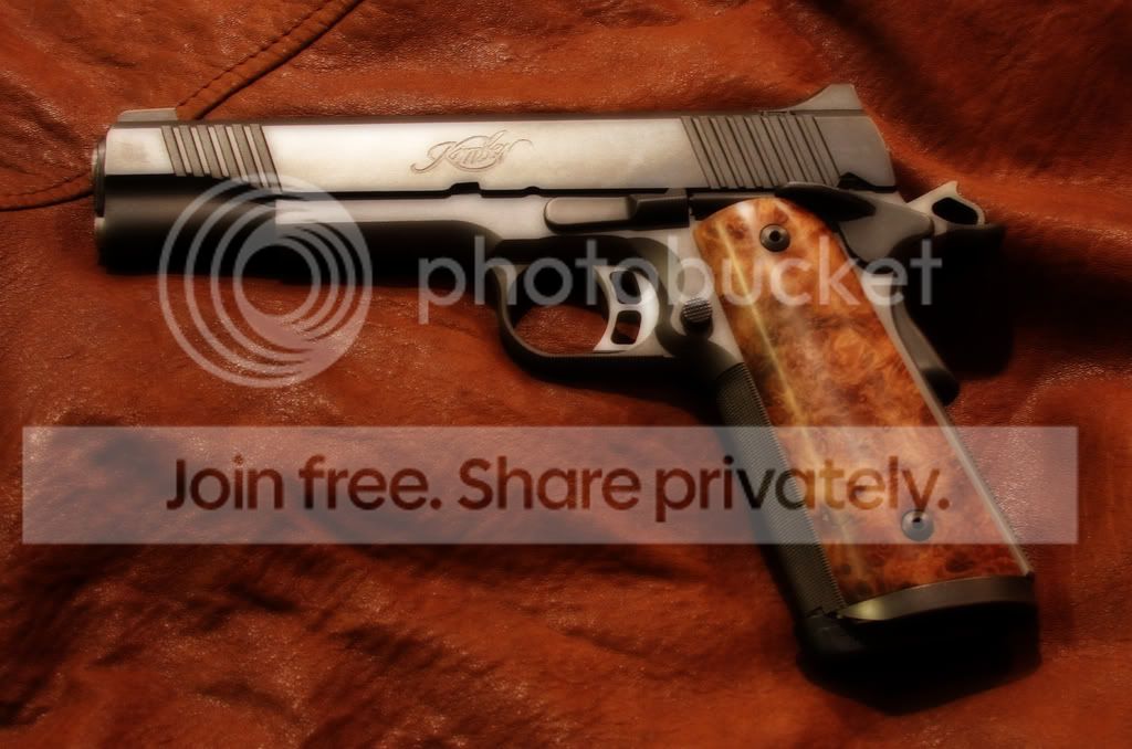

Oh, hell no. I didn't sell anything. I don't do that anymore:) But I would have maybe gotten a Krebs custom with the money otherwise. I'm getting a lot more use out of the grinder anyway, so nothing lost. Incidentally, here's my Kimber with some new grips courtesy of a nice block of stabilized wood from Pop's and the KMG. At least it can help dress up the guns I do have;) I post-processed the pic in photoshop for the "Orton" effect.
Regards,
Dave
