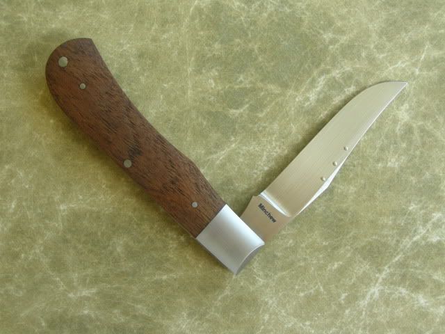

I made 4 slip joints a couple of years ago and never was happy with them. I quit making them until I could figure out how to relieve the liners which I ended up doing with my etcher and how to get a decent looking nail nick. I ended up using fine silver wire to create 3 nail pull studs. I did not put a shield in this knife, but that will be next on the others I have to do. Comments and critiques welcome as always.
cpm-154 hollow ground with swedge
half stop
fine silver studs
416 bolsters
relieved stainless steel liners
mesquite for handle (customers choice, not mine hopefully I will have some done with mammoth by the end of the week)
half stop
fine silver studs
416 bolsters
