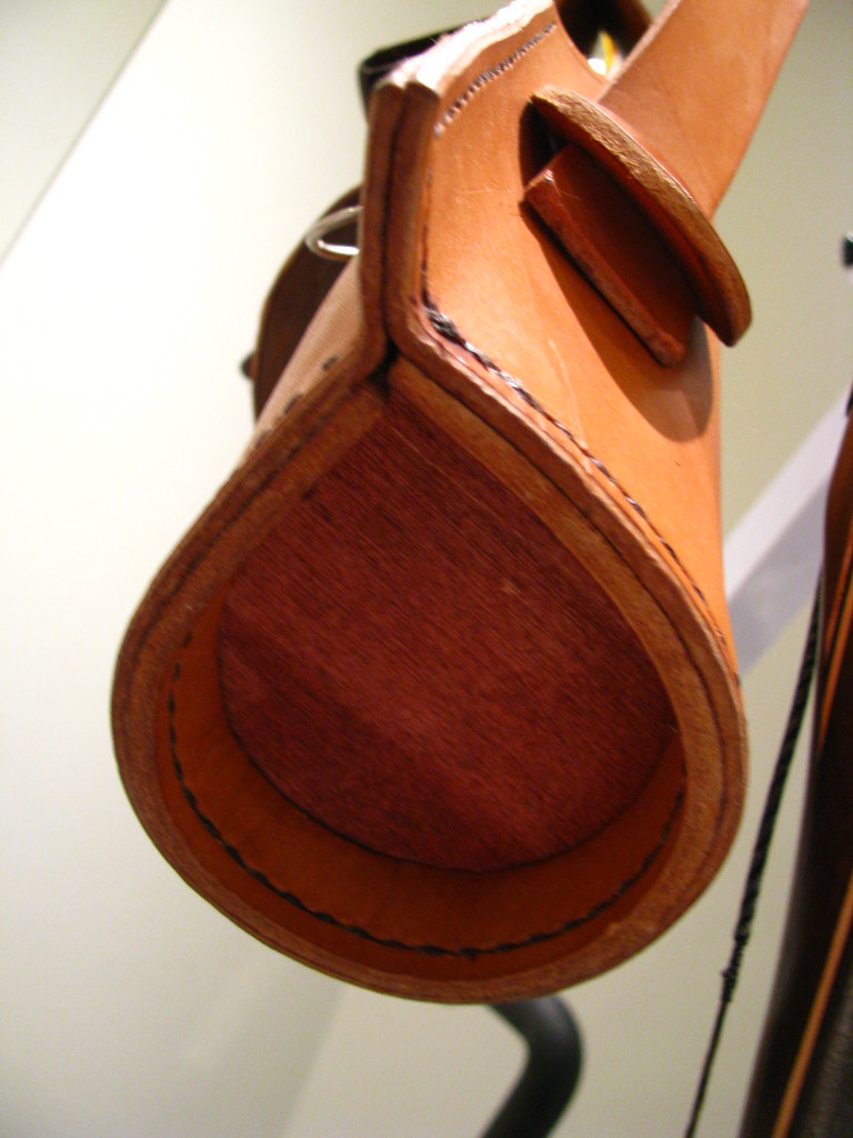

All of it is done with 8-9 oz veg tan leather, except the front and sides of the pouch which is 3-4 oz veg tan. No dye used, just the natural darkening that happens when I apply my finish, which is sno-seal with a little extra beeswax and pine pitch added. I've never used a more waterproof finish.

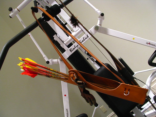

Well, here are the pictures. Quiver first, I used a piece of birch plywood for the bottom, but I stained it to go with the leather a little better. You can see the ring were the pouch is going to hang from.
I threw this one together pretty fast, in one afternoon, so I didn't pay very much attention to getting the edges perfectly lined up, trimmed and burnished. I knew it was going to be for me only, and a user, so it doesn't really bother me much.

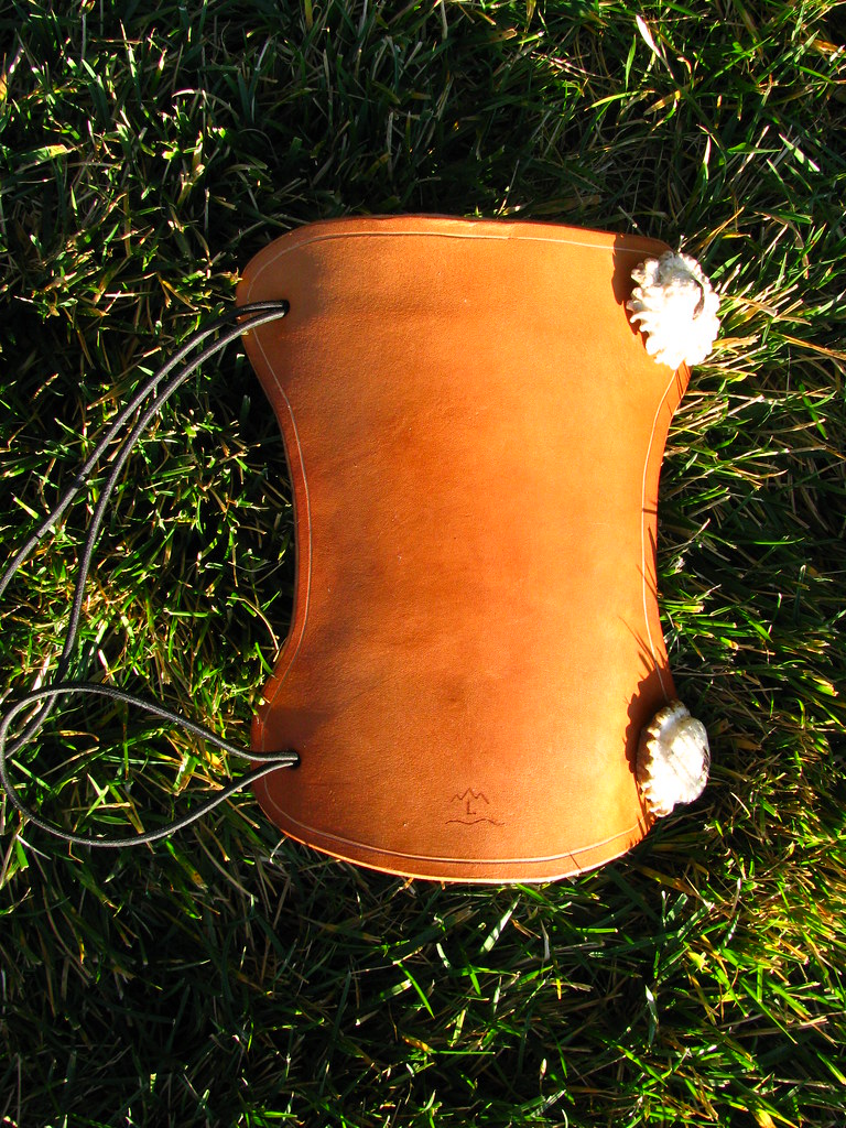

Here is the armguard, I don't feel a thing with this guy on.

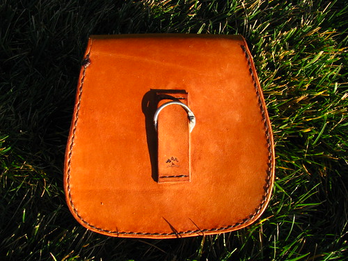

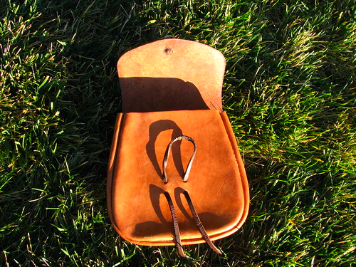

And finally, the pouch I have been working on. I am super stoked with the way it turned out, as I've never made a pouch before, and I've never made an inside out seem before. I learned not to pull the threads too tight though, on thin leather.:slap: I also made this pattern from scratch, so I didn't know how it was going to turn out.
Here are a few pics, before I turned it inside out.
And the finished product:

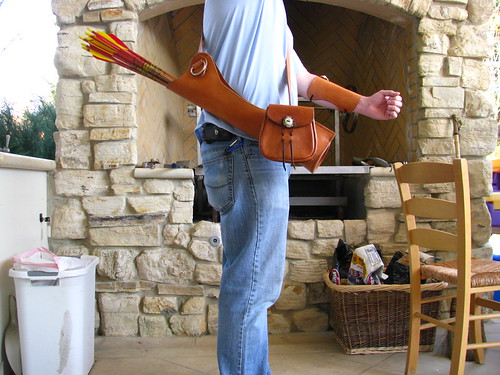

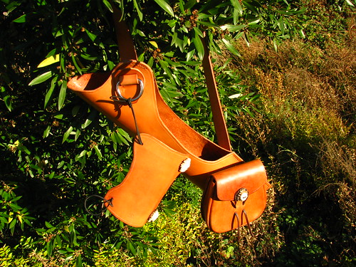

And the whole set together:
P.S. My leather makers mark, which is brand new, has already changed, since I now notice that it could look more like a grumpy face rather than, moutains L river... :shrug:

I almost spit my coffee when you pointed out the grumpy face.... that's funny, dude.
Awesome leather work.... great pattern.... good friends..... and a kickass outdoor grill!

right on Nick... that turned out great man...:thumbup: i like it.. that's a good size pouch.... that ring still enables you to attach some shoulder straps if needs be...

i dig your grumpy face mark...:D

Looks awesome - so THAT is what the workout machines are for? ;)
TF
Workout machine?! I was wondering what all those other gizmos were for... I thought it was a bow hanger.

Good eye Mike. I forgot to mention, In case anyone else was wondering how I got the pouch on the quiver, I used a ring that hinges in half and snaps together. I just put it around the belt loop of the pouch and the other shoulder strap holes for a left handed person.
