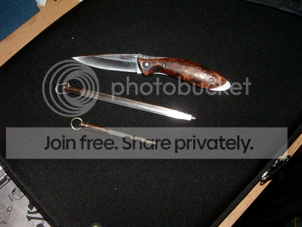

I was walking around North beach the other day. I went into Columbus Cutlery on Columbus in SF. It is not a bad store mostly cooking knives but there are a few things to checkout. They had a Frosts scandi clipper for $15. That thing was sharp as hell. :thumbup:
Anyway, I was just about to walk out then I checked the bottom self and there they were...mini sharpening steels. I bought them without hesitation.
The longer one on top is 5.5" and the shorter one is 3" overall, perfect for my PSK.:D
I love sharpening steels, especially for field sharpening. Most knives (Especially carbon & AUS8) after a day of using don't need to have metal ground off, they just need a realignment of the burr. Basically, the burr gets all bent out of shape and it is not uniform. This leads to poor cutting performance. A sharpening steel doesn't remove any metal. It aligns the burr again to make it uniform and Voila, it is razor sharp again.
Finally, after all these years of searching.

THey actualy realign a damaged edge...The tiny blemishes, rflat spots and rolled bits that occur through using a blade can be etraightened with the stell and make the blade servicable..beyond that once "steeled" the blade can be much easier to sharpen.

i don't personally believe in what steels do, i much prefer to strop than to steel. stropping removes a burr, and removes a tiny bit of metal, so i think that it leads to a sharper edge that is more stable.

I can't help but wonder if those who say steels don't do anything have actually used them ?
I find that for most the time I can get by without sharpening my knives as using a steel keeps them sharp. When your knife feels dull it is often only because the finest part of the edge is out of alignment and using the steel restores it as good as new !!!

I've found that the steels that aren't completely smooth but have really fine ridges in them do remove some metal, just a really small amount. I was at a friends house and his kitchen knife was very dull. All I could find to sharpen it was a steel. It took a really long time but I was able to get the knife shaving sharp.

I've been looking for a compact steel for quite awhile. I found one the other day at a dollar store. Took it home and tried to use it. My Buck Alpha Dorado actually cut into the steel! :eek: At first, I thought it was aluminum but it sticks to a magnet, so I guess it's really soft, untempered steel and, of course, useless. :(

Gazaati, You are not killing my joy. They work, they work really well! I own all kinds of sharpening methods. I will chose a steel hands down for most knives that have recently been sharpened.
You only have to stand in a real butchers shop for ten minutes and you will see the butchers touching their knives up on a steel between serving customers, they don't pull out their diamond EZ-Lap or start rubbing compound into their strop because they know that the edge can be restored quickly and easily using a steel !!!
