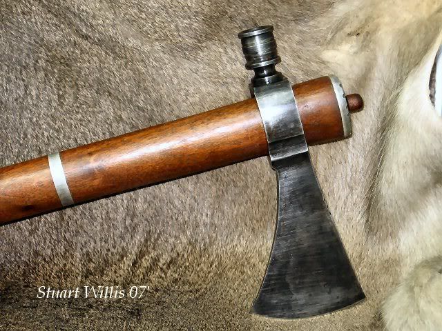

I make all of my hammers, hammer handles and drill out pipe hawk handles on mine. But I do alot of other types maching projects besides knives. After I make a couple knives I take a break do something different.

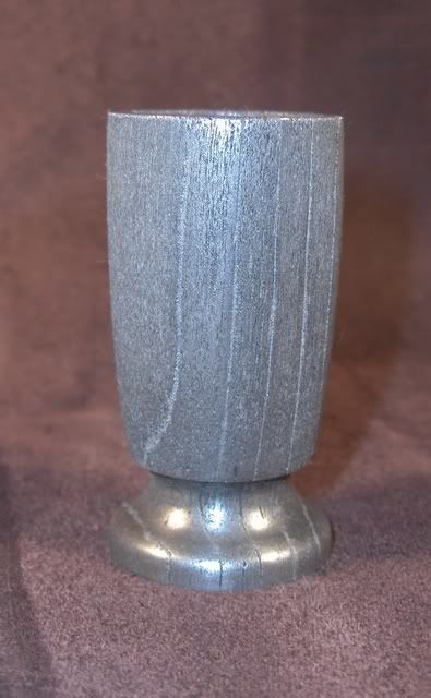

Like a shot glass out of 150 yr old iron.
Wood carving gouge handle out brass, copper and pacific yew.
Horn pipe for a tomahawk.

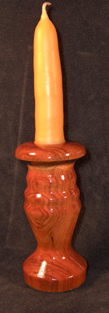

Candle holder for wife.

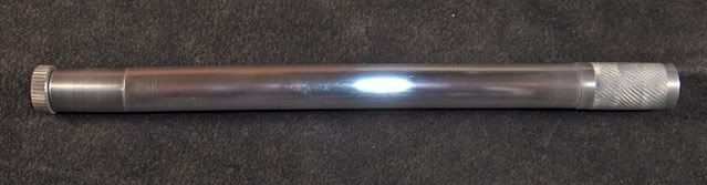

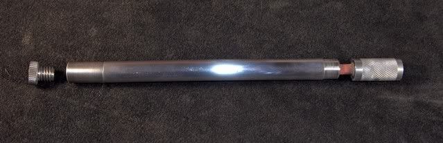

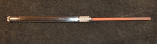

Magnesium sharpening stone and storage handle for a survival knife.

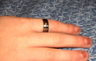

Indian head nickel ring for my daughter.
Assorted different hidden tang saw handles. This one is bronze.
