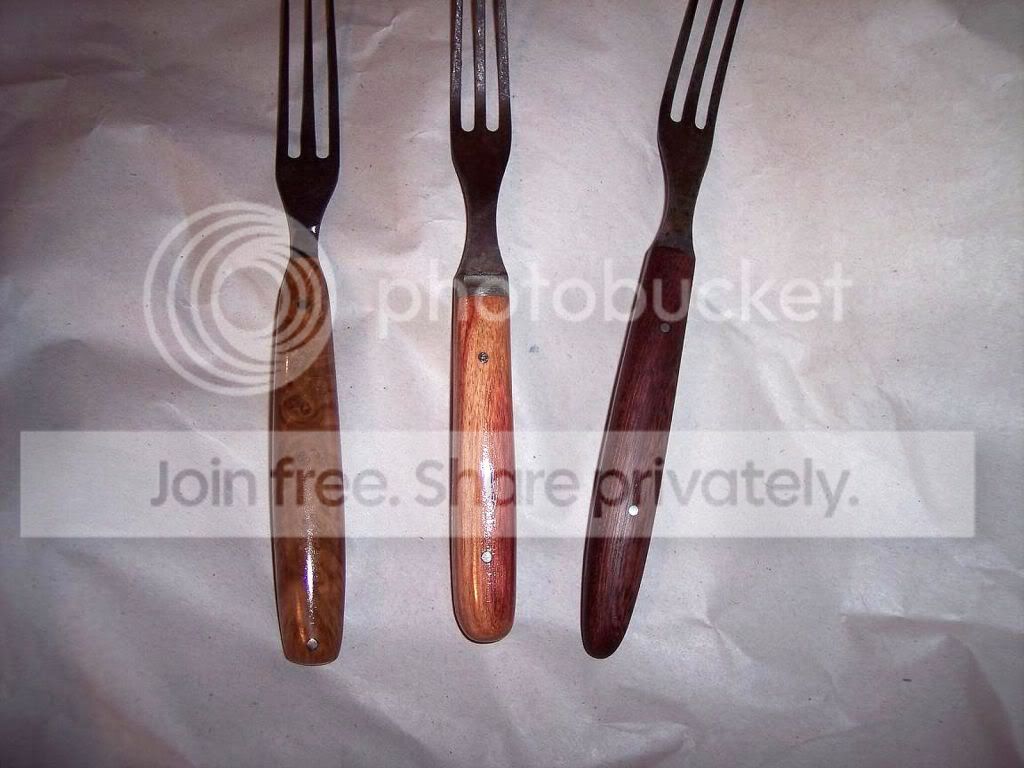

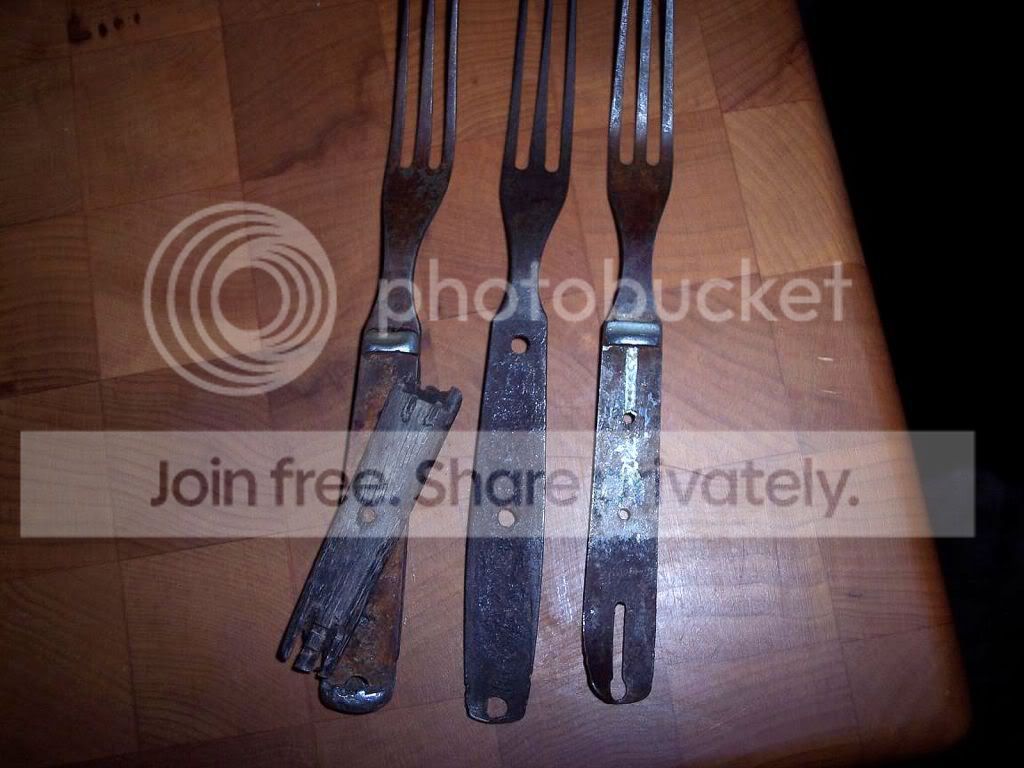

Griz that looks really nice. You did a great job, and I hope you had some fun, even tho there were some "design changes"..... :D Welcome to the addiction. I think the support group meeting is on Wed nights, in chat. Heres a refurb on a few antique forks I did from awhile ago. Good luck with yours. -Larry
BEFORE >>>
AFTER >>>>
