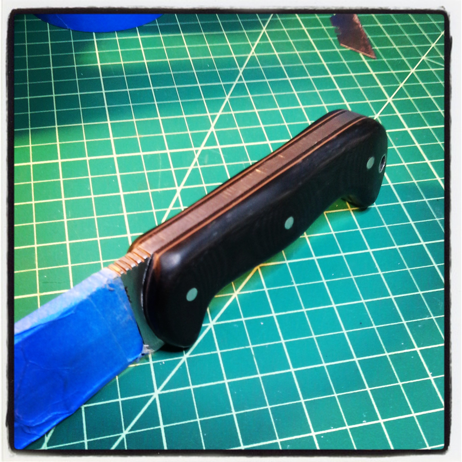

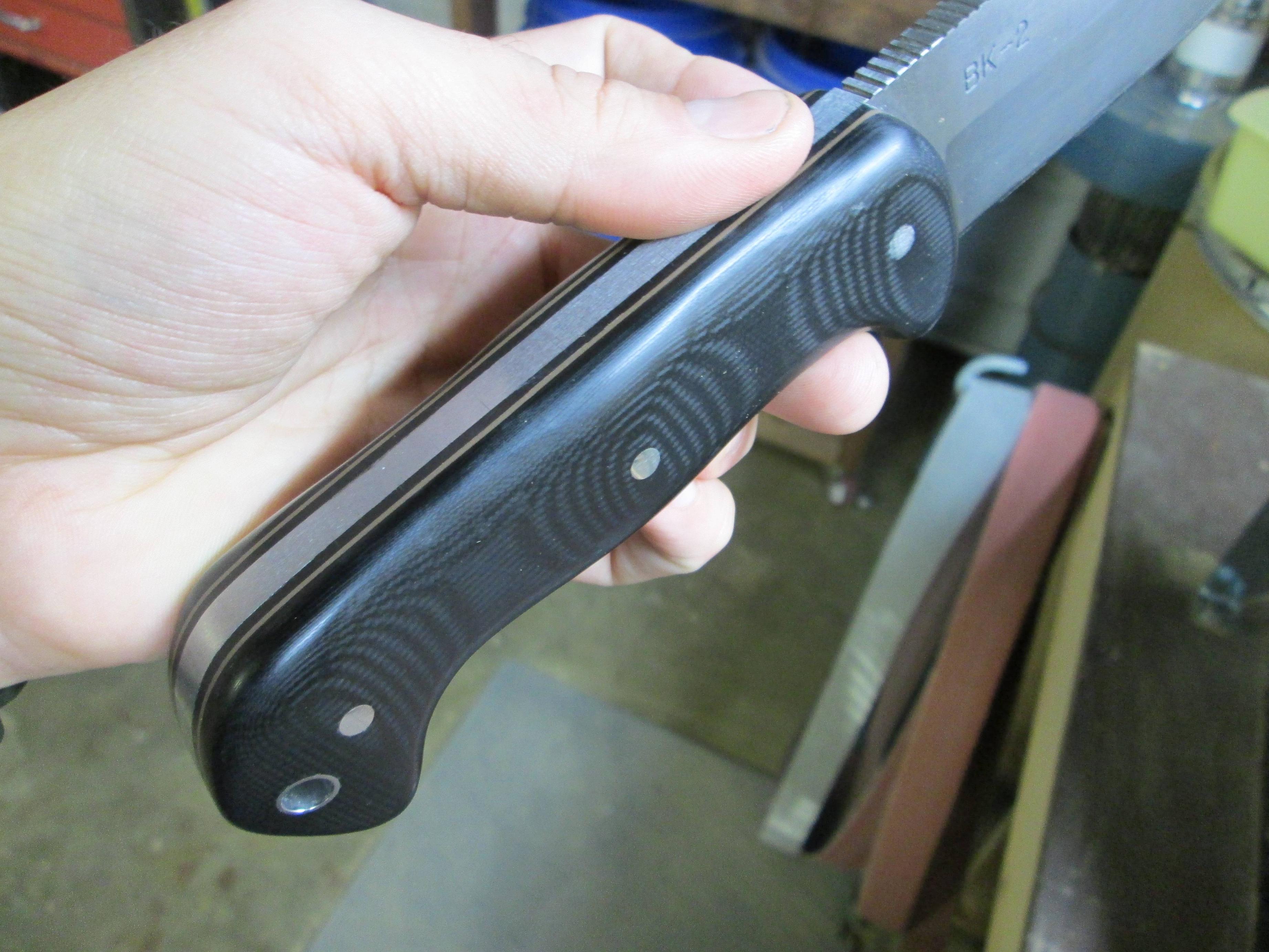

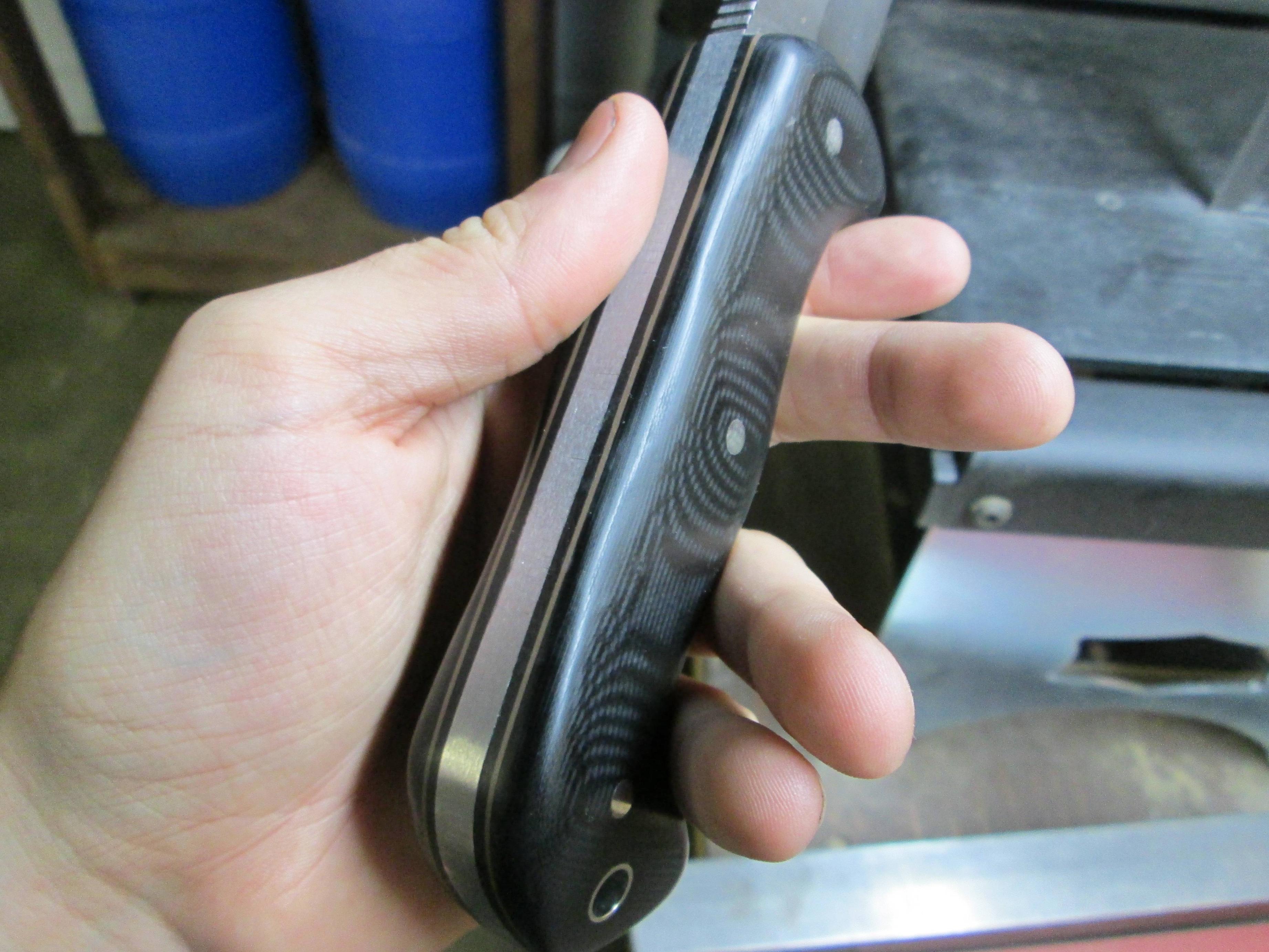

Finally got around to making a handle for my Gen 1 BK2
Feb 23, 2010
1,497
Years and years ago I got a BK2 after I broke two Gerber Big Rock camp knives.
Getting that first Becker in my hand ignited a passion in me for knives and since then I have gone on to build my own knife shop and start making blades myself.
I figured it was about time my BK2 get a proper handle.

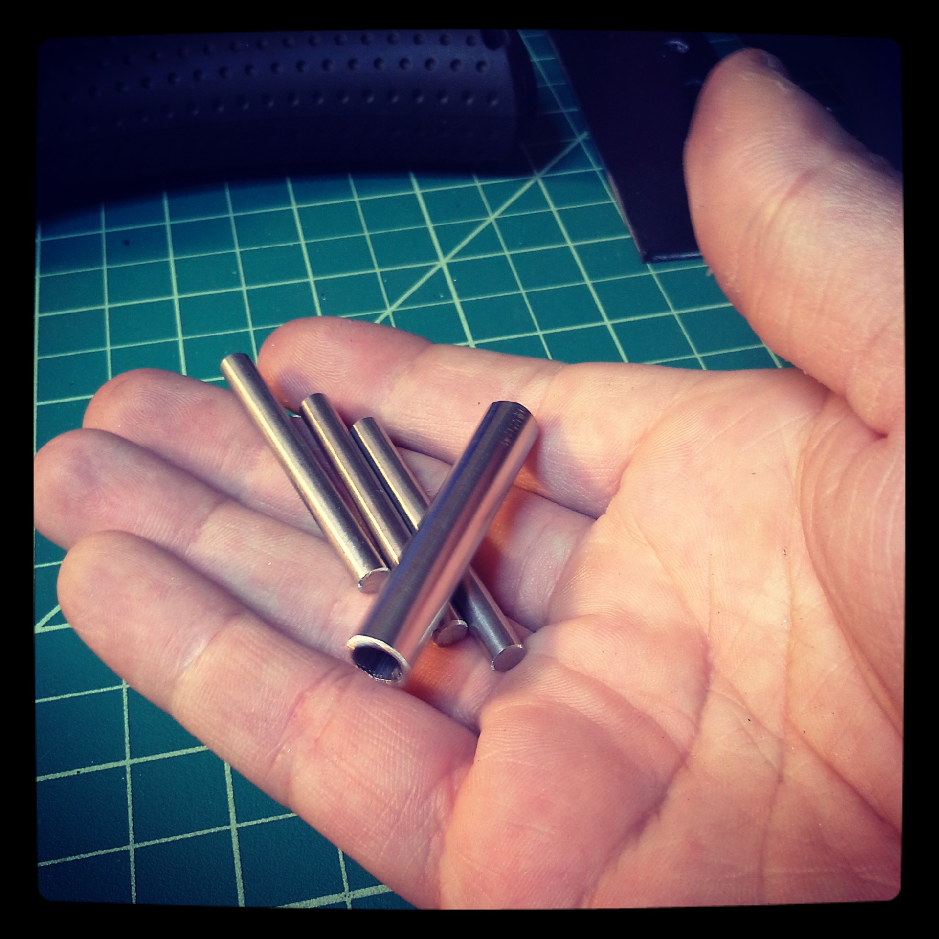

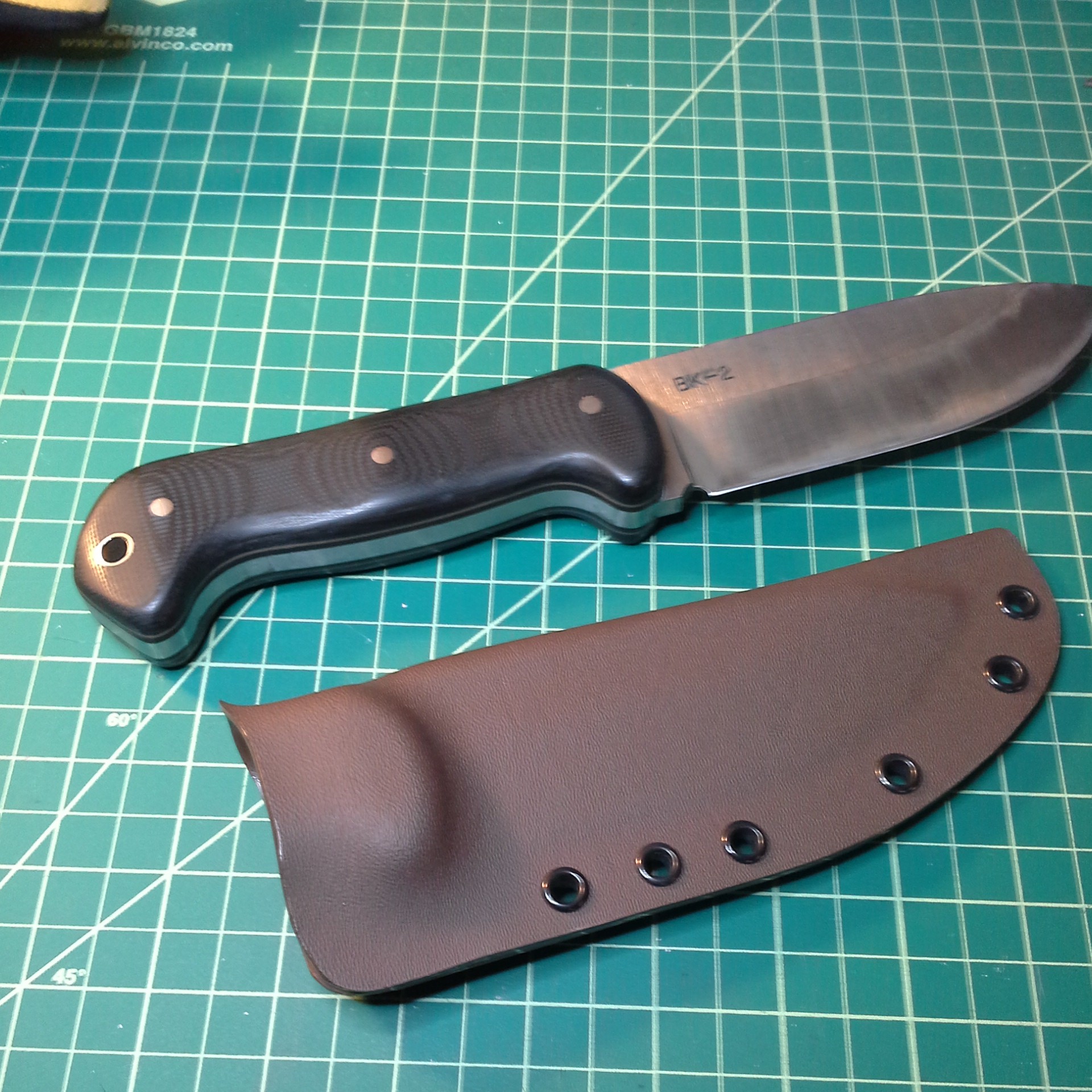

The handle is black G10 liner, brown g10 pin strip, and black G10 main handle slab. The pins are stainless along with the lanyard hole.

Thank you very much, its sanded to 600grit, I contemplated making it even finer but this thing is super smooth.

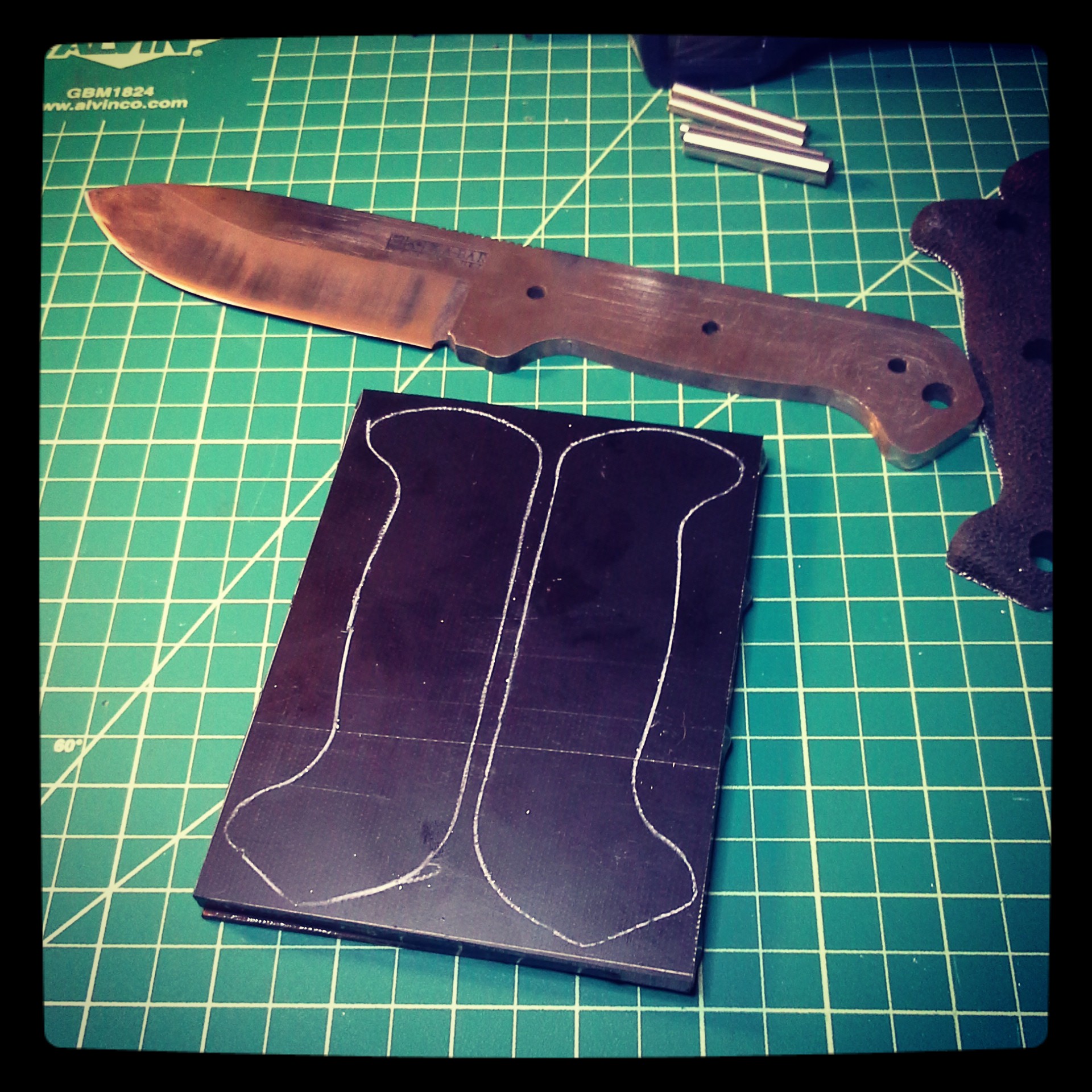

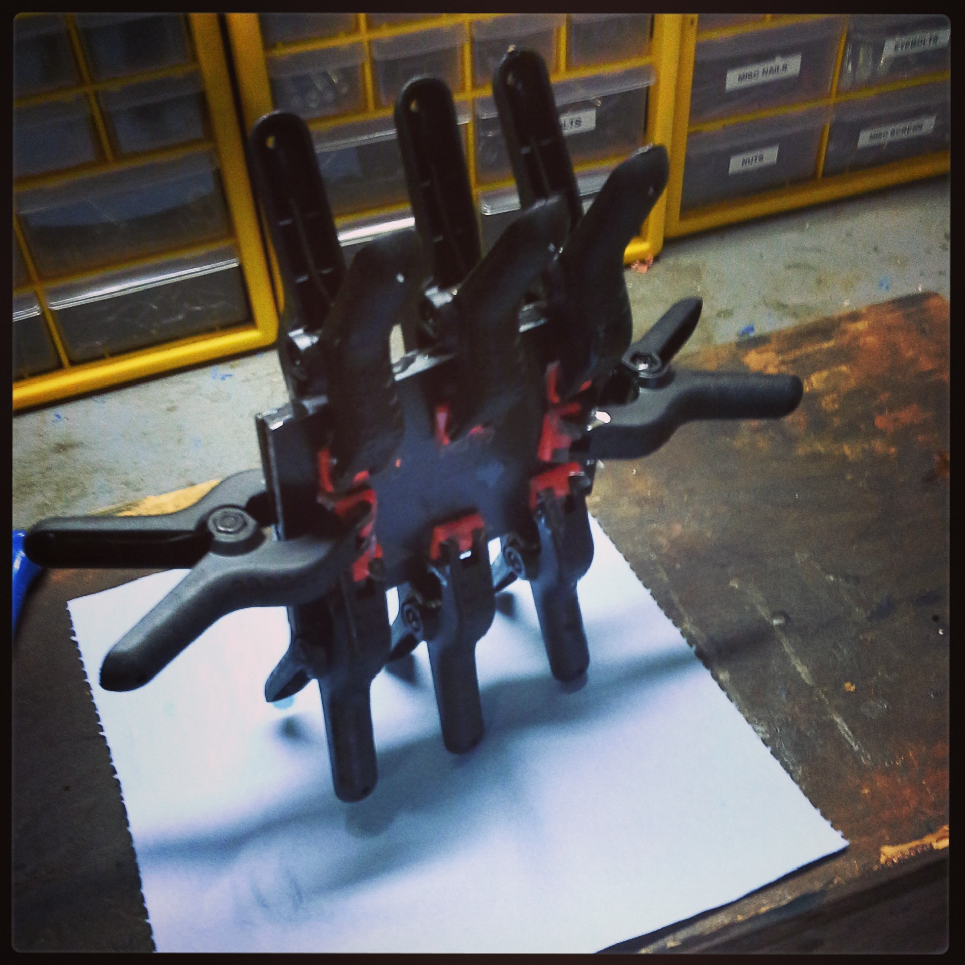

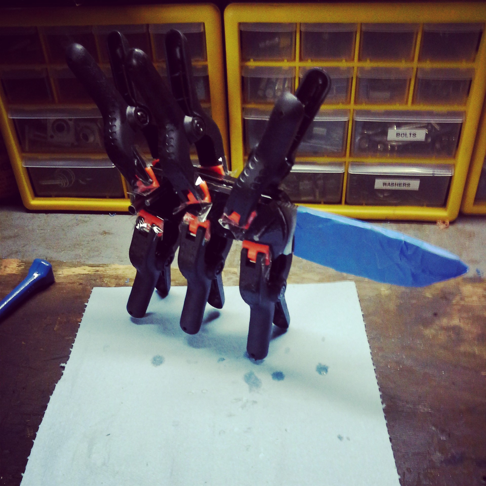

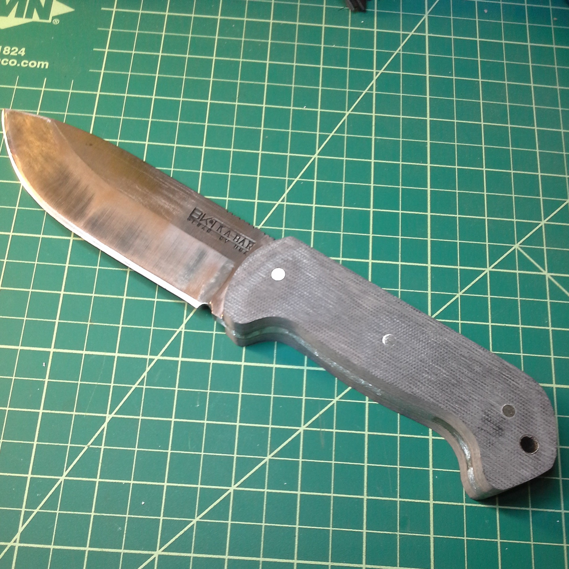

Well I did the handle glue up and let it cure for 72 hours, rough cut the handle shapes out and pin and epoxied it to the knife and then waited another 72 hours, then I shaped it on my KMG grinder in about an hour and then did some hand sanding, really about 4-5hours of real work on it.

I really love how with a pinned handle you can get the slabs on a full tang knife to match up perfectly which is something I think might almost be impossible with a bolt on handle.

I also tried really hard to match the original dimensions of the stock handles.

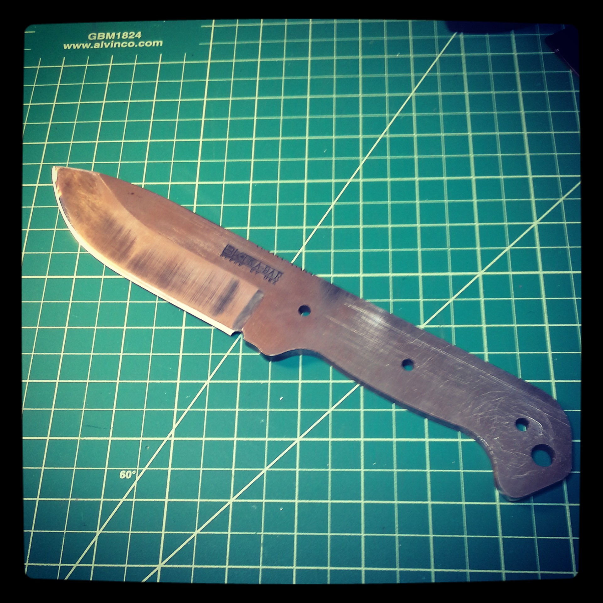

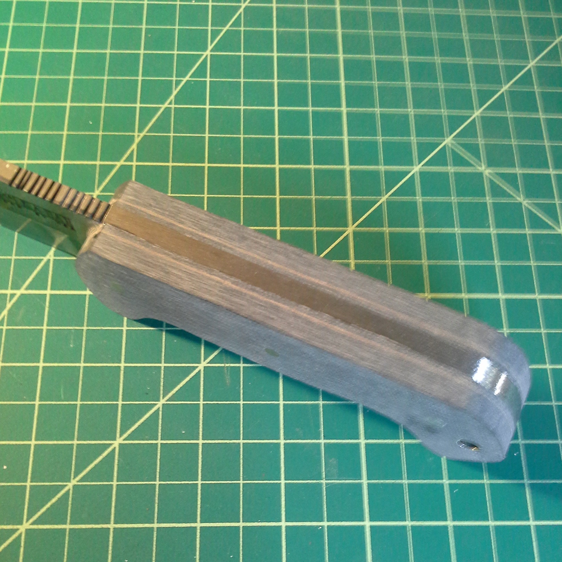

Sorry for the horrible phone photos but here is some of the work in progress making these handles.
