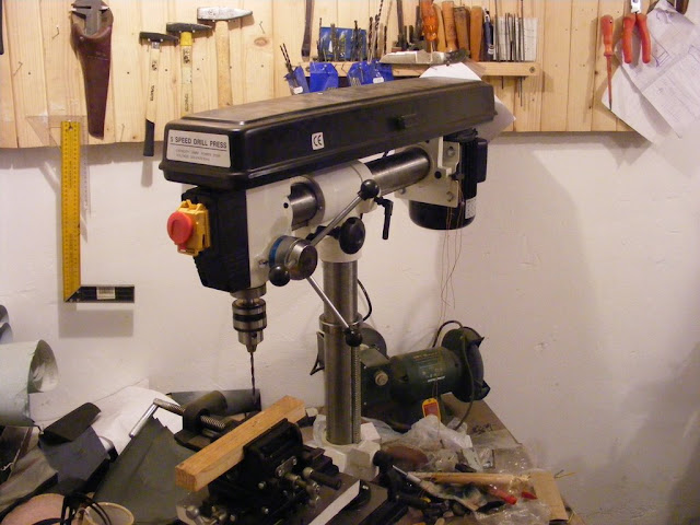

I have a big drillpress. :jerkit: Made in PRC, of course, but very tough. I add a small milling machine XY vice. I will be able to mill some sloted guards and slots for hidden tang. all the stuff for only 300$
Cool. Congrats! Be careful with side loading in a drill press. The machines just aren't built to take it. So if you do try some milling, go very slowly.
--nathan
Congrats on the new tool... always a joy!
Gotta rain on your parade a little though. That drill is not designed for lateral loading, and if you use it like a mill you'll quickly have something that's not suited for anything, let alone drilling an accurate hole.
Use your vise to drill holes in a straight line, and then file everything clean. :)
Thanks and thanks for the tips. Looks like next machine will be small mill.......
It never ends, doesn't it? :D
You can mill in a drill press, but the depth of cut has to be very light. If you shave off no more than .010" depth of cut per pass it will probably be okay. But if you mess up and overshoot on a pass while half way down and bite a cutter into your work piece you can damage the spindle, and push your chuck off its taper creating a heavy projectile with an endmill sticking out one end. I don't recommend milling with a drill press for that reason, though I would do it myself.

And I have milled using a drill chuck. The last time was several years ago, I was putting a big hole in a big PVC block using circular interpolation. I had the drill chuck in (for drilling a start hole) and I was thinking "bah, it's just PVC, I'll just stick the cutter into the drill chuck and save myself 20 seconds). After about 10 seconds the helix of the endmill had pulled the cutter far enough out of the drill chuck that the depth of cut was out of control and the cutter seized in the plastic. About one second after that the jaws on my ~$400 drill chuck were red and melty...

When I was first getting started I used an X-Y vise on a drillpress for milling. I did indeed pull the chuck off several times. I broke a lot of cutters and finally switched to using diegrinder burrs, still kinda didn't work well. I bought a small mill-drill from Grizzly (cheap chi-com crap) and it works reasonably well. I really need a bridgeport (Hey Nathan you got any you wanna get rid of now you are all automated?)

Could he use 2 flute mills and drill one hole then move over 1/2 a hole and drill again, repeating the process untill he has done the slot. Mills work much better for this than drill bits being square ended, short and rigid and he would always have pressure on the taper. Then after he was done drilling the slot make a full depth pass thru the cut. I have never donne thish with a press but, it works well in my mill.
the drilling connected holes with center cutting endmills is a very good process, the problem would be the sideways cut to clean up. 4 flute cutters would actually be better for that as the shocks that hammer the the chuck off the taper would be less in a 4 flute. When I was using my drillpress to mill I found the diegrinder burrs to work best because the 30 or so flutes carried the work continuously so the shock and vibration was less

to cut slots in a drill press you can mark out your slot in the guard and drill holes the entire length of the slot. then you can run the mill down the slot easier since there will be very little to remove.
That was my point exactly. Holes, than light milling at the pinch of the milimeter. Now I am thinking that is maybe better to clean slotted guard with thin cut off disc on my 125mm angle grinder after drilling and cleaning sticked guards with chainsaw file. Atleast unthil I buy a mini mill from the same brand. :rolleyes:
