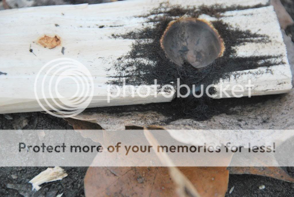

The drill and hearth were both made from the same piece. The drilling went quite well. Smoke in about 30 s after starting.

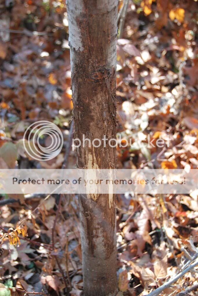

I decided to forage a bit for something different. I came across this.
Peeled out the dried inner bark and formed a new tinder bundle with this stuff.
Went at the bowdrill again. I simply used the same divot and just like before, managed to pop out a coal right away!
I stuck it into my new inner bark tinder basket and again, no go! Got smoke for a bit then it just sort of petered out. I wish I had a coal extender like true tinder fungus. That probably would have made this a success, but I wanted to keep this real.

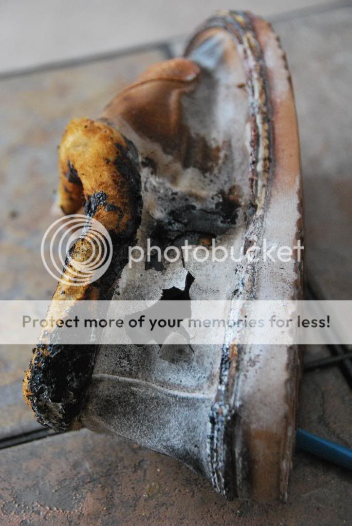

NICE! I enjoyed the play by play. I have to ask, did you have a kydex Bic sheath in the third picture from the top?
Yeah, made by Eric at On Scene Tactical. These things are great. I might have challenged myself, but that didn't mean I went out unprepared ;) Also, my crappy canned heat stove only lights with direct flame. Firesteel and sparks alone can't get the gell/soaked wick to go.
