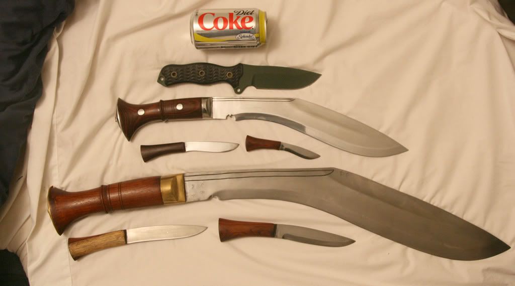

So after several ears of use my purpleheart handle finally developed a crack after I put some linseed oil on it. I think the linseed oil created stress by loosening up the exterior while the interior wood as still very dry from my current desert surroundings. Plus the winters here fluctuate between really humid and really dry, probably adding to the stress.
It's original form:
The day the scales sheered because I hit it with a baton. The pins were soft aluminum with no reinforcement, so it was bound to happen eventually

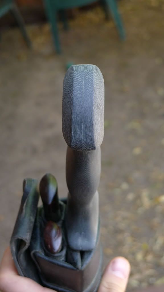

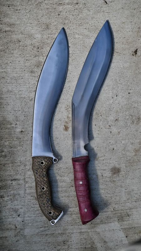

Heres the purple heart rendition, after I ground down the tang down so it could be a wide, rounded hidden tang:

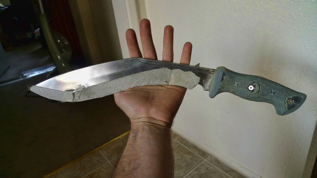

and now the new handle

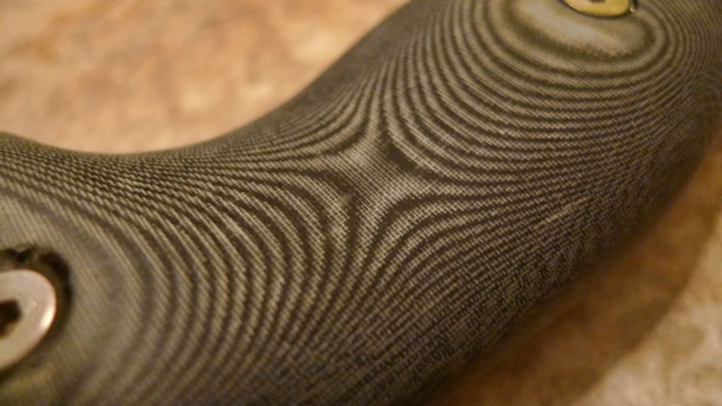

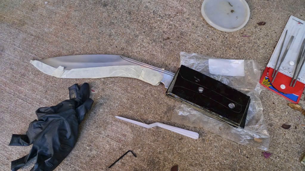

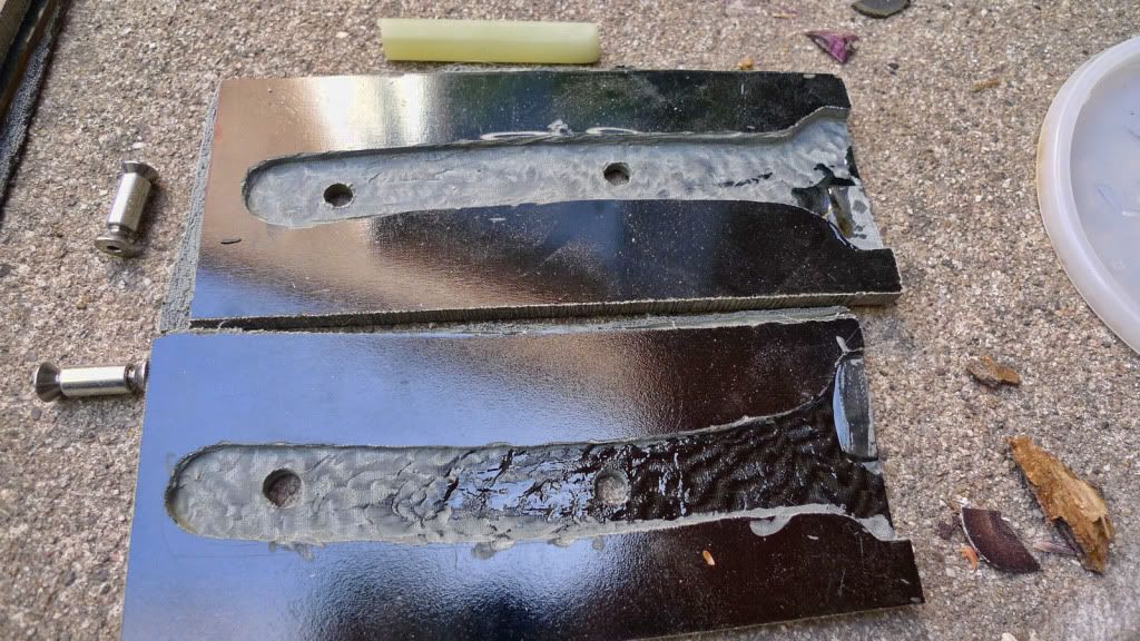

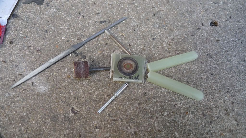

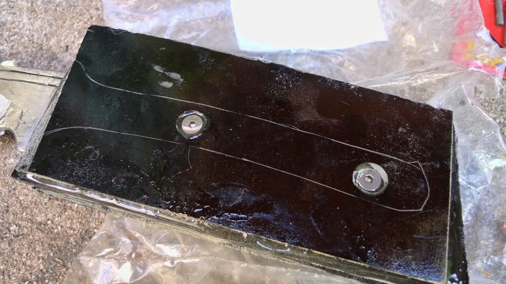

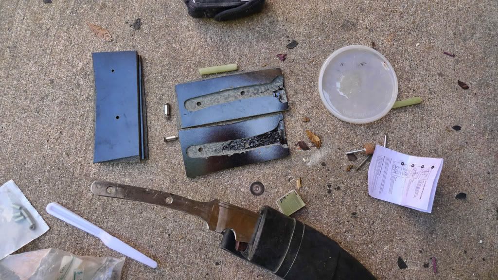

I've been meaning to do a micarta/g10 handle for a long time, but never had a reason/resources for it. Using only a dremel and a 4x36" belt sander on my patio, I peiced together a 4 layer hidden tang handle, all glued together with 2 ton epoxy and screws+standoffs.
I had to glue a wedge into the hidden tang compartment because I got a little over zealous near the cho side and made it to deep
my girlfriend helped by making a parts-man:
after rough shaping:

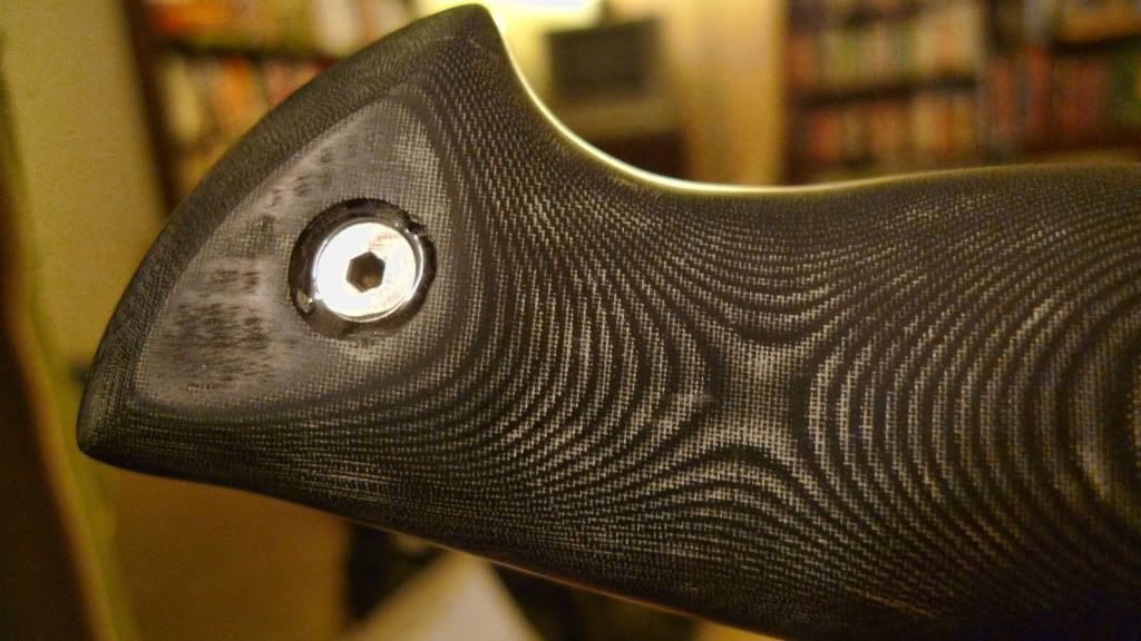

I brought it to a high polish
But decided on a rougher 320 grit finish for grippiness

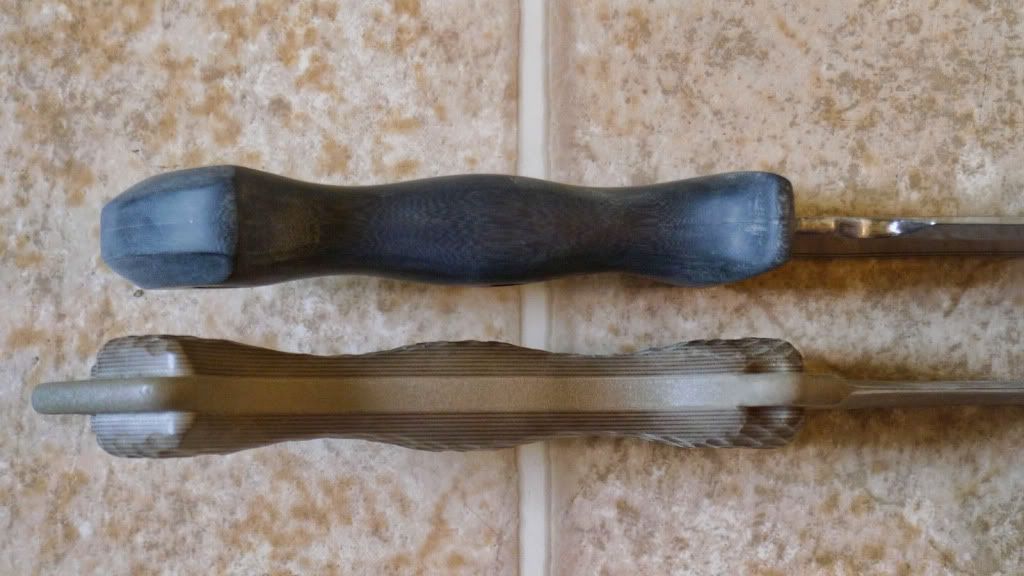

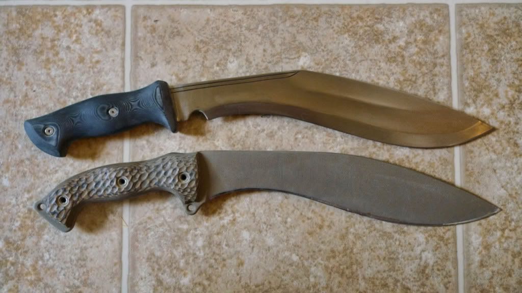

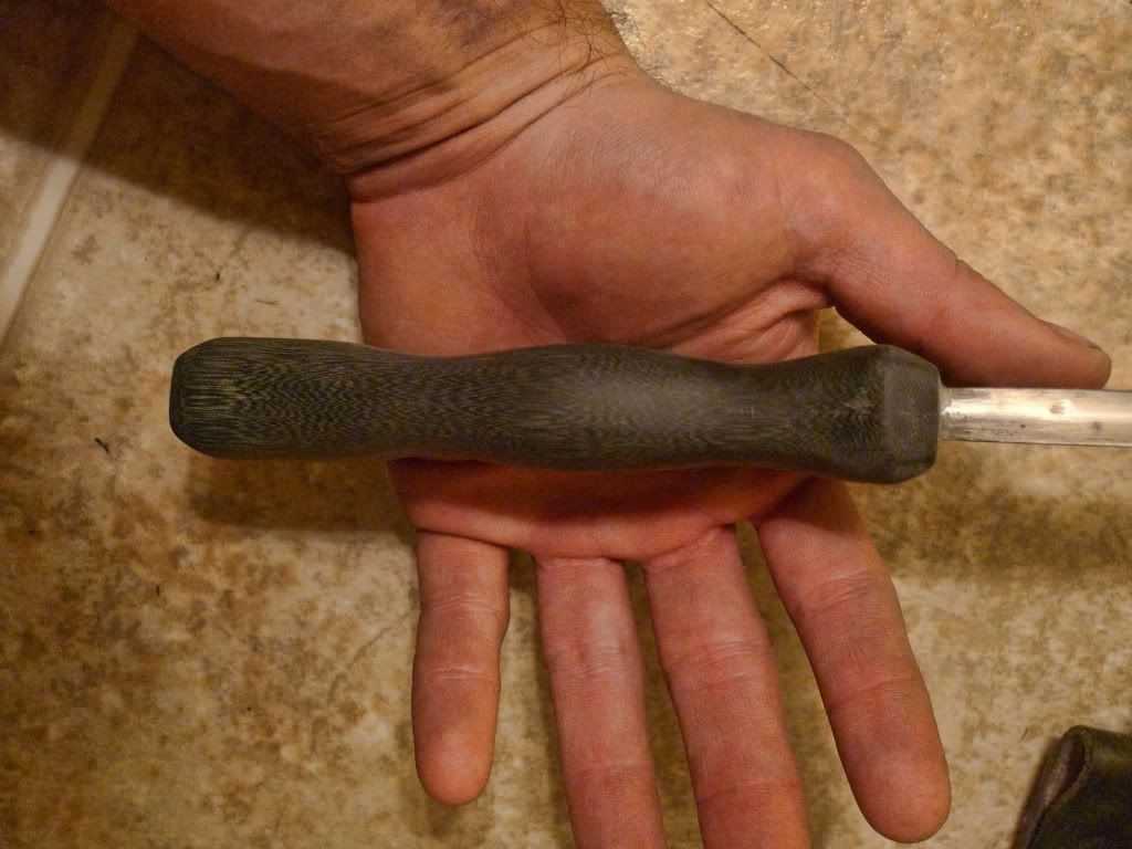

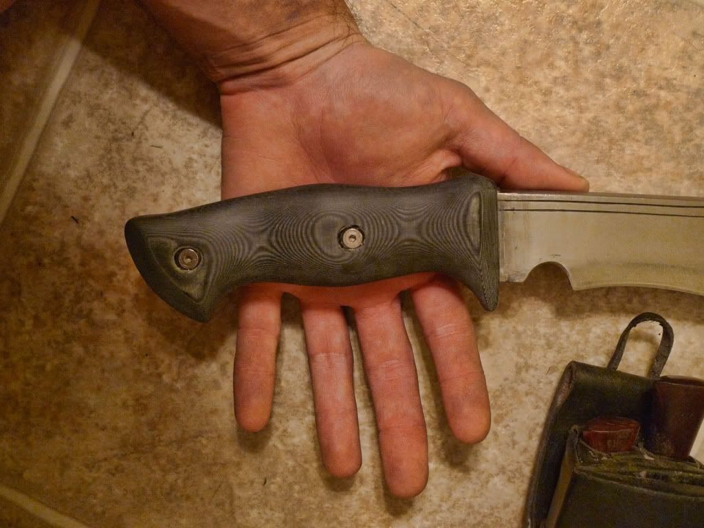

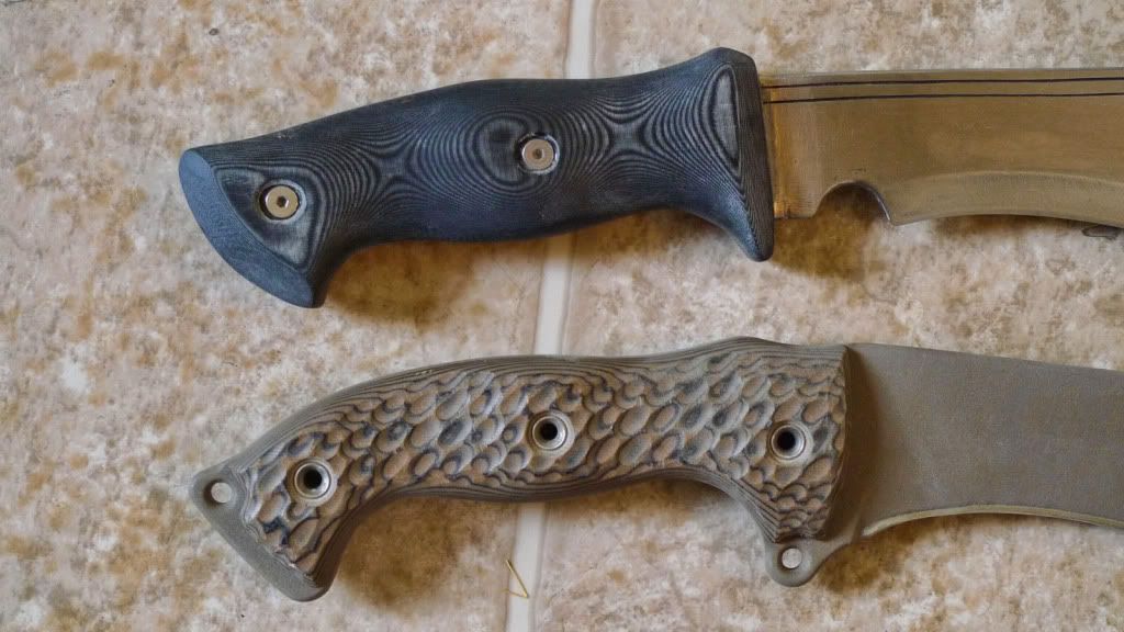

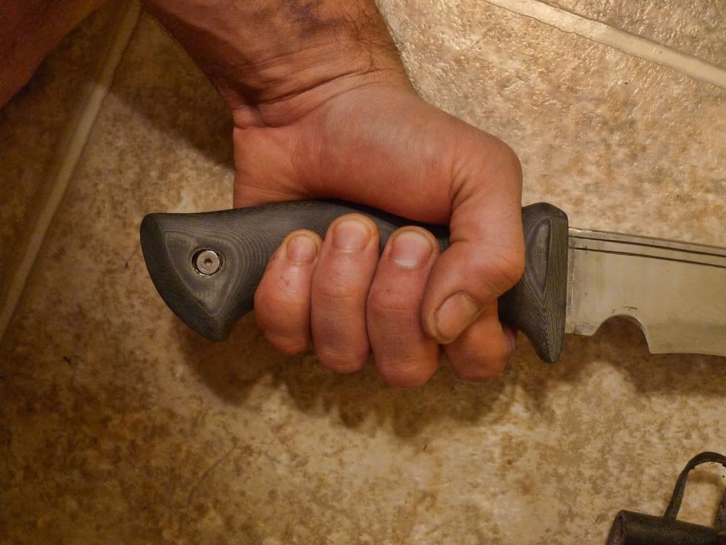

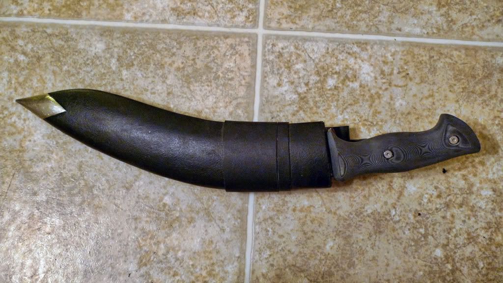

I tried hard to avoid two things, making it look exactly like a Jerry Hossom handle, or the TTKZ handle from Busse Combat. The purple heart handle I shaped solely off of my own hand and my sensibilities for handle ergonomics, but really it ended up being very very close to a slightly more rounded TTKZ handle. This time it ended up being nearly identical in perportion to the TTKZ handle, with only a few very slight modifications, mostly to the palm side of the pommel swell/drop.
I haven't gotten to use it yet, but I'm sure it will do well, as well at least as the TTKZ handle. It won't be quite as cushiony as the purple heart, but it will be a lot stronger and far more stable in the long run.

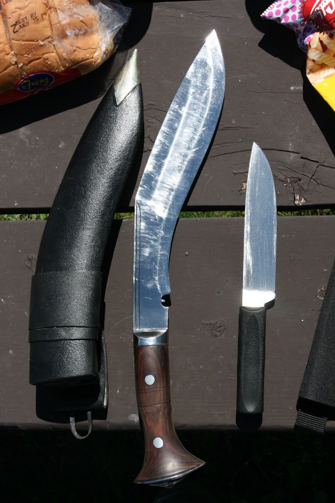

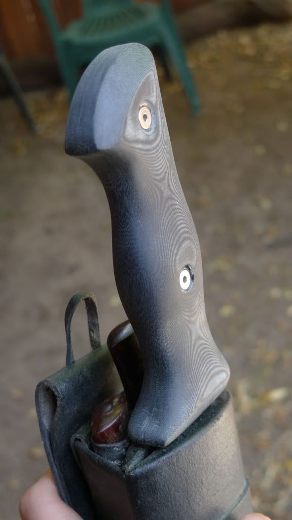

It's original form:
