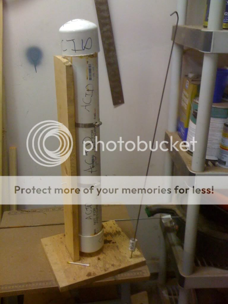

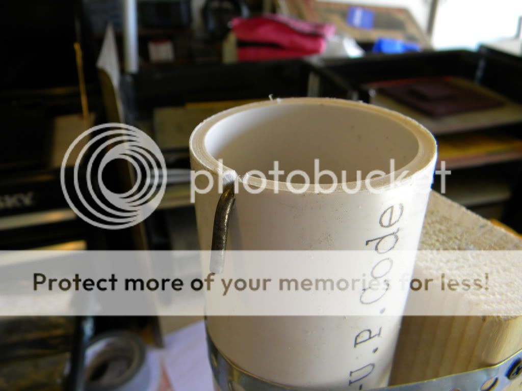

A while back, William (cbr900son) here on the forum was kind enough to send me pics of how he made his etching tank. I've been busy but today finally took a little time to get one put together. I think this will work much better than the mason jar I was using that had the metal top rotting away:D

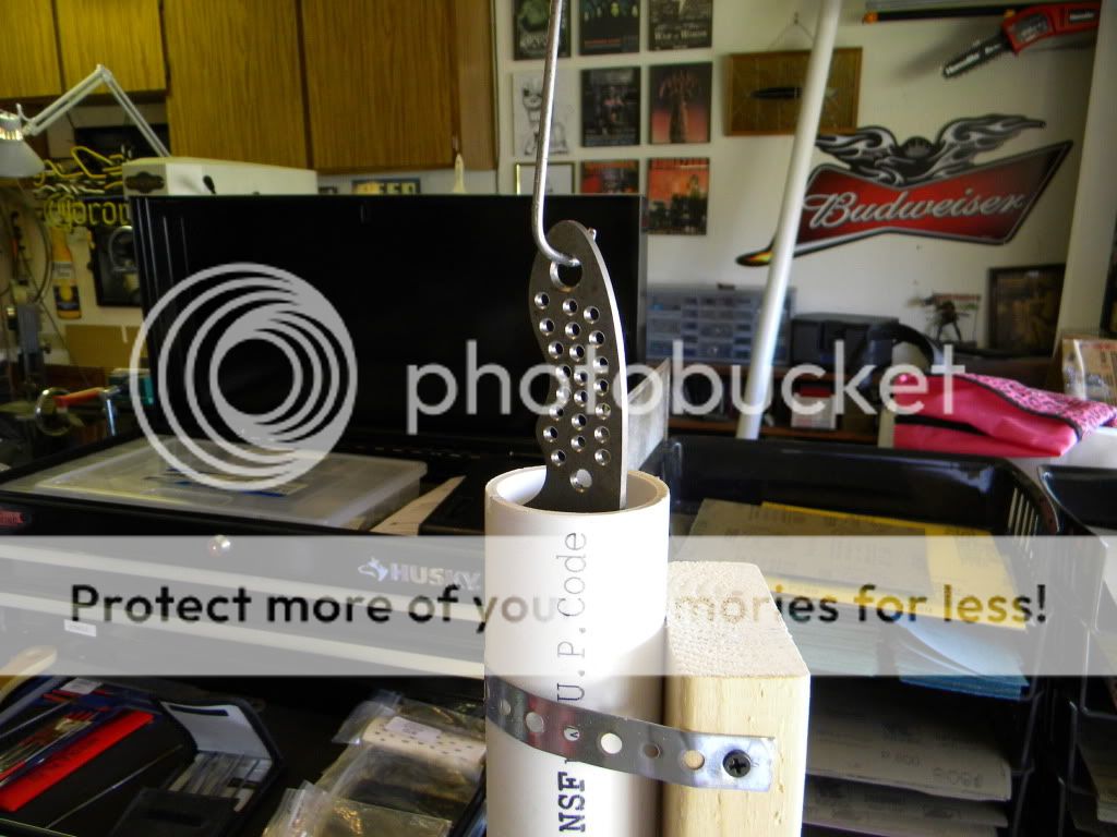

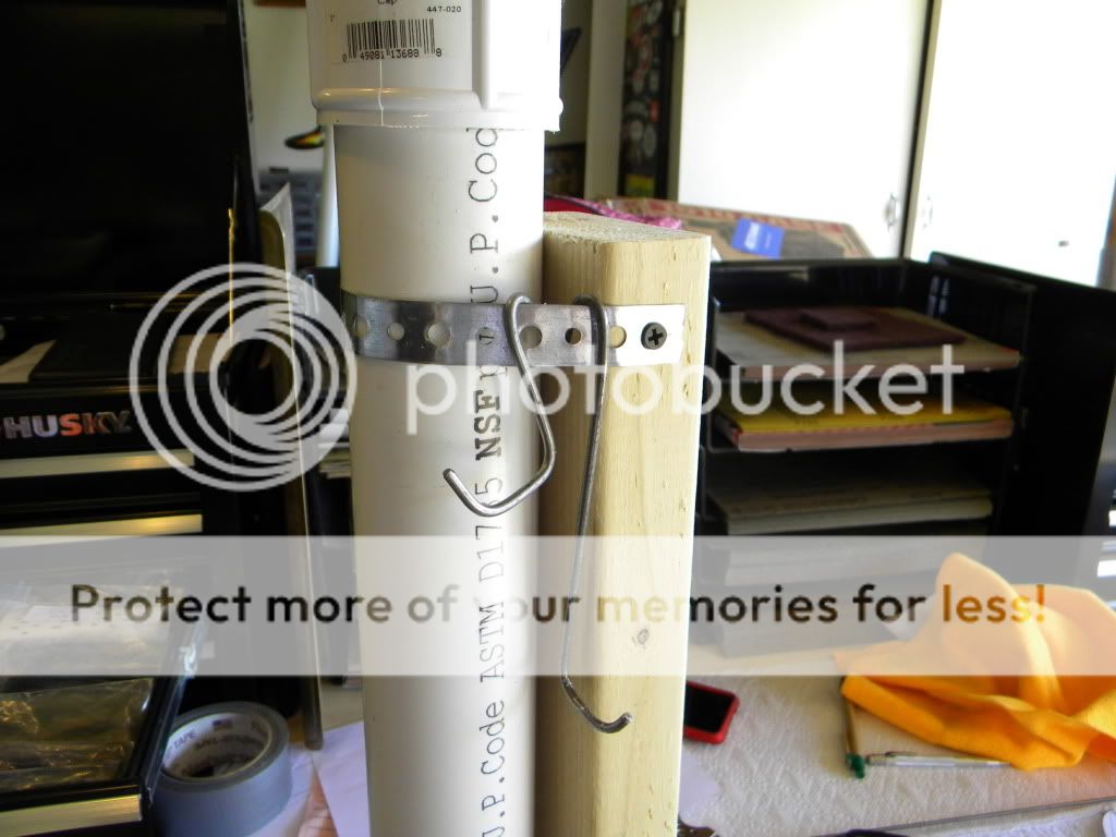

For anyone who is still etching blades in open containers and wants to do something a bit more safe and secure, this is a really easy project to put together. 2 inch PVC, glued the bottom cap on with some good 'ol "red hot" blue pvc glue, made a couple different hooks for different sized blades from 1/8" welding rod, filed a groove in the top of the pipe to hold hook securely, and mounted the pipe to a simple wooden stand with some water heater bracing strap. I think this will be a great setup and it only cost about $10 in materials. I had scrap lumber and a roll of bracing strap on hand. Lots of people already have pvc glue on hand, mine was just too old so I had to buy a new can.
Thanks William!:thumbup:

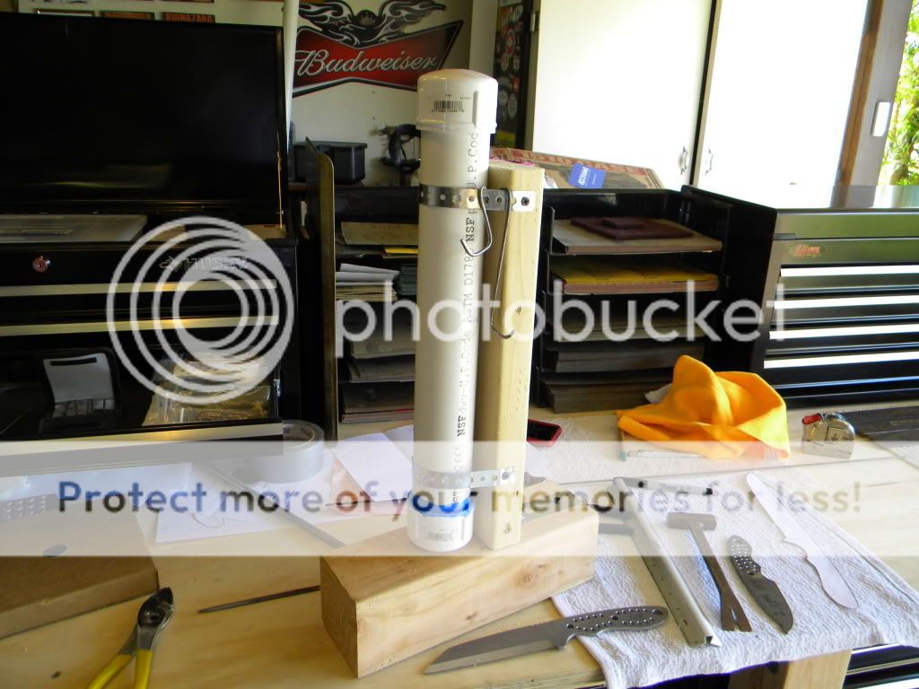

Welcome! Glad it worked for you. For the base on mine I use a 1 foot square piece of plywood.
Here is a shot of my setup. The stand is rock solid but portable and the pipes are easily removed. One is for Ferric & the other is for vinegar.

You can etch a blade or fittings a darker color if its a carbon metal. Also used for damascus and san mai. Vinegar overnight works well. It helps to scrub and clean then redunk. For a faster etch a lot use ferric acid (circuit board etching solution at radio shack) diluted in water anywhere from 1:3 acid to water to 1:10 acid to water ratios. Ive done both methods and will be soon making one for my vinegar etches. Will probably steal darrin's stand idea!
I have used Muriatic acid as well, and it will give a nice etch even with stainless steels. Just did a couple of Elmax blades and got a nice gun metal antique finish after etching for about 2 hours in Muriatic and then doing some light sanding with 1200 grit.

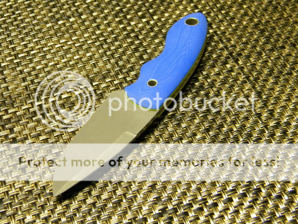

I was going to ask about stainless! Can you post a picture? Thanks.
David,
Here is an Elmax blade that I etched with Muriatic acid after going to a 400 grit machine satin finish. After this pic was taken I used some red scotch brite pads and 1200 grit wet paper to give it a bit of a smoother look and to brighten up the high spots on the grind lines. I'll get another picuture up after the kids hunt for Easter eggs :)
