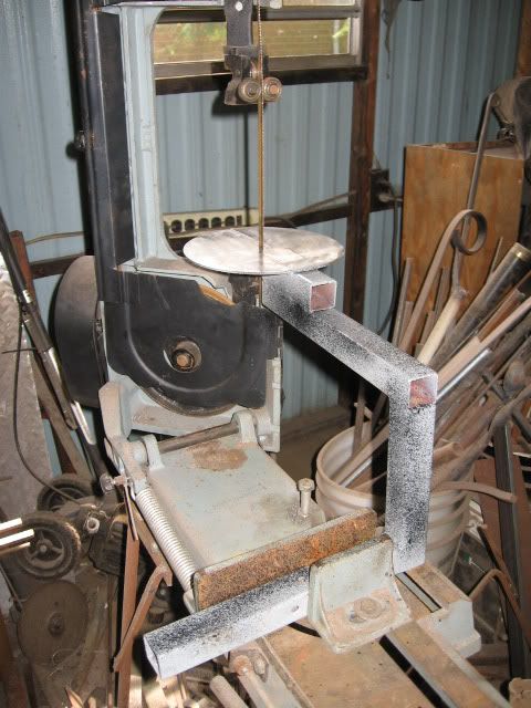

Okay here's a pop yourself upside the head idea:eek: Can't take credit for it though-came from Ray Clontz the father of the tirehammer-me and a friend made the first 2 hammers from a simple drawing Ray did-We did'n't know if it would work or not-But iv'e been using it quite a few years now-he also makes a great beltgrinder--anywho you just clamp this in your saw vise when you want vertical and take it out for horizontal-simple to weld up-glad to answer any questions:confused: :D http://i85.photobucket.com/albums/k45/rsilver4/IMG_0236.jpg ps you can even sit down-but watch the switch
