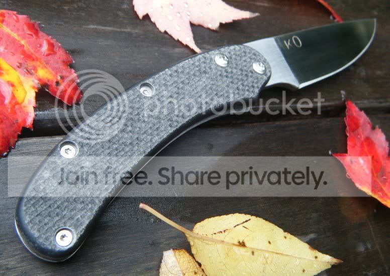

Finally almost completed my first folding knife. I say almost because I'm still hunting for a suitable pocket clip; the ones I got are too big.
Friction folder (no lock), 1/8" CPM154 PG flat grind blade, satin finish, RHC61 (heat treated by Rob Ridley - many thanks!).

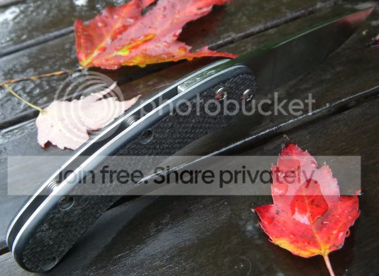

Stainless steel liners, epoxied to textured G10. Phosphorous-Bronze washers.
I won't sell this one - it is mine! MINE! :D Besides, I made so many errors making this first folder...corrected them as best as I could :o.
It was quite an endeavor for me building this "simple" folder. I now appreciate even more the knifemakers who make folders - you guys are VERY talented :thumbup:

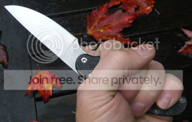

I call this knife "Because Good Beers Don't Come In Screw-Cap Bottles" (BGBDCISCB in short)...see why in the pics...
As usual, critiques, opinions, jokes, feedback, etc are appreciated!
Thanks all!
