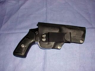

I finally formed my first holster. I do not know how to post pictures on this web site, but would like some input as to what I have done. I know this is a blade forum, but it is the only forum I can find that shares information about forming Kydex. I can send individualy emails to anyone that might like to see the pictures of my holster, or tell me how to post these pictures to the web sight.
Any input as to what I have done wrong, or right would be greatly appriciated.

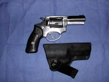

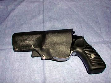

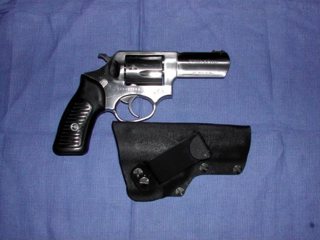

I hope this works. Here are some pictures of my first try at making a Kydex holster.
Any comments, suggestions, or ideas are greatly appreciated. This holster is not finished as of yet. I intend to cover the body side with a thin high density foam covered with spandex. I am also working on a "J hook" that will allow this holster to be "tuckable", as well as a way that it can be converted to wear outside the pants, but under the belt.
They look pretty good! Might want to use a little more pressure or a little higher heat (not sure what your setup is) to get a more impacted imprint.

I was using a heat gun when I formed the first holster. I had the problem of heating a small area, and losing part of the area that I had just formed. I partially fixed this by covering these areas with a wet cloth, and using this wet cloth to form the Kydex.
My wife (who is a shooter) would shoot me in the rear end if I messed up her stove, suggested that I use a cookie sheet, and a silicon baking sheet under the Kydex sheet.
This would let you heat the Kydex in the oven, and then quickly fold the Kydex over your form.
I have not tried this yet, but see the benefits.
I was working with a holster for a Revolver. They have a front sight that requires a channel. They also have a cylinder, and a "recoil shield" that requires some clearance. I don't think that "deep forming" a holster like this would work all that well.
I would not have traveled down this road if I could have baught a decent holster for my firearm that would have been convertable and covered the trigger and hammer so they did not rub my fat roll

Hey, no offense taken. On small projects (3" - 5" blades) a heat gun works pretty well. What I was saying was that when you look at the trigger guard, cylinder and barrel, you don't seem to have enough pressure or the Kydex isn't quite warm enough to fold around those areas. The biggest issue I've had is getting a uniform plasticity with a heat gun. I'm sure the toaster oven works a lot better for a nice even heating. What I do to get around this is to heat the areas that are most important in retention. In knives, it would the choil / handle area. In a pistol, it would be the trigger guard / cylinder. It really does look great for an early attempt, much better than mine! Good luck!

Part of this is probably due to my using a piece of PVC pipe the same O.D. as the cylinder, and cut to clear the frame. I did this to form a channel so the cylinder would clear the holster. The holster being made high enough to keep the hammer from rubbing my fat roll, and snagging clothing, the cylinder is actually fairly deep in the holster. The holster does draw with a "snap". and retains the gun when it is turned upside down and shaken. I actually had to put in a spacer for the top screw on the holster so that I could draw the gun. I used a piece of square aluminum tube cut to fit over the front sight to create a sight channel, and a piece of brass bar to create a raised relief in the holster so the heads of the screws where the "J" hook is located would clear the frame and trigger guard.
I used Chicago screws for this project rather then rivets. My thinking was that if the holster became loose with wear, I could line the inside with Silicon Suede leather. The Chicago screws also lets me change the cant of the "J" hook, as well as the design of the hook. My thinking on this is that it would be easier to form one holster, and then experiment with the wear and different hook designs then make a whole new holster every time I want to change the way I carry the gun.
My thinking may be totally off base on all of this, but it is a learning experiance.
