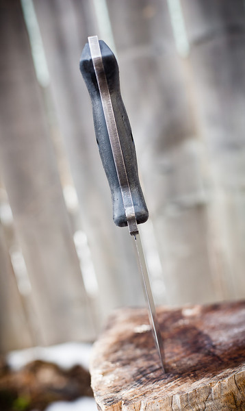

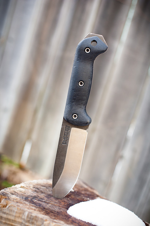

So I received my BK2 some months ago and kept telling myself that I needed to get rid of that black coating. Don't get me wrong, it's nice with the coating but I kept seeing folks with stripped Beckers and thinking "Man that looks badass" so I finally took the plunge. I went and got some Klean Strip Sprayable Stripper at the recommendation of some post here in the Becker forums and went to work on it yesterday. I used a plastic paint tray and some good gloves and safety glasses, sprayed it on and waited 15 minutes. I used a plastic scrapper as not to scratch up the metal too much and had most of the paint off in about 10 minutes. Did a couple touch up sprays for some of the hard to remove spots and was done in about 25 minutes. I thought about sanding it down and polishing it but I quite like it the way it is now. I still need to throw a patina on it but this looks good to me as is. I also decided that the handles needed to be roughed up, just feels too smooth to me. I was worried about over doing it and making them uncomfortable such like a soldering iron for drill so I used a wood file and just lightly scruffed up the surface. I gotta say that they feel great! They actually almost feel like a micarta texture, gripy but not abrasive. I also sanded the paint off the hardware, took about 5 minutes and saved me a trip to the hardware store for now. So.. I loved my BK2 before hand but now I really love it! Here are a few pics, I would have liked to take pics of the whole stripping process but my camera's not cheap and I wasn't going to take the chance of monkeying it up, which I'm sure I would have. If you keep putting off that mod, go for it! You'll be glad you did!

Awesome work, looks great. Just a little advice, if you want to put a patina on it, you will have to sand off the primer coat that we see here. That greyish looking stuff. Not sure what it is, but none of my Beckers have taken a patina until that stuff is gone. On a side note, the ones that I left that on haven't rusted yet either.

Looks good, I like the handle texturing you did. Looks kind of like wood grain :thumbup:

Thanks Moose, I was wondering if that was some heat treat remnant or something. If you say it helps prevent rust then I'll just leave it as is and see how it does. I think it looks pretty bitch as is.
Tknife, I never thought about it but it does resemble wood grain a bit. All I know is it feels good in the hand and I keep finding myself playing with it while watching the tube, better be careful:-D
