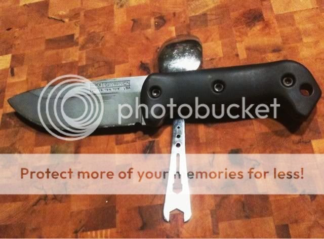

My only tips are to use the spray on Kean Strip brand stripper that says it works in 15 minutes because it does! The coating didn't bubble at all and I actually thought it wasn't working until I took one swipe with the scrapper and the caoting came right off. Get some decent gloves, i had cloth gloves that were coated in latex, the stripper eventually started to seep through and I could feel a light tingle, luckily I was done by then. Another tip is to pick up a plastic scrapper, that prevents you from scrapping the metal. Other than that there's not much more too it, very easy actually. Hope that helps and happy stripping

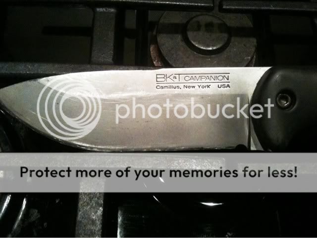

the blade mod looks real nice!
Thanks guys! GoNadz, I'm glad you have something pretty to look at one your desktop while waiting for yours
As for the handles, I have used both the BK2 and BK9 since modifying the handle like this and I feel it's definitely an improvement in the handle. Very gripy without out being to course, no worry that heavy use may bother you hands.
