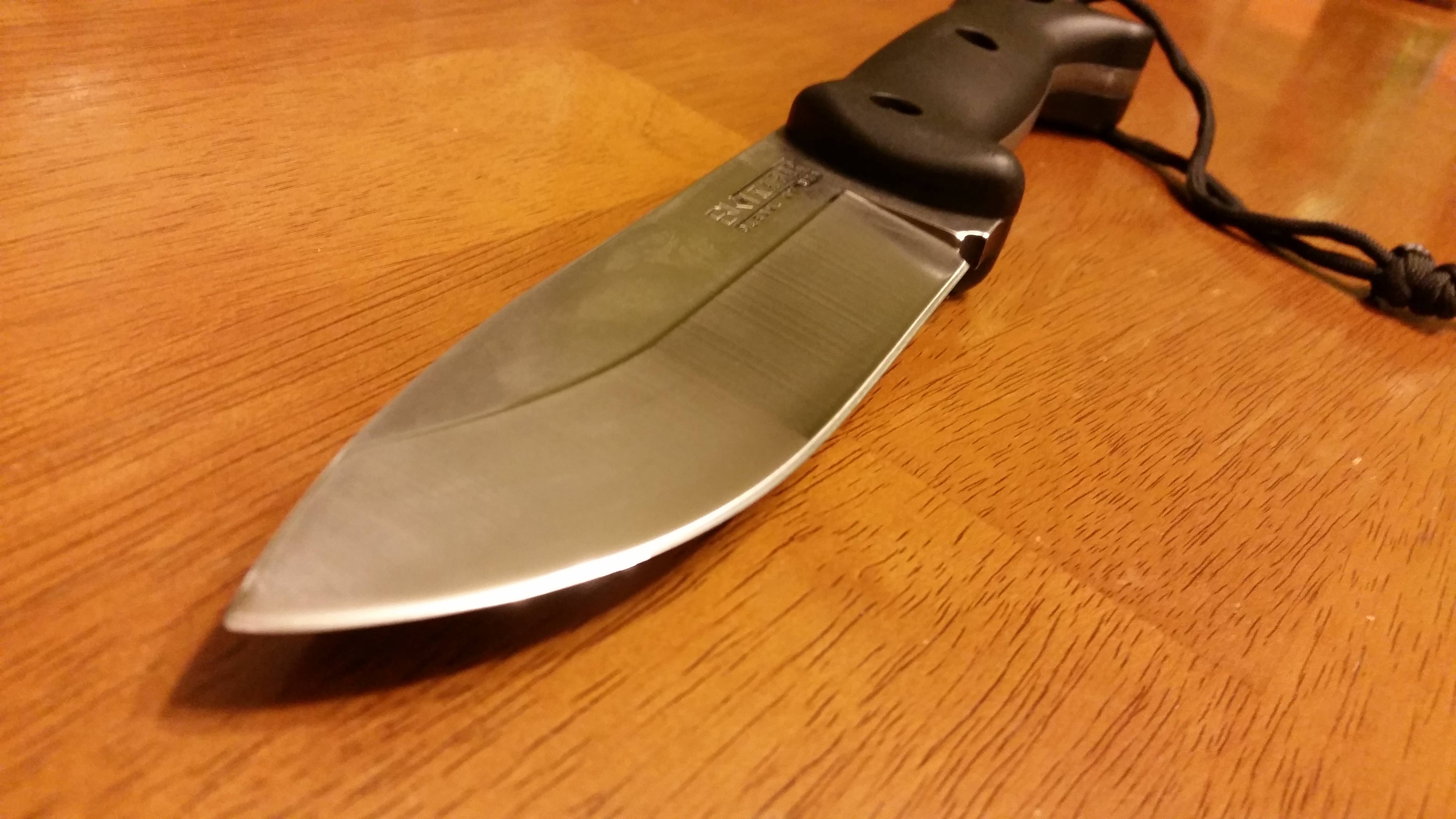

For me, the hardest part was finding the correct angle that worked for me..I have no idea what angle Bark River sharpens these at though I found website that suggested to strop these knives at 13 dg which seems rather shallow.

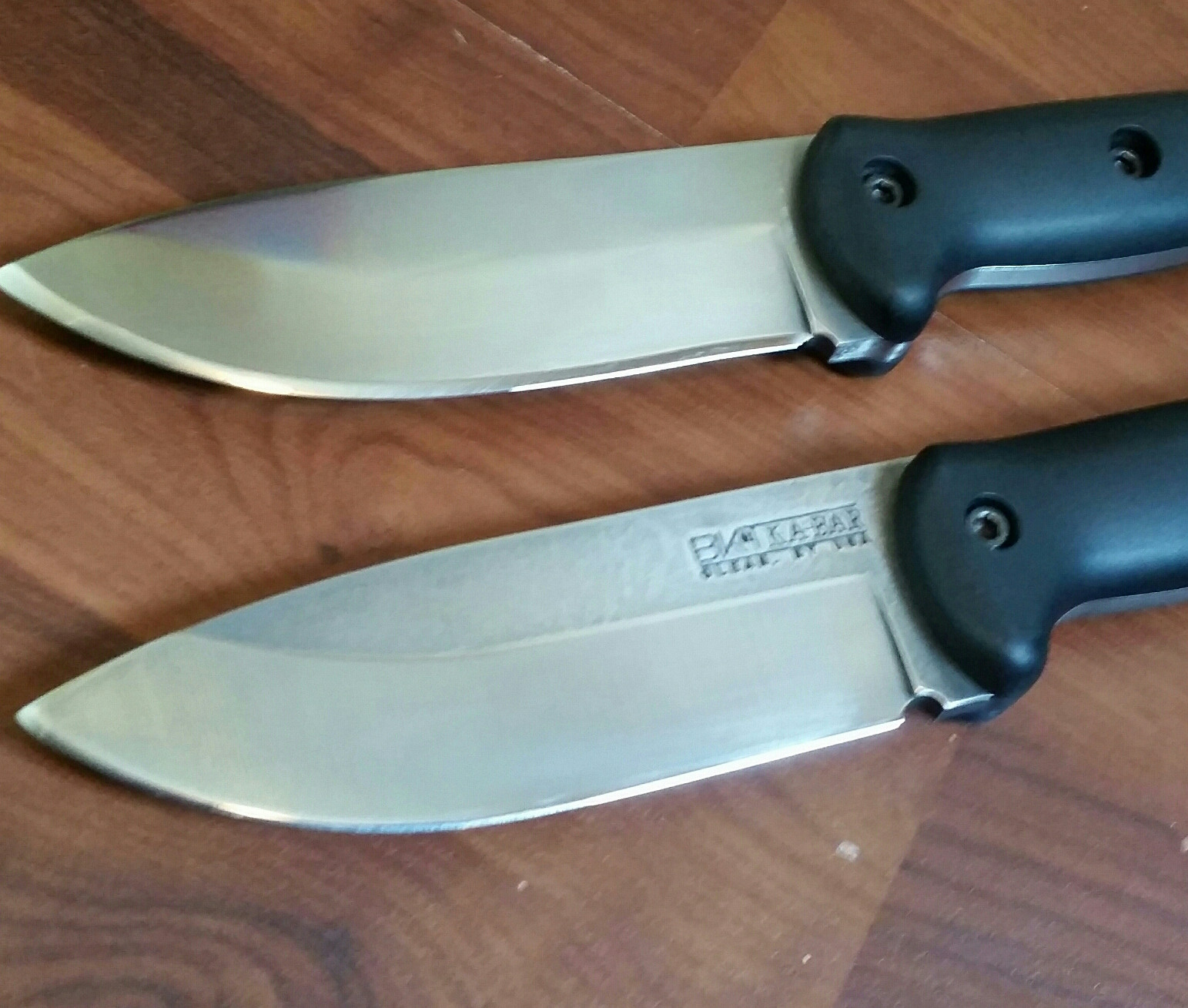

Also since you have the ko work sharp you should look into getting the blade grinding attachment for it. It yields far better results, is much easier to use and more versatile. The regular version imo removes too much steel and you almost always end up with a high ground bevel. With the blade grinding attachment you can use as little or as high of pressure as you want for the task at hand. So you can cleanly match a low ground factory bevel instead of basically reprofiling it. It would also make sharpening and touching up your bravo 1 much easier.
Here's a picture for reference. The stamped bk2 sharpened on blade grinder, other is with stock set up as it comes...can see bevel difference
glocke12, I have experienced having to go with a higher angle as well. You cant really set an angle to strop at with convex grind knives, its more about feel.
If it's just Bark River knives that you are doing this with, I have had a bit of micro-convex beveling on a few on mine, more noticeably the 3V blades. If you relieve the micro bevel, to a zero grind (I just used a coarse/fine DMT duofold on mine) , you can get back to a lower stropping angle. Also, i have found, using a hard backing surface (wood, stone) makes it a lot easier and sharper quicker, with less worry of rounding the edge.
