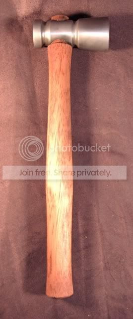

I like the style of this hammer..it mushrooms on one end. Anyone know where I can find something similar?
I have never seen them available on the web anywhere but I have made a couple. A metal lathe is not really a vital knifemaking piece of machinery but it really helps with making specialty tools. Most certainly if you can't find a tool anywhere.
I use mine quite a bit for forging and it moves smaller steel out in a 360 deg direction with the exagerated domed face. It also self corrects with most of the weight on the bell face.
Machined from 4142 with teak handles I turned.

Well Tai's hammer has an exceptional balance and I like the way it flairs on the one side. I think tai said it was around 2 pounds.
