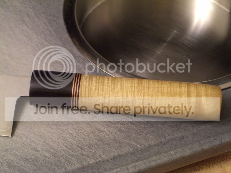

well, i am assembling my Jantz santoku knife with a horn bolster, copper and black spacers and the balance of the handle is fiddleback maple. what kind of finish do you guys recommend for a finish on the maple? i was thinking mineral oil, like a cutting board, but that gets pretty dark. what do you use?
heath
Stabilized Maple. Stabizing really is the most practical, no finish needed, no worry about getting it wet. On that don't buff a 400 or 600 grit finish is good so as not to be slippery.
If you put danish oil on it, you'll have a more durable coating for a kitchen knife. It will probably need to be touched up about once a year if it sees regular use.

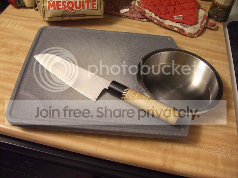

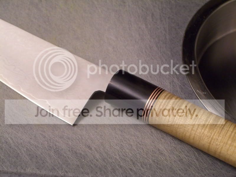

i think it came out really nice!
I often use linseed oil, but there's an old navy trick called "123" which I'm trying to remember since I want to play with it- I *think* it's 1 part linseed, 1 part tung, and 1 part marine polyurethane. It's the last one I'm not sure about.
