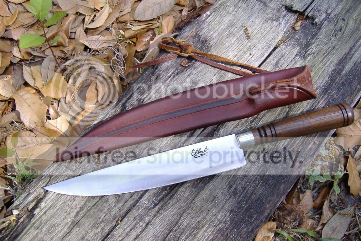

I finished to 220 grit using Norton Ceramic belts (which are really fine, seems almost like a 320 grit) and buffed the blade using green chrome compound. The steel is D2, hardened to HRC 61.
It gives you a mirror finish, but you can still barely see "polished" scratches (they are really fine scratches, you can only see them if you hold the blade up close, at a distance of 12" or more it is a mirror). If you run your thumb nail over the bevels you can't feel anything.
I'm thinking of polishing it with a hard felt wheel instead of the loose buff that I'm currently using. I'll let you know how it goes. I kinda like the look of it -sort of a mirrored, satin finish.
Here is a picture of it:
I take most of my blades to 600 grit. But recently I did my first two knives using D2, and I finished them to 320. Partly because with all that chromium, D2 should resist rust better, and it was more difficult to handsand, and I just didn't feel like going through all the grits. I like the look I ended up with, though.
The knife in your pic looks fine to me.
