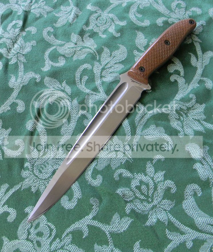

I've taken to finishing flat grinds lengthwise on a platen. While it is common knowledge that I sell platens here, you can utilize this technique with any platen to get a head start on your hand sanding or eliminate it completely.
There are aspects my process that apply to grinding against a platen regardless of lengthwise or conventional. Of particular note is the belt I'm using and what I've done to it.
This is a 320 grit belt finish that is as clean as a hand rubbed finish:
http://i566.photobucket.com/albums/ss107/Nathan_the_Machinist/062113/3_zpsf309616d.jpg~original
This is from a post elsewhere where I describe my process. There is some hard earned knowledge here:
snip
For the final finish pass I like to double up two belts so it has a bit of give. This will give you the smoothest most even finish. A clean 120 grit grind doesn't look rough and a clean 320 grit looks slick as hell.
I like the yellow Klingspor 312 J flex belts. Other belts I've tried tend to gouge and gall when a bit of grit pulls free. It goes without saying, use fresh belts.
In order to run two belts at the same time you're going to need to stretch a belt. Take a new belt and put it on the grinder under high tension and run it and get it soaking wet. Once it runs a little while it will stretch so you'll need to stop and pull your attachment out and run the tension up again. At this point it is stretched. You'll want to go ahead and rub the grit off the belt splice at this point to prevent splice bump from showing up in your finish. I use an old file. You can then take another belt like it that hasn't been stretched to run inside of it and they'll run together that way.
