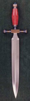

Danbo,
After a long search, I finally found one just for you :)
Coral, colored titanium, and 2000 grit finish :D
Kit, that one doesn't bend in the middle :p Very cool dagger!
