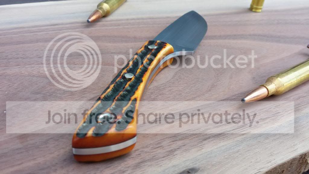

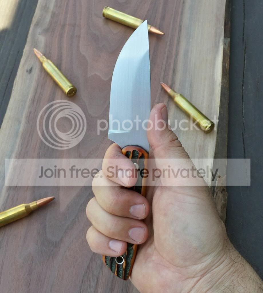

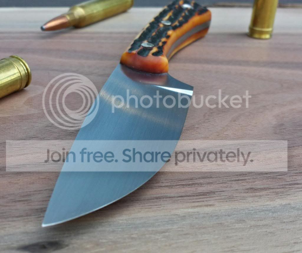

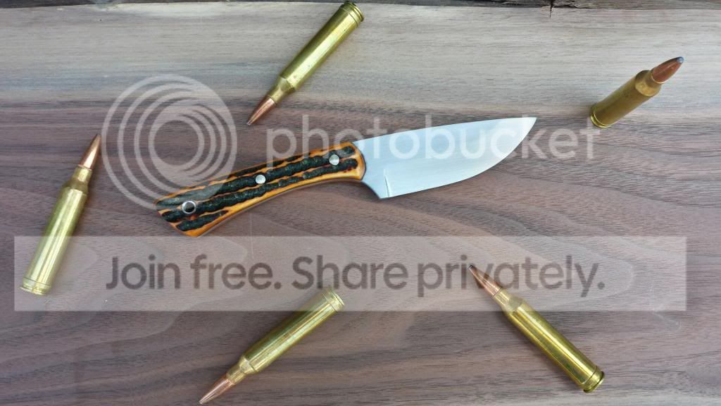

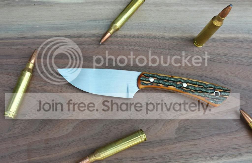

Ok this one gave me some fits. Started out I sanded all the scale off from heat treat and decided to do a black etch on the blade. So I soaked it in ferric chloride and then boiled it in trisodium phosphate to neutralize the acid. The flats came out black like I wanted but the bevels not so much. After sanding it all down again I thought I did not get all the decarb scale off tried it again and was just not satisfied. So I epoxied and pinned the handles on and got them shaped. Then I decided to cold blue it. It looked ok but just not what I wanted....more sanding!!. You can see some of the cold blue right up by the front of the handle I could not get sanded.
Next problem I had was trying to peen the pins the high points in the carved bone did not allow my hammer to get in all the way so could only go so far and I may have left the pins to long. The lanyard tube was a first for me too. Overall I like the design of the knife and it seems like it will be a good user. I'm still learning so this is all good experience.
Anyways here is the knife and specs.
80CRV2 high carbon steel
Overal length just shy of 8"
Cutting edge 3 1/4"
Handle is dyed carved bone
Nickel/silver pins and lanyard tube
All done with files and elbow grease
I still need to put final edge on it and make a sheath.
Let me know what ya think.
Thanks for checking it out
Justin
