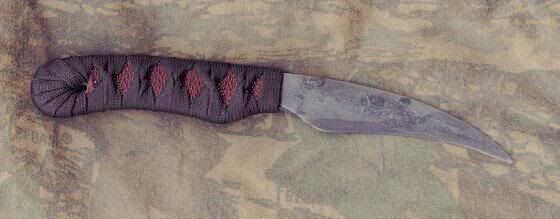

Finished another cordwrap

Finished another cordwrap today. Not the greatest pict, just used the scanner.
Better picts later.

Maybe not the greatest pic...
but a lovely wrap.
I took the liberty of lightening it a bit so the wrap can be seen by many to enjoy.
(pm me if I screwed up in doing this)
Gosh I do like good wrap :)
Tom
Very nice! I always like looking at nice cord-wrapped blades. :)
Good looking wrap. What "cord" do you use? I have used ito (expensive) and also athletic shoe strings...
The epoxy I have used is too shiny.
I have wrapped two sword handles and two knife handles. I am looking to do some more utility-type handles in the future.
I use a marine epoxy from west marine, the 105 epoxy and the 206 slow hardener. Just paint it on and leave it alone till tomorrow. Works great.
Larry

Thanks. I will give that a try.
