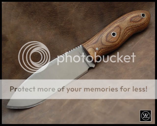

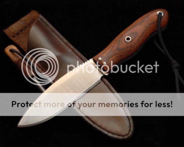

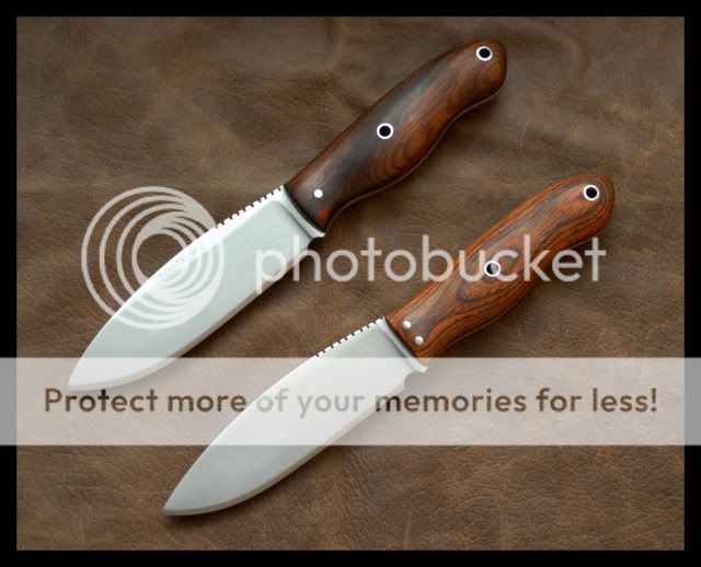

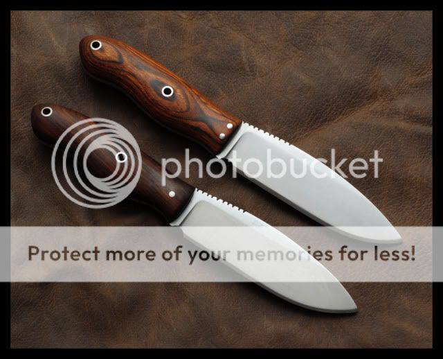

I like the knives and the sheaths. They look very well done and have a unique style. The sheaths are great, and I might add that your photography is darn good also. I would, however, caution about putting pins too close to the outside edge of any handle material, it makes it easier for the handle material to crack. I am thinking specifically of the two at the front of the dymondwood scale. I always like to keep the pins about 1/4" away from the edge if possible. Just my opinion, and that knife could last several lifetimes with no problems.
