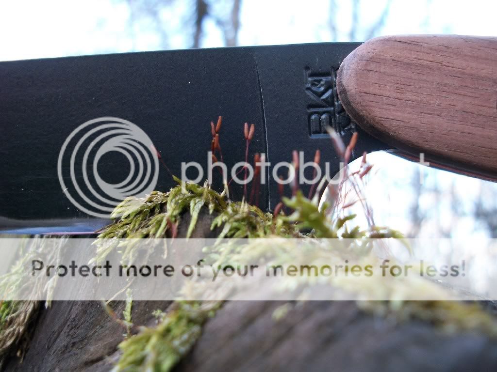

(Finished Page 3) WIP Copper Liners & Wood Scales for my BK14
Thanks guys. The copper was not as hard to work with as I had anticipated. If any of you are contemplating giving it a try I say go for it. The hardest part was just pounding on the pipe to open it up then hammer it flat.

Hey guys I slimmed down the handles today and now it feels great. I also heated up the bolts so they darkened and would not contrast so much with the blade. I took some more pictures, these ones are in sunlight so hopefully they are better. I will post some more once I seal up the handle. I have decided on using the superglue method. I will most likely make another thread on that but ill put some pictures and a link to it here.
Let me know what you think of the slimmer handle and the bolts. Thanks for taking a look at my little project :-)
