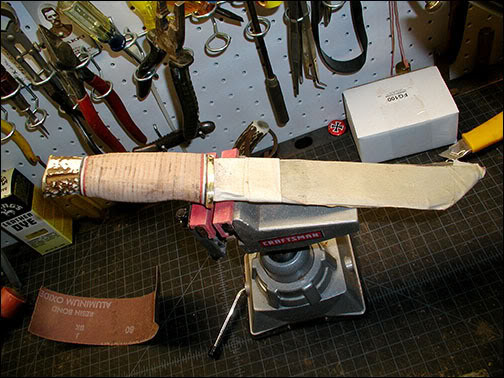

Thought I'd post this here...my first successful leather handle with bocote... (the first-first is in my bag of failed scales). Not glued up yet. The handle is sanded to 1200 grit in one direction. the BF google had several methods to finish. My plan is to finish by damp baking at 170 degrees F for an unknown time to harden it up a bit more, then apply warmed up beeswax followed by a clean buff (no compound). If there's a better way I'd be much obliged hearing about it. Thanks in advance!IMG_1895.JPG IMG_1896.JPG IMG_1897.JPG

Howdy Do Redmeadow Knives Redmeadow Knives Yes please either here or PM your method if you prefer, I wanted to harden it up enough to be pretty solid as a knife handle, I've been trying to follow what I've seen in the BF google search threads. The baking went well enough and I scrapped the beeswax idea in favor of oil. It's looking OK and I'd like to try the CA if I can find some thin enough to paint on. Meanwhile, I noticed some surface faults in the leather so back to the grinder for some light refinishing. Not sure if that was shrinkage in the oven or if I just missed during QC. It never really showed until it started getting shiny. Currently at 1200 grit one direction sanding with just the oil on it.

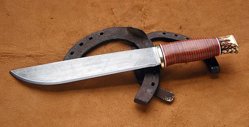

I've done 2 leather handles on "kit" blades. I followed the Brisa tutorial.... essentially cut the square washers to match the tang. Stack them on the tang with epoxy on each piece. Then clamp tight till the epoxy dries.
Sanded to shape and finished with 1500 wet sanded.
Once that was dry I buffed it with a rag, warmed the handle with a hair dryer and applied SnowSeal, rubbing it in while the hair dryer was blowing on it.
Then, when cool, buffed with a clean rag. Probably close to 10 years now with no problems what so ever....

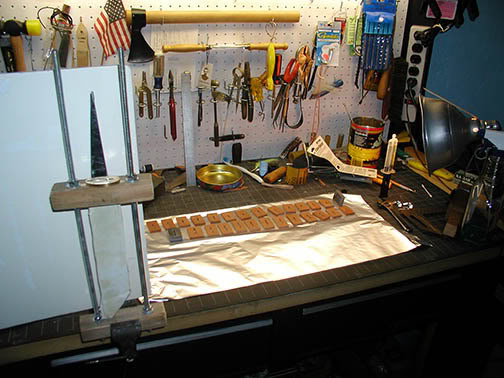

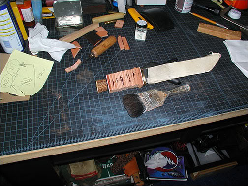

Hi Ebbtide Ebbtide Beautiful finish on that one! I found a link (now dead) from brisa.fi (finland) but anyway it sounds like our processes are similar. I did my glue up over the weekend and it's pretty decent, multiple coats of oil darkened them a little more but aside from a couple of minor issues I'm fairly pleased. It came out dead straight, even with the guard and seems tough enough. I guess I'll wax and buff and see what that looks like. Thank you all for your help!
The first photo has the clamp made with all thread and three pieces of wood. Wing nuts to tighten it down.
Should've mentioned that in the first post....
