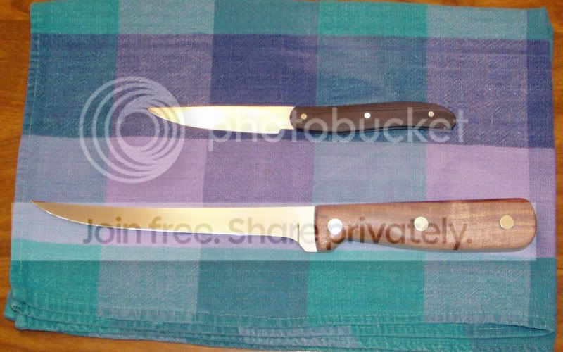

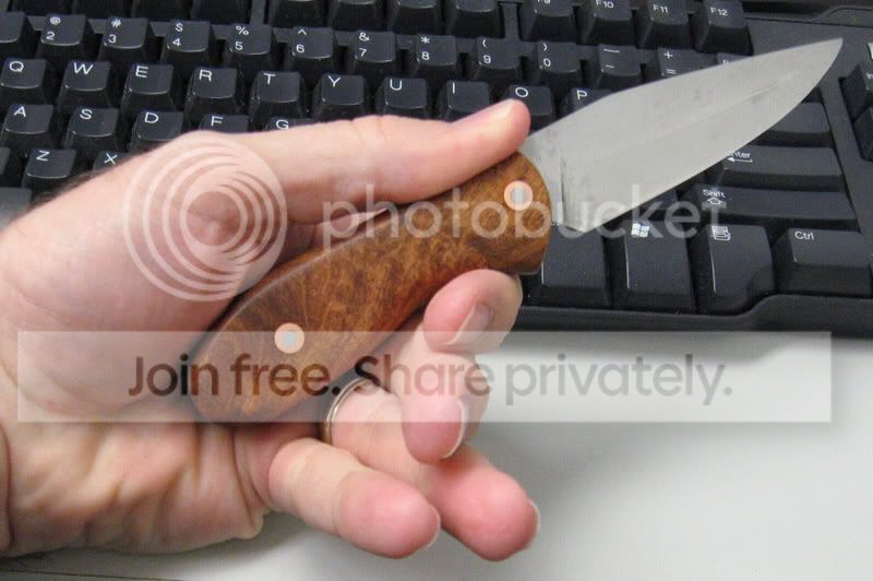

I think one of the benefits of stabilizing the mesquite is that it will help stop oxidation. The wood darkens with age if it's not sealed.
600 grit finish, then sand in (still 600 grit for mine but you can use finer) Watco Danish oil until it doesn't absorb any more. The first time might take a half hour or more. Wipe off to remove sanding dust and then wet again with clean cloth. Wait overnight without wiping off excess. Check. IF it is tacky/sticky, repeat and wipe off after a 15 minute soak. If not tacky/sticky, repeat first step and leave wet overnight again. Repeat until it won't absorb any more...that is when it will be tacky to the touch. I use oil wetted steel wool for getting the last (sticky) coat off, then wet it with a clean cloth and wipe down lightly. Let cure for a week before heavy use as the deep oil takes time to cure fully.
Results:
