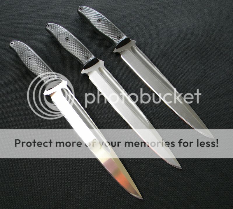

Here is a piece of Micarta that took some buffing to get a decent glow...first with green chrome compound and then with a white compound called 5100 which I was told is akin to 1500 grit. The scales felt smooth but might get slippery. I don't know for sure because I sold the knife. I really like the linen Micarta for knives that are used for hard work. Larry

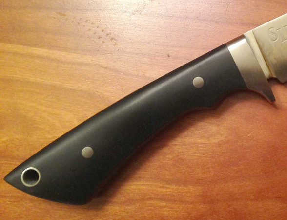

The one on the left is machine sanded to 220. The one on the right is machine sanded to 400 then hand sanded at 400. Then it is buffed with pink scratchless compound. The buff makes all the difference.
The one on the right just seems nicer. Richer. Nice to have options.
