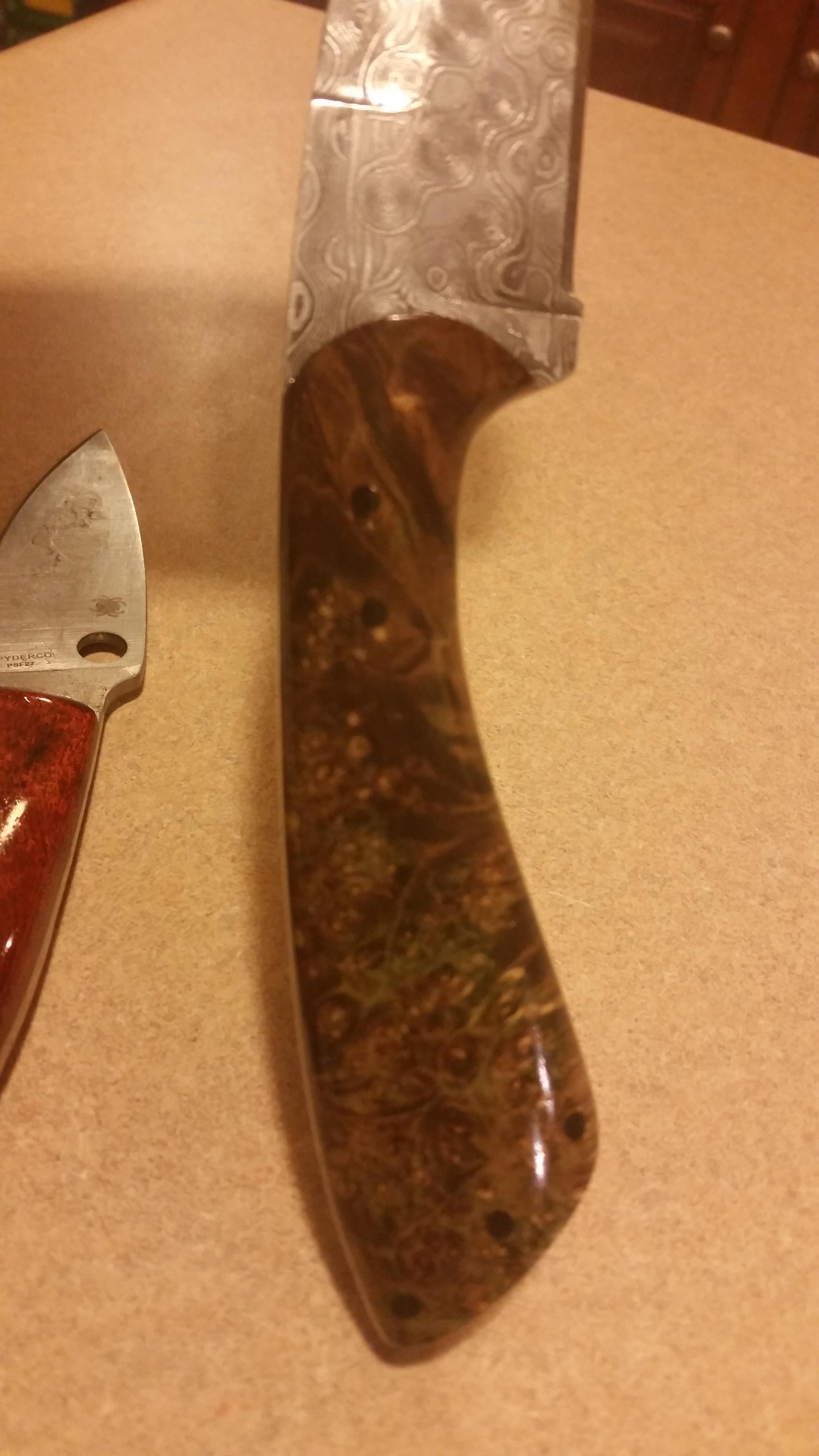

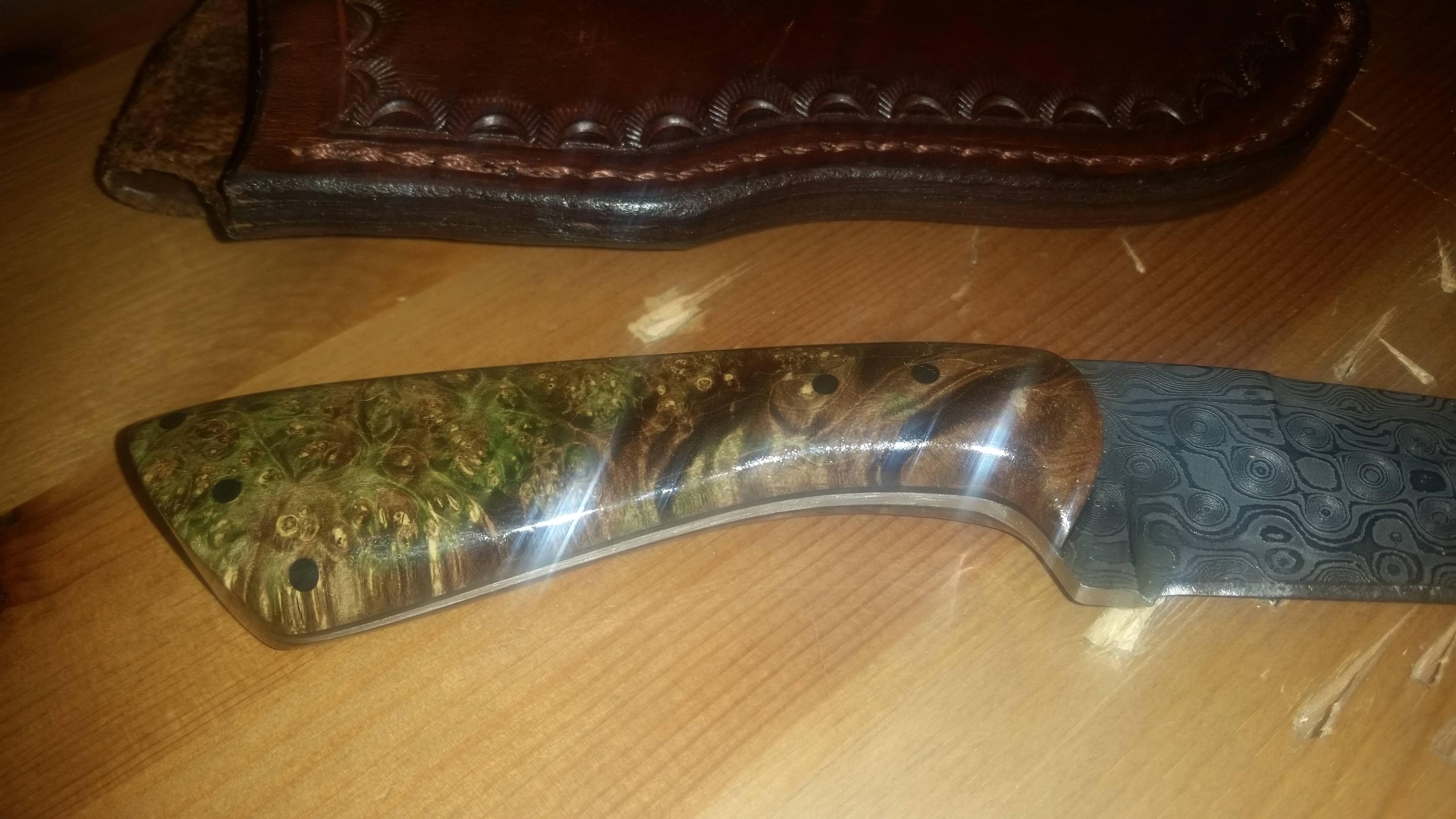

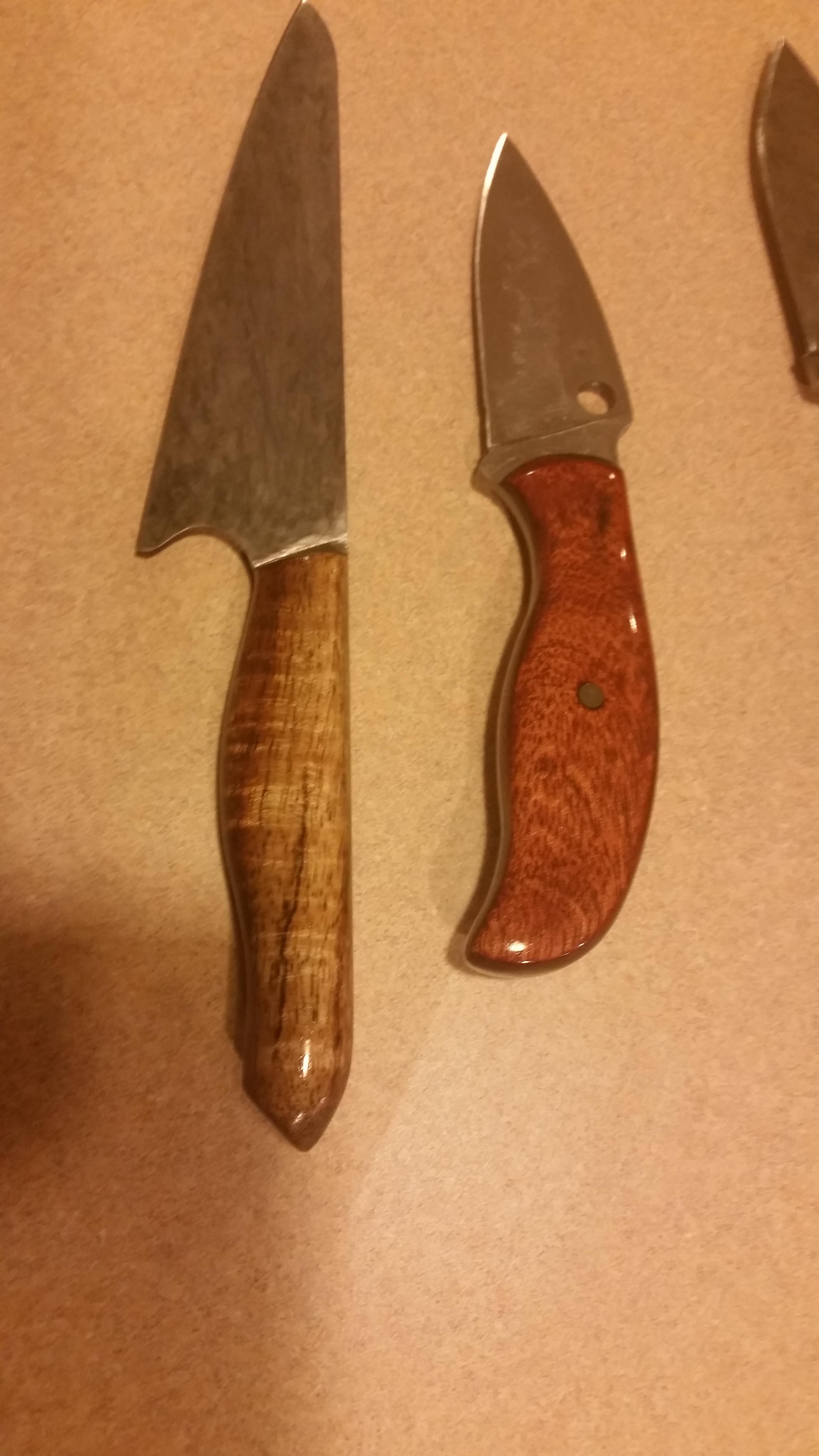

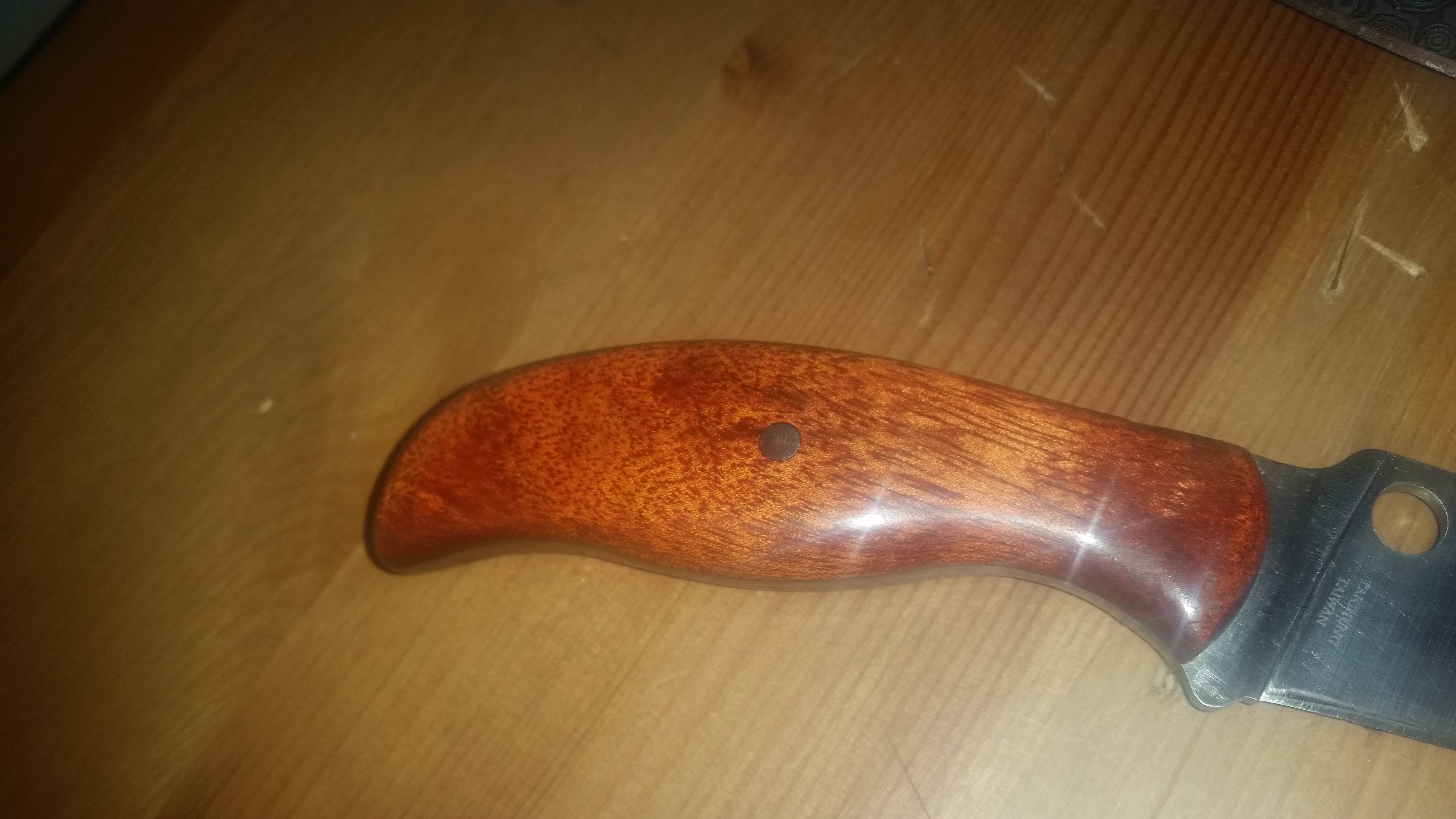

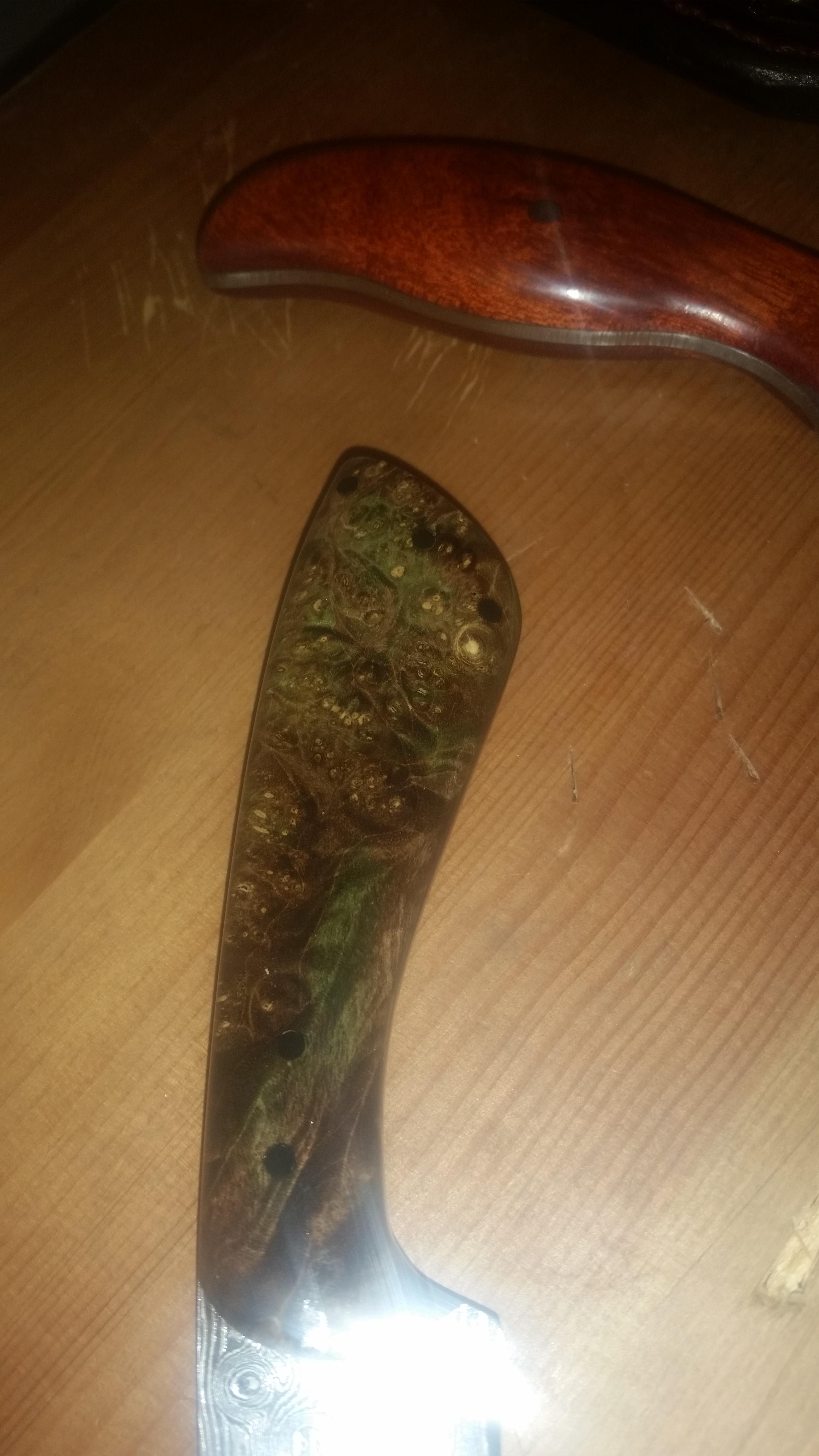

I have to preface this by saying I don't know really anything about this stuff. And thank you for the tip about the vasoline on the blades. I just dealt with that and spent more actual time sanding the Tru oil off the blades than applying it to the handles.
As far as getting a goopy mess if applied thickly I didn't get that. I sanded one stabilized piece and one unstabilized piece up to about 2000 grit. I used maybe three or four thin coats on each letting each coat dry about 2 hours. I then applied a thick coat to each, enough to have stuff dripping down the blade after I applied it. I let it sit for about 8 hours. I then checked to see if it was still tacky and it wasn't. I then used a 2500 grit piece of paper and lightly sanded each down, just enough to even the surfaces. I then applied another pretty heavy coat and let that sit for about 8 hours (Overnight). The first thing the next morning I used a piece of scotchbrite and lightly rubbed it over the surface. I then got an old clean t-shirt and applied one last light layer. The results are pretty freaking outstanding. The Tru oil brought out some really serious detail in the stabilized wood that hasn't been there since I bought the knife and it stepped up the chatoyance several notches of some cheap bloodwood scales I put on another knife. In both cases the Tru oil helped and is pretty hard at this point. Glassy, almost lacquered finishes without being overly slick and it brought out some deep prettiness of the woods I put it on, more than hand sanding and buffing did, anyway. I'll post some pics in a sec.
Why do you need to apply an oil finish to plastic? What does it do for you? Just curious. Fine sanding and a good buff do the trick for me with stabilized wood.
The knife I just posted pictures of with the dyed and stabilized handles had been hand sanded from about 220 grit up to 2500 grit and hand buffed with 8,000 grit compound. It never showed the amount of figuring until I used tru oil on it. Its vibrancy, color, and depth are much more apparent in real life than I can capture with my crappy cell phone camera. I showed it to a coworker today and his initial response was 1) where'd you get granite that looked like that and 2) how the hell did someone make a knife handle out of it. Needless to say I'm now "under contract" to buy a knife and rehandle it for him. Not a bad way to make some money doing something I enjoy. I'm only charging him 15 bucks plus materials because I'm still rough with what I'm doing and it doesn't meet my own standards yet. I've finished 2 knife handles and refinished 2. That's pretty much zero experience, but I'm liking the results so far.

Didn't make that one, I just sanded some of the contours and played a little bit with the Tru oil. I wasn't sure how it'd react. Bill Akers made that one. There's not much that can be improved with that handle. I really just wanted to make it pop.
They're carbon fiber pins and I believe bad dogs burl source has some scales pretty similar to these. I'd post a link but I don't know if he's a supplier here.
