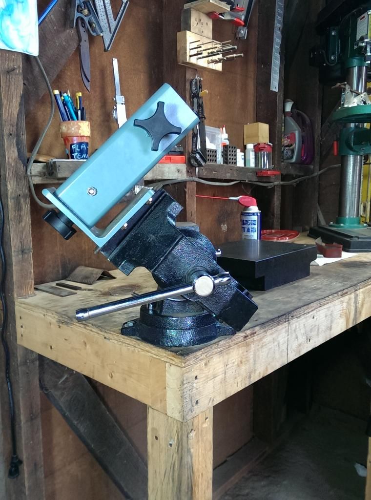

My knifemaker's vise is made by Chuck Ward and is distributed through James Neilson. It's identical to the one Stacy posted a link to. In fact, I wouldn't be surprised if they are the same vise.
http://www.mountainhollow.net/knife-vise.php
You can purchase a seperate mounting attachment that allows the knife to also swing in a vertical plane. But since my bench space is limited, I didn't go that route. I already had a multi-purpose 5" bench vise, so I just mounted the knifemaker's vise to a small piece of angle iron. In combination with my bench vise, it allows full access to my work. When I need it, I chuck it into my bench vise and I just remove it when I don't. So far, it's proved invaluable for my needs. My previous set-up to do handle work was pretty rudimentary to say the least.
