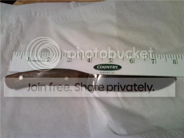

Here's a poor picture of the knife (cell phone - I can't find the good camera)

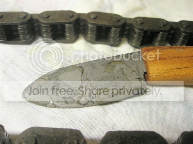

It was forged from a coil spring that is found on large trucks and is used as additional support on the shock absorber (or strut or whatever). Also, as previously mentioned the scales are QS Walnut.

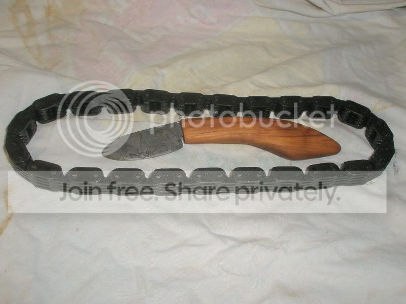

Here's a bonus picture of my first completed knife. It's my first attempt at damascus and I used a timing chain (similar to the one in the pic). The handle is cherry finished with BLO (Boiled Linseed Oil)
