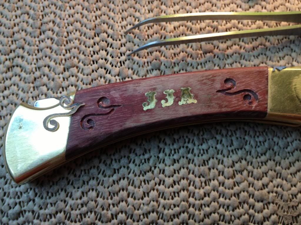

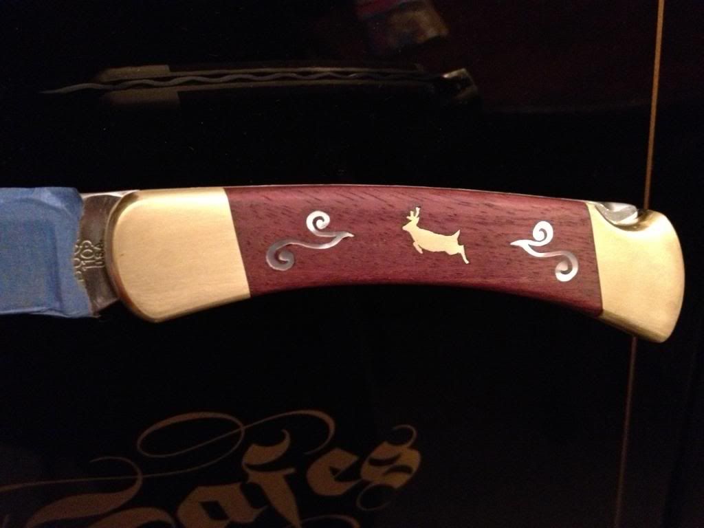

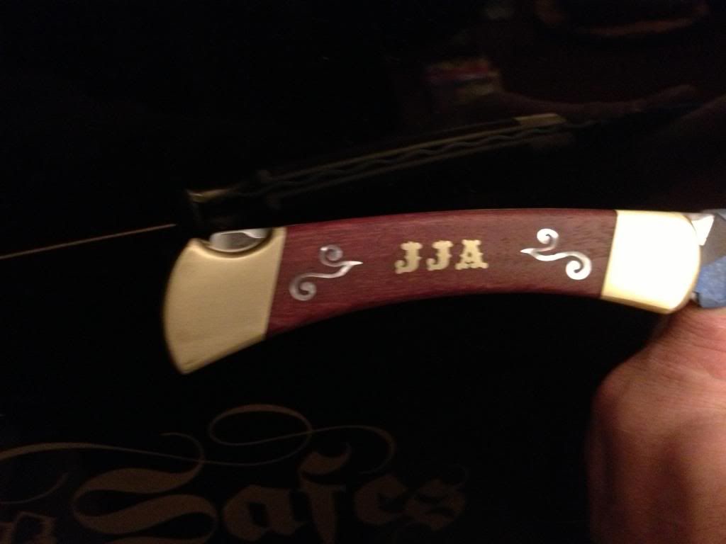

So after lots of research this past month I finally tried my hand at customizing a Buck 110 folder. I'm getting set up to do inlay and wood carving mostly on gun stocks but I love knives too so I figured I'd start with something small. I've found this forum site very helpful so I figure I'd ask you guys for some professional advice on a finishing problem I ran into.

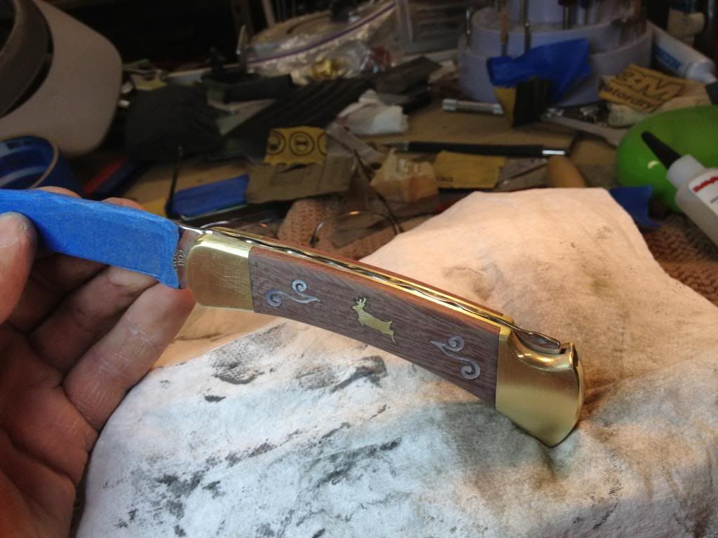

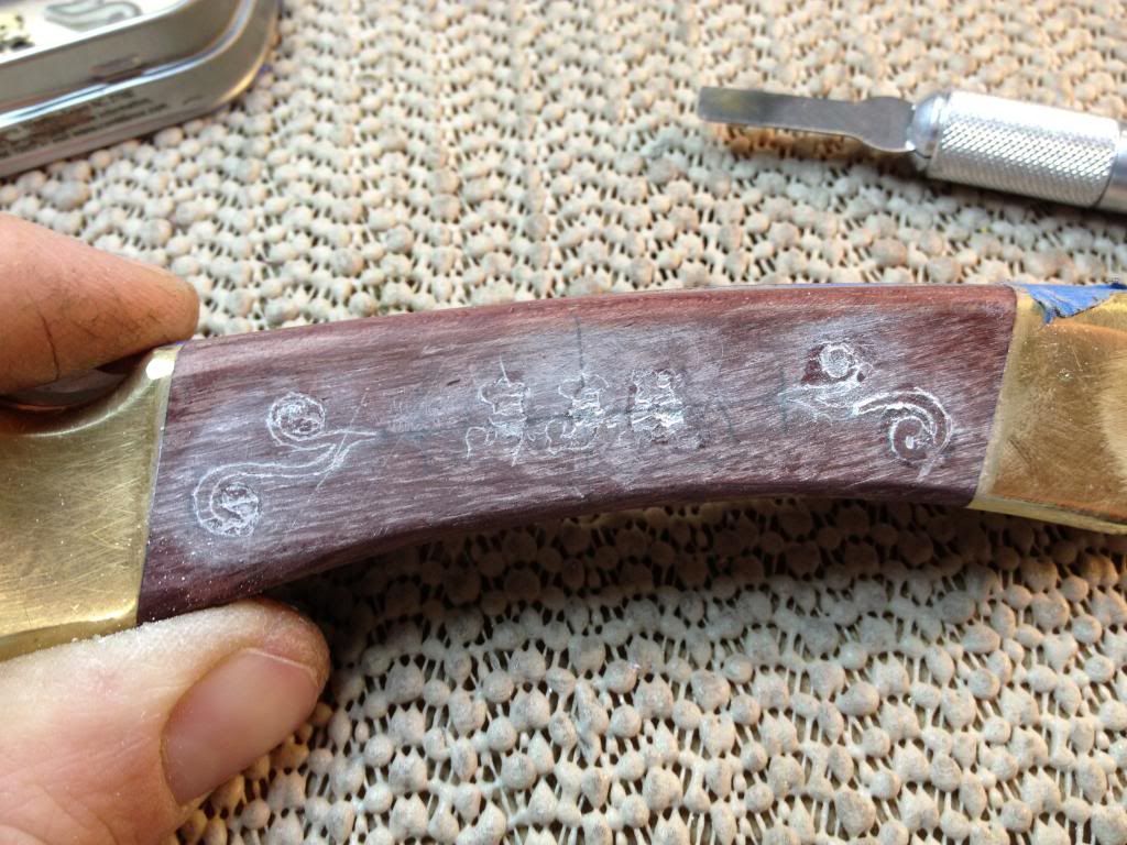

One thing I didn't anticipate when inlaying brass and mother of pearl into my new purple heart wood scales was the contamination of brass dust and polishing compound into the wood. I epoxied the scales on, leveled them, then inlaid my designs and then leveled the inlays. Now I had smooth scales but unfinished wood and scratched up brass inlay and bolsters. Using wet sand 320 up to 1000 grit I was getting a gold slurry on my nice unfinished wood so I decided to sand the wood and seal it with my finish (Pure tung oil, thinned). After sealing a couple times I tried to buff out the brass scratches but got that nice dark buffing dust into my wood...again. Used mineral spirits to clean it and do some more finishing but I can tell the dashes in the wood absorbed the dirt as they are dark. It looks ok to most people but to me I think it could be better.
So my question for a pro is what is the proper way to handle keeping the wood clean while getting a polished scratch free finish on the brass? I guess because I'm new here I can't post a picture that would help but I hope you guys understand what I'm getting at here.
