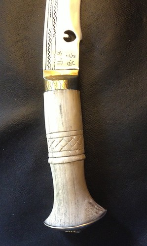

Also, can you use the same finish on horn that you use on wood?
Hi Maniacal Pete. Hand rubbing Tung Oil helps the oil penetrate and warms it slightly so it can go through a change in consistency letting you know it's time to wipe the excess off.
On Horn maybe. "As the penetrating power of tung oil is excellent and it will adhere to porous minerals, it is often used by stonemasons on granite or marble installed in kitchens, bathrooms, and other staining fluid environments. Applied at a 1:5 ratio, it seals the surfaces permanently, while also giving a finish like that of wet stone to the product.

So far the Natural colored Danish Oil is looking great on my Neem handled Chitlangi. When I'm done(when it won't take any more) I'll post pics.
I'd like to put it on my BAS and Ganga Ram, but I'm not sure how to go about it since I've been using mineral oil on both of them. Any suggestions? How does mineral oil effect Danish Oil or Tung oil?
Pics!
Before- Neem wood without finish
After- Neem wood with Watco Danish Oil, Natural
It took longer than normal for the Danish Oil to dry, but I really like the results. I'll probably add a couple more coats of Danish Oil to it as I go, but it really has a nice feel now.
