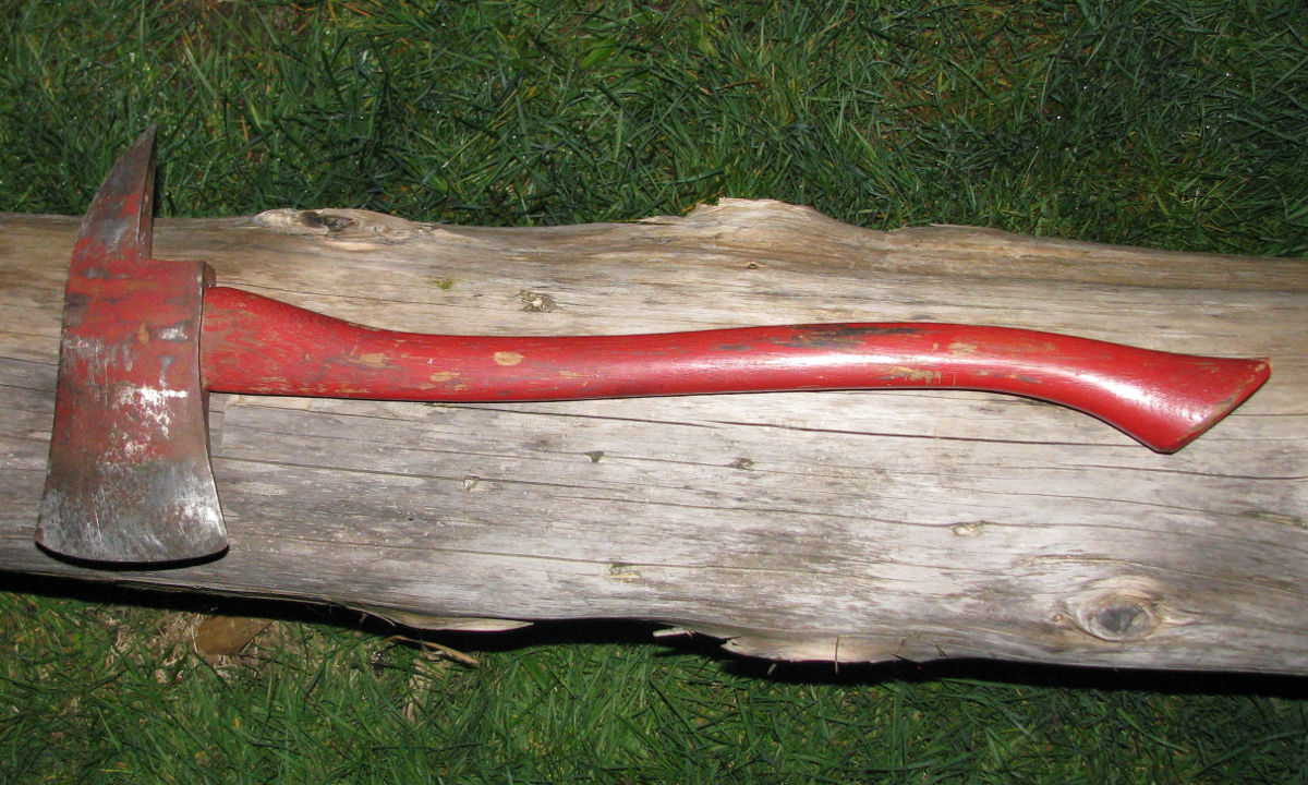

Fire axe head ID

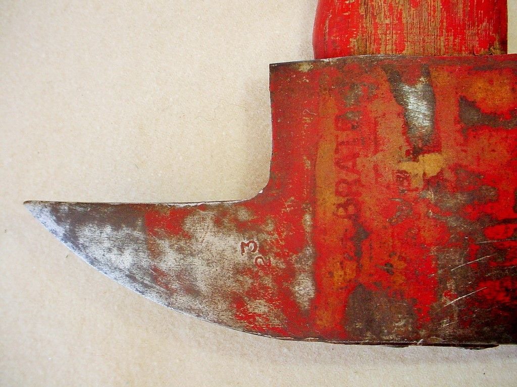

Interesting to see a Warren stamp of 2 3 being used to depict 2 3/4 lb. This substantiates Steve Tall's conjecture of awhile ago about fractional head weight stamps being a function of quarters (ie 3 2 means 3 2/4 lb, instead of 3 1/2 , as is stamped on many USA-made heads ) whenever the second numeral is elevated.
I can't take credit for that, since I read it somewhere. YesteryearsTools mentions it briefly:
My research points to Shapleigh Hardware, can I get a confirmation? . . . given it's age it is in superior condition.
What is its age?
Bob
No idea. . .
The "crucible steel" stamp might mean that it was made before 1930-ish:
Crucible Cast Steel: 1750 - 1930

The axe might also have been made in the 1970s.
Bob
i havent seen many pick heads but i'v never seen one with the pick chipped. thats a chunky bit of steel ya got there
