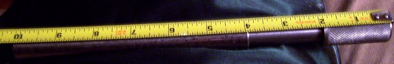

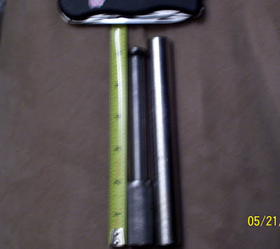

After reading about fire pistons and looking at some pics and watching some videos I asked my dad if he would make one at the machine shop where he works. I showed him some videos and examples and he said he would come up with something in his spare time. Fast forward a few months and he calls me and says he has 'this piston thing'. So I go by the parents house after work and get handed this:
(Sorry about the blur)This thing is a behemoth milled from unhardened A2. The piston is 6'' long and the chamber is a bit longer.

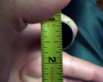

This is the diameter of the chamber.
And this is the length of the piston assembled and 'at rest' 10''
The piston has a nice spot drilled out for tinder, an o-ring for seal and a super snug fit. But I can not seem to be able to get any type ember whatsoever. I am usuing char cloth for tinder and have experimented with more and less amounts. Compression seems to be good because I have not been able to get the piston in all the way so that it 'bottoms out' at the top, where the cap is.

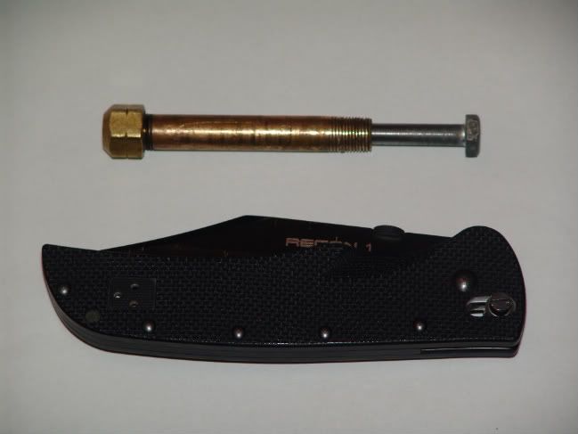

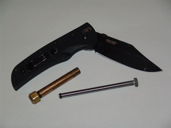

Metal works great! Heat flow properties aren't significant since the whole thing happens so fast. The problem here is size. The smaller the piston is, the better it will work. Nearly 3/4" bore is MASSIVE. I made one from some simple metal plumbing fittings, a bolt, and an o-ring from the hardware store. Bore is ~3/8" and the piston part is ~3" long. Make everything as small as you can. Also, when first learning to use it, try backing one end against a board or something.

Good Point. 3/4" is 4 times the cross-section of 3/8". The one thing we don't know is what the volume is of the fire piston cavity is when the piston is fully inserted. Can someone who has a working fire piston guesstimate what the initial and final volumes are? It would be interesting to find out what is a good compression ratio is for a fire piston. Also as CanDo said, when it comes to bore size, less is more.
As you note, the cross section is 4 times the area. While numbers are relatively unimportant to me as it is a "works or doesn't work" issue, here they are:
Piston shown in first post:
2.65 in^3
My piston
.331 in^3
The first has 8 times more volume uncompressed. Compressed, the volume of mine approaches 0; while it is cushioned it feels as though the piston may just touch the end of the chamber.
