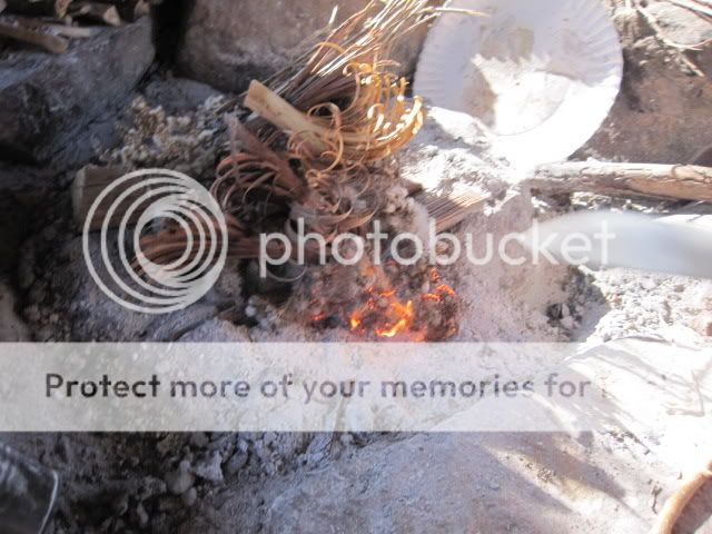

Hi all,
I like to build a little plat form on 3 or 4 sticks like in the is pic.
Then I like to put my fuzz sticks one them like this pic shows.
Then I stack my kindling on that in a tipi look. Like this pic shows.
Then I take my tinder, normally , it is cotton and pj mix and then wrap some around a stick to make a home made match so to speak.
then I will strike firesteel onto my cotton / pj mix that is on the end of that stick and start it on fire
and then put that right under that 3 sticks that are holding my fuzz sticks and kindling. in a no time at all I have a fire going.
That way is what I do most of the time.
I sometimes will put my tinder down on the ground and then put on some fuzzsticks and then just strike my firesteel next to my tinder to light it up and then the rest is history.
The tinder in this pic was a plant that light ups real fast with a spark. It in turn lit up another plant called goldenrod and once goldenrod starts look out. It will in turn light up the fuzz sticks in a hurry and then the rest of the kindling starts up.
That is what I normally do anyways. What KGD said works just fine to I have done that to. There are just so many ways to start up a fire though.
I then like to put some logs around the fire log cabin style or just lay sticks on chriss cross ways. Just depends ont what I feel like doing for that fire.
