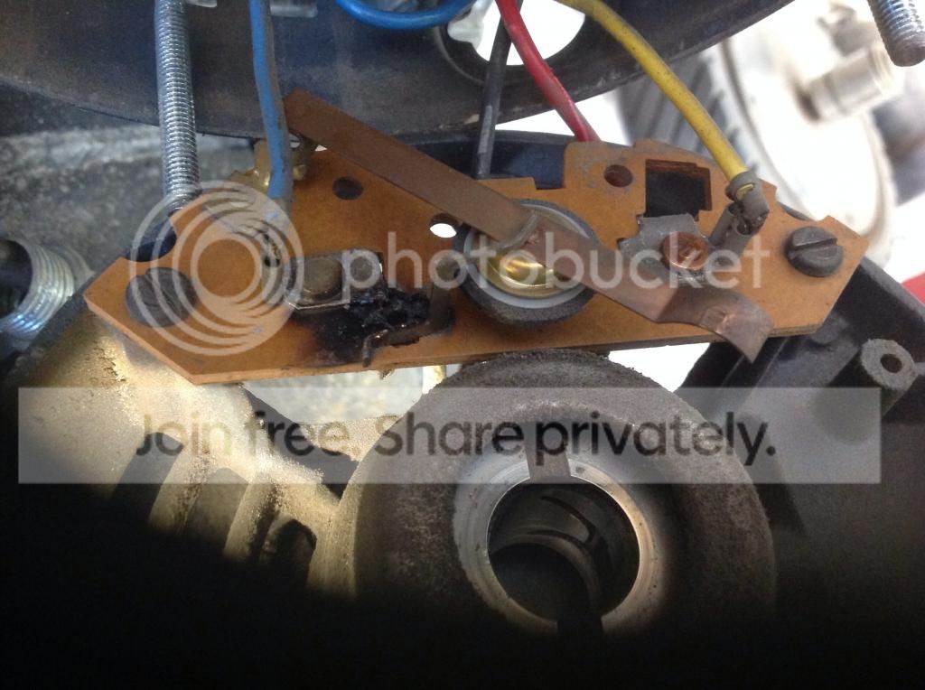

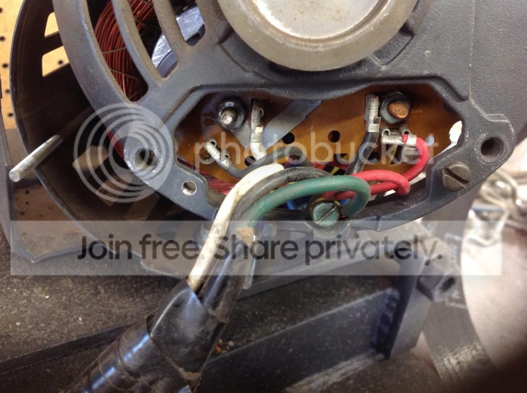

I'm not sure if I posted this in the right spot so move it if I didn't. Thanks. Well I was doing a little grinding when I had a flash from the rear of my motor. I pulled the back cover off the motor and found a burnt spot. I don't know a too much about AC wiring but I was wondering if anyone could help me out. The burnt spot is between the hot wire and what looks like a switch or contact. I'm not sure what caused it or how to fix it. The motor still works but I need to fix it before I burn it up. I don't see any bare or chaffed wires.

I can't understand that circuit from the pics but it looks like that burnt spot is something that shorted those two terminals, not a component that fried. I would clean it out and see if it works.
I was thinking that maybe it was dust build up that could have shorted it. The bottom pic is the cover just rolled down, so it's upside down to the 2nd pic if that makes since. The white wire in the 2nd pic is connected to the blue wire in the 3rd pic. It still works. How often should I clean the motor out? Shop air?

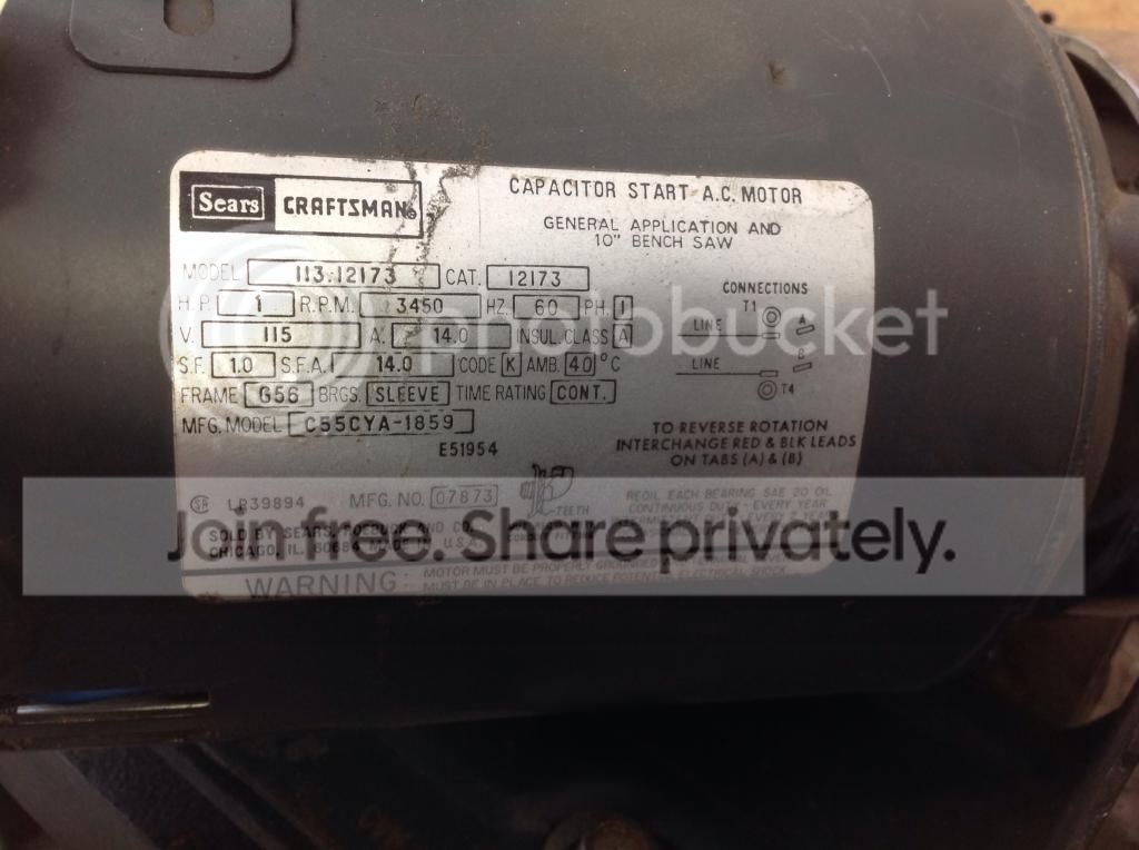

Your motor is an open frame motor and is not designed for use in a dirty environment. In fact, the label says that it is for use on a Craftsman 10" saw, which I presume is a wood saw.
You should use a sealed enclosed frame motor for metal grinding equipment.
It is very likely that metal dust built up to where electricity arced between those two terminals. You may be able to clean up the terminals and get it working again, but you should start shopping for a fan-cooled enclosed frame motor for the future.

I am not a single phase motor expert by any means, but I do think Mike hit on the problem. Metal dust built up around those terminals (centrifugal switch for starting winding) and shorted causing the fire ball. Most likely, just clean the area good, blow motor out with air really good, from both sides. Most likely be good to go again. Put a filter across the inlet side of open frame to prevent so much metal dust from building up again. Is this a true cure? Naw, not by any means, but it will make the motor last a good bit longer. Also, make a point to blow metal dust out from time to time. You might be surprised how long that open frame motor will last. I used open frame motor for over a yr on my 2X72 grinder and never had a problem. Did blow dust out from time to time. Location of motor to grinding belts will also enter into how much dust is collected by motor. How much grinder is used each day.
edit: is this a capacitor start motor? I see the motor is a 56C frame, got it mounted for direct drive? If so, that puts it collecting more dust than a pulley setup with motor well off to side.

It is a capacitor start motor and is direct drive. I am eventually going to buy or build a variable setup. I cleaned it up and just used it finishing up another knife. It worked like normal. We will see what happens from here.
