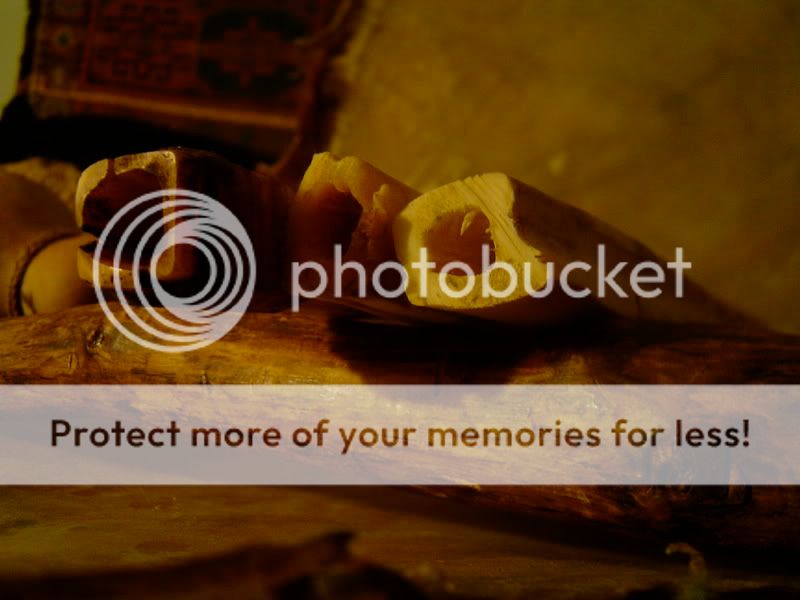

How did the micarta work for you? I've seen a few knives with a dimple in the handle, but none showing other-than-new or reviewing how it worked. It seems like it would be rather abrasive in nature - and that's a bad thing.

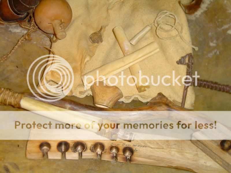

Do you have access to deer in your area? If you'd like, I could write up a bit on making a "wise-man's drill" like you see in the pic I posted. Very fun to do and far far far better than going at it with a straight stick. After using one of them for so long, I doubt I could go back to the old way. :D
Definitely try that maple for a hand-piece. I'm sure you'll like it better once the dimple glasses over and starts running like a top. With a soft wood, you're drilling at both ends of the drill and that's robbing energy from where you want the friction!
Oh, if I might suggest, drop the paracord for your bow. While it works, it also stretches as it gets warm and the round construction doesn't grip the drill nearly as well as a flat thong twisted til round and used. I use half-tanned buckskin/rawhide for my traditional set, but prefer a regular old shoelace for the regular kit. You'll find that the twisted thong will really grip the drill bit and transfer the energy from the bow a lot better.

Actually I liked the micarta a lot. I only got to start a half dozen fires or so with the one I got to work with but it only seemed to get really smooth inside, it wore nice and slick. I definitely noticed the friction on the head piece using the Poplar. If the cabinet shop down the street hadn't closed I'd get a few scrap pieces of hard maple, as is I'll be trying this Black Walnut just because it's handy.
Lots of deer in this area, just seldom go hunting much anymore...or yet anyway... so don't have any bone on hand. Wouldn't mind reading up on that wise man's drill of yours though...I do have friends and relatives that hunt regularly.
The paracord was just what I had on hand, I found a flat boot lace I want to try out.

The micarta worked well, huh? I wouldn't have figured it would smooth out like you're saying, but I'm not really familiar with the material. I'll certainly have to keep that in mind and might even incorporate the idea into one of my knives.

What you're looking for is the rear lower leg bone of a deer. It has a very squarish cross-section as is, and you're just going to square it off some more. Easy project for kids to get in on, too. Old bones work as well as fresh ones. I have bunches because I keep finding them and just can't seem to keep on walking!

Here's another pic since it's handy.
