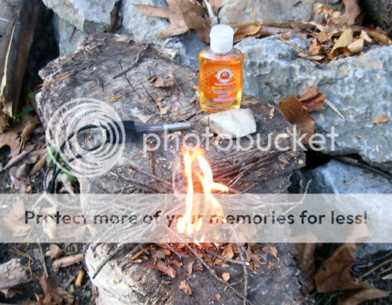

A while back, in the "three most important items thread", Rotte brought up using a firesteel without a knife. This evening I was limited on time due to work and didn't get to do any firecraft practice with my oldest because of a date. Soooo I decided to just play around a little. I do need to try this again with a piece of raw chert or flint fresh out of the ground but I did manage to start a couple of fires with a fire steel with no knife.
The first was simple, and cheating.... unless it's a survival situation...but it was still a learning experience for me so I thought I'd share it.

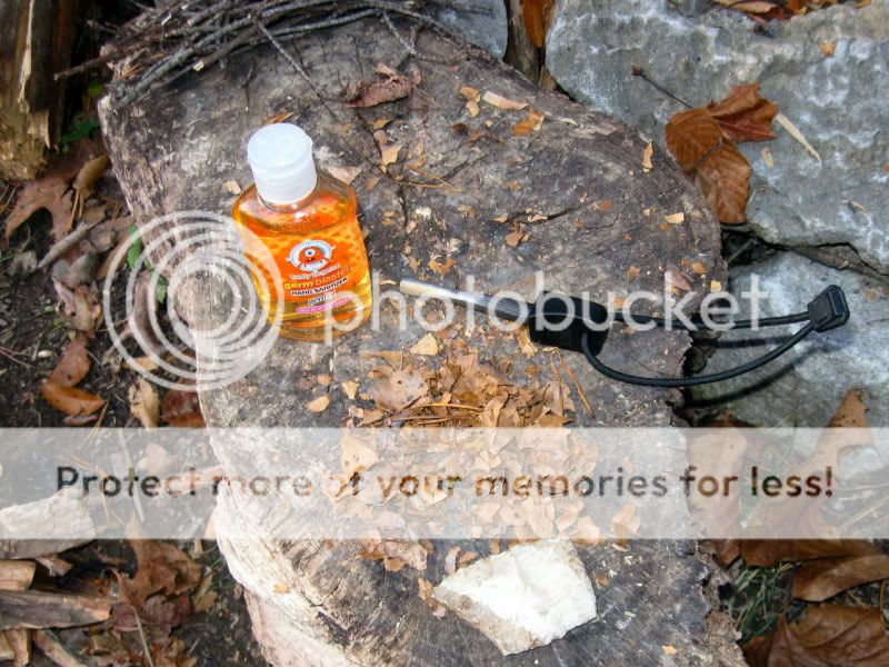

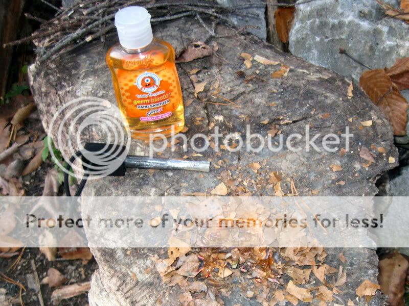

The first thing I did was grind up some leaves that were mostly dry but still have a high moisture content from all the rains a day or so ago and all the fog we've been having at night. Then I added a little hand sanitizer for an accelerant.
you can barely see the flames in this one due to the flash but they are there.
Soon they were reeeaally easy to see.No problems catching the dead pine on fire.

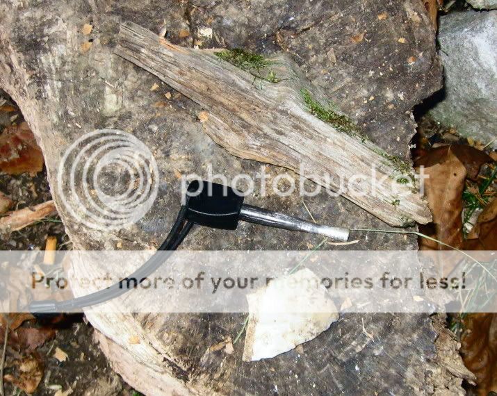

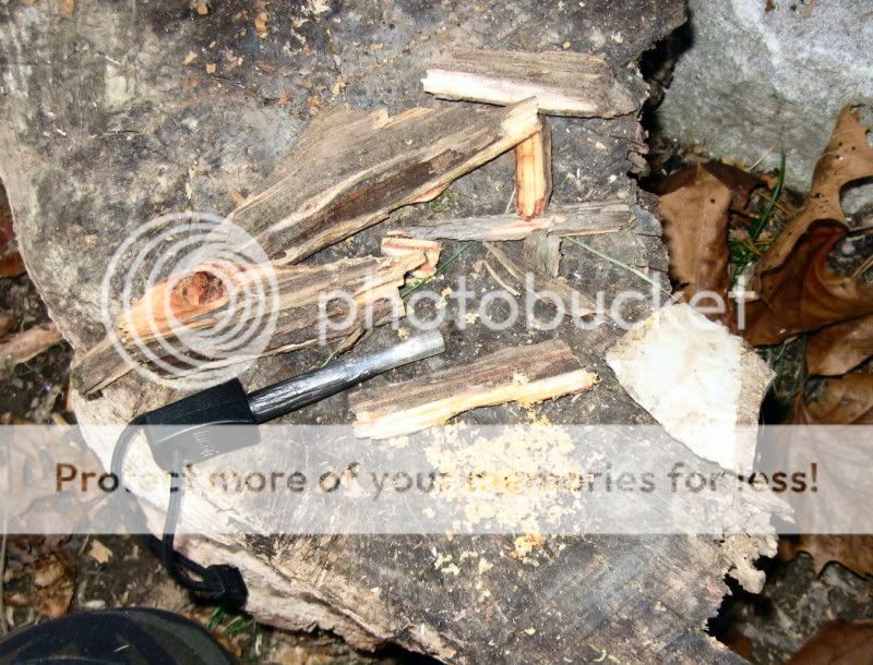

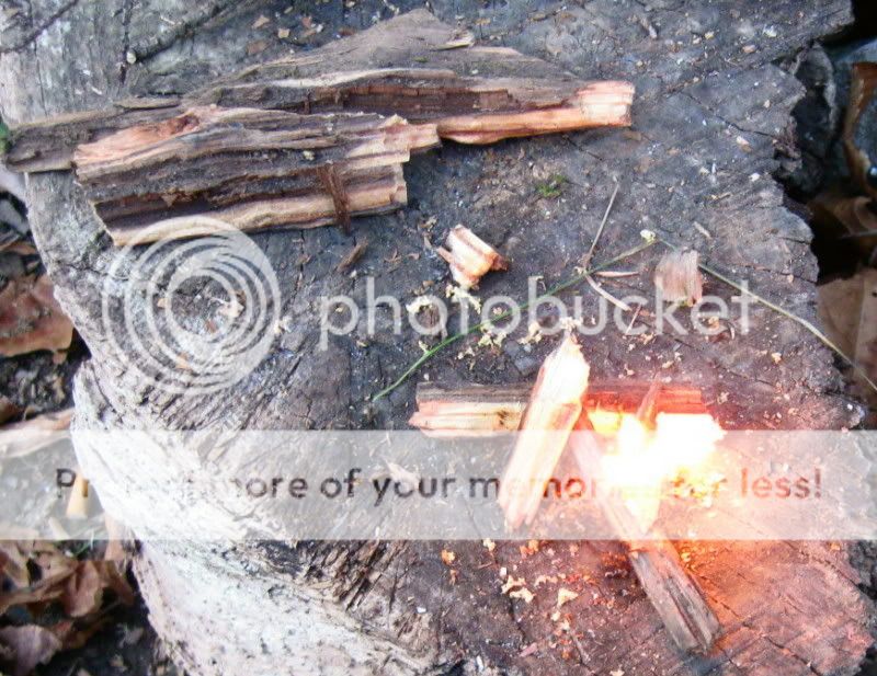

The second fire I think was a little more like what Rotte was talking about. I used a piece of fatwood I'd found, and the only prep was scraping off a pile of fuzz and then breaking it into as small of pieces as I could manage with my bare hands.

Out of curosity, was the hand sanitiser alcohol based? If it was, I can understand why the flames aren't that obvious.
Kind regards
Mick
Hullo Mick,
Yep, 62% Ethyl Alcohol. That's why the flames are barely visible until the leaves catch.

Very nice Mistwalker! I don't know if you saw the thread where a few of us tried a similar experiment: Contest
I found that a sharp edged rock threw sparks fairly well. Good tinder made it fairly straightforward.

Is that chert a broken arrowhead? Ive picked up pieces from plowed fields and they work real well.
Yeah, that is a broken point, that's why I said I need to find a "raw" piece. I had a raw piece I was playing with but I have miss placed it and need to dig up another...there is a good bit buried in my back yard, I find it every time I dig a hole.
