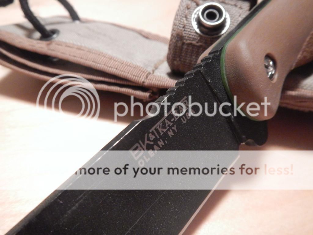

I put a firesteel notch on my 16 on the spine just ahead of the jimping. Used a 3/8" chainsaw file I believe. Not the best job I've done but worked great for me this summer. No safety concerns for me as I always try to keep the knife stationary and move the firesteel. I prefer the spine because you have more metal there to work with; probably just a mental thing but I like having more metal underneath when cutting/filing into a blade. I'll grab some pics later on tonight.
For the spine, just square it up and be done with it. Like bigghoss said, this method also works a lot like a card scraper (woodworking tool) for making tinder. No real need for a notch. I opened up the choil on my 9, 'cause it seemed like a good spot, I wanted to see if it would work and I don't plan on using that knife for a lot of fine work (still can anyway); it functions fine, throws plenty of sparks. I also was using a slightly smaller firesteel, so I didn't remove a lot of steel from the knife. I have yet to see if the new Gobspark will fit/work. For comparison, I've got one of those LightMyFire Moras with the removable firesteel nested in the handle, and that short little rod and the thin SS blade throws a ton of sparks.
Here's a pic of mine; like I said not my best work. I tried going too fast and the file ended up rounding the front of the notch. Still works great though, throws gobs of sparks with my firesteel.

Aikiguy, Thx for the pic. That is exactly what I was thinking if I go with the spine. Just ahead of jimping (or non-jimped thumb area). I am leaning towards that location now. Not sure what you meant about it being messy. Looks fine to me.

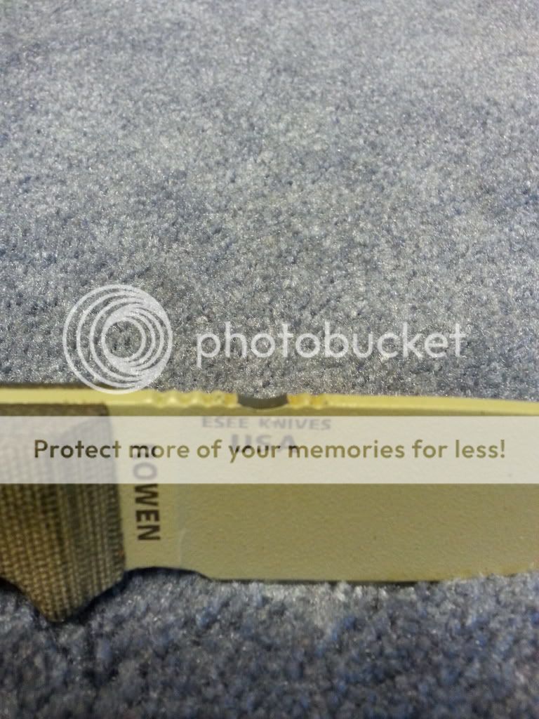

I agree with most of what has been said. I use my strikers whenever possible. But I am in the process of making sure all of my spines can throw sparks too. I started with my ESEE 3 and filed a notch right in the middle of the jimping. It throws a huge shower of sparks from even the cheap firesteels and doesnt make a difference in feel or grip when my thumb is on the jimping while I am using the knife- I also considered filing in the choil area but decided it was not a good idea---I didnt want my fingers that close to the blade if they didnt have to be. If you consider for a second that there might be a possibility of having to use a firesteel and your knife to make a fire to stay alive, than you will agree that it may not be the best idea to have it on the choil. You will be very cold and most likely shaking and having to put your hand near your blade is not a good idea. JMHO---heres a shot of my 3--sorry I havent done it to my Beckers yet so no pics-----
Thx OutdoorsFamilyMan4. Nice looking Esee and great points about the safety concerns. Def leaning towards using the spine.
